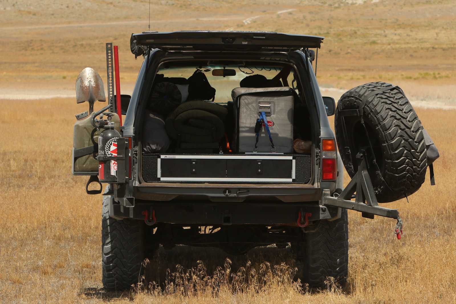

Not sure how I missed this thread but nice work on the build so far! Coming along great. I love the Goose-Gear platform. I still need my second row so I just have the dual rear drawers in my 80. But eventually I'd love to add the rest of the platform when I don't need the middle row anymore. Anyway, had to respond so I can follow the rest.
IMG_3972 by Adam Tolman, on Flickr
You have a sweet setup yourself!
