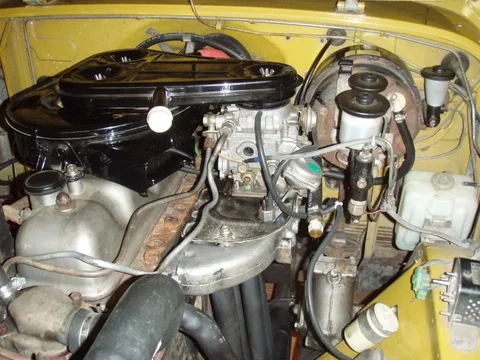

Weird Results
I re-cleared the carb components this morning after the dip with spray and compressed air, everything was clear. I reassembled with the only change being to the secondary jet, went with 180 vs 220. I know it will have nothing to do with idle but was burning a lot of fuel and response was heavy before this latest round.
Called Davegonz and while waiting for a call back I finished putting it all back together. Was almost complete when he called so I decided to just finish and see if I could drive it over for the carb swap.
Fired her up with familiar results; vacuum all over the map with idle as long as no choke was applied.
MOMENT OF TRUTH:
1. when I went to pull my vacuum gage off the brake booster line and was expecting it to die or die trying to die, the idle actually jumped up. This was the first time I had run it with an intentional large vacuum leak, and it ran at a higher RPM albeit it was rough.
2. next I started messing with the vacuum lines to the carb. I have been applying vacuum to the PV and TP either from the manifold or the gas filter that I picked up recently. Again, while it was running, I pulled the line off the PV and again the idle improved, this time it was both smoother and higher. Next I put my thumb over the PV port and it idled up a little more so I capped it and simply ran a single line from the manifold to the TP for vacuum there.
3. I adjusted the idle with everything hooked up wrong and although I cant get a perfectly smooth idle, it is 80-90% better. Next I jumped in and ran over to Davegoz's pad and it drove better than it has at anytime with this carb on. Nice strong pull through the entire power band, even smooth transition off idle.
SO I NEED HELP FROM THOSE WHO ARE A LOT SMARTER THAN ME; WHY WOULD PERFORMANCE IMPROVE WITH THE PV BLOCKED? I know this is not supposed to be the correct way to hook up the carb? Here is what I think I remember being in her::wrench:
The power valve is open when there is no or low vacuum on its actuator line. This addes extra fuel essentially providing a larger jet size. This points to a lack of idle fuel or lean mixture as the culptit, as opening the PV make it run better.

I can say the carb has not been blessed by Jim C, no vacuum at the PV. I have changed the main jets to 150 & 220. The original slow jet that is a 65 was clogged so it's in the carb dip to see if I can unclog it.
Houston, we have idle! Cleaning up the old 65 primary slow jet and combined with manifold vacuum to the PV and TP allowed me to set an idle and adjust mixture screw. Driving it was smooth albeit with less pull across the power band as yesterday's bastardization. I'm going to continue to experiment with the main jets as it seems pretty rich right now, may retry the 144 - 180 main combo to see what happens.
Thanks to the guys who hung in with me through all this and kept the expertise coming; it's been one heck of an exercise and I'm learning a whole lot about my truck.
