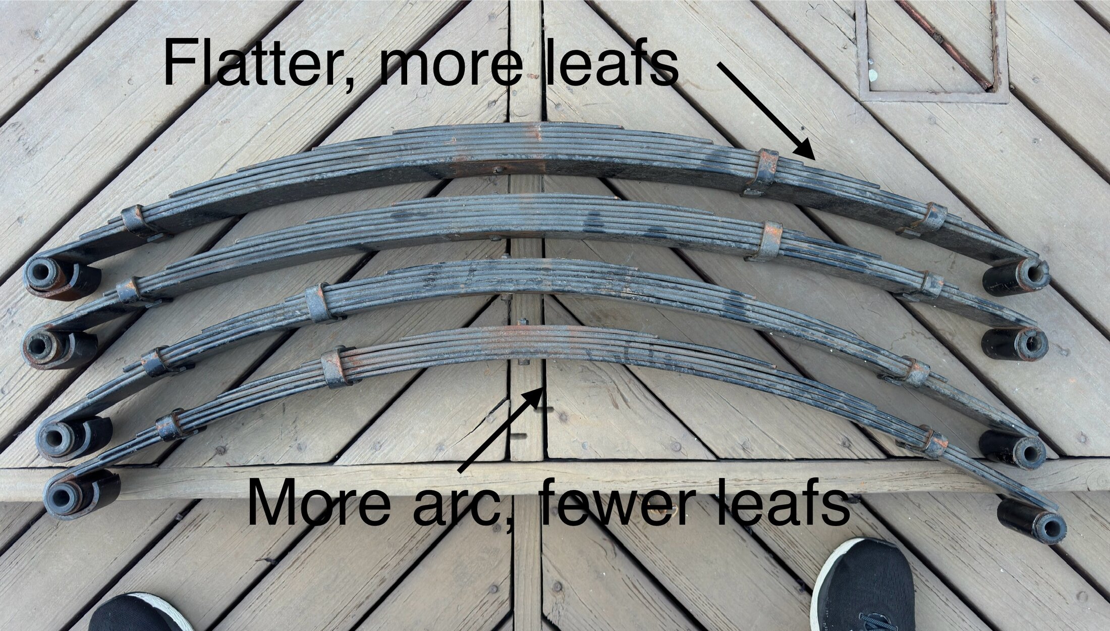

Stupid question though, as I dug them out of the shed... Two are flatter than the other two. Which are the front and which are the back?

These are the old set. Which are front and back? The flatter springs have 7 leafs, and the more arched springs have 6 leafs.

Factory leaf pack on a 55 was 7 in front, 8 in the back
Seven leaves up front, six in the back. I'm not sure that those springs are warranted, based on the tire size, or desire for a smoother ride.

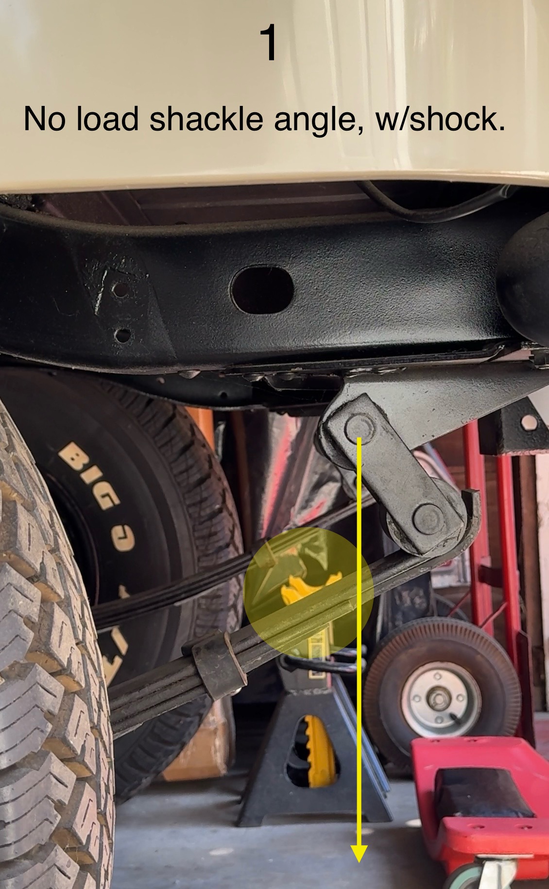

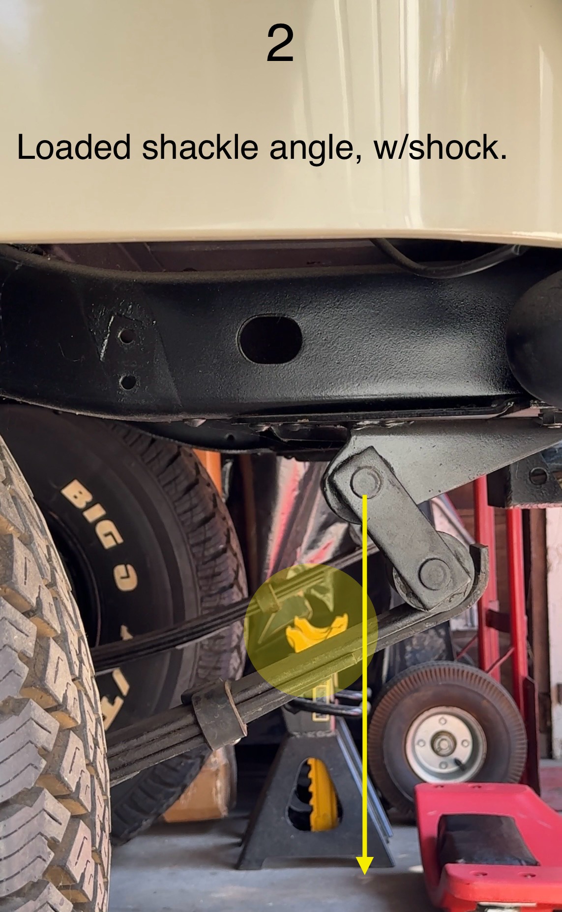

Worked on these SOR springs today and did a test. The photos are still frames taken from video at max compression of the spring with me (230lbs) bouncing on the rear bumper. The arrow and the highlighted jack stand head is an attempt to show the flexion.
The shackle bolts are just snug enough to flatten the lock washers.

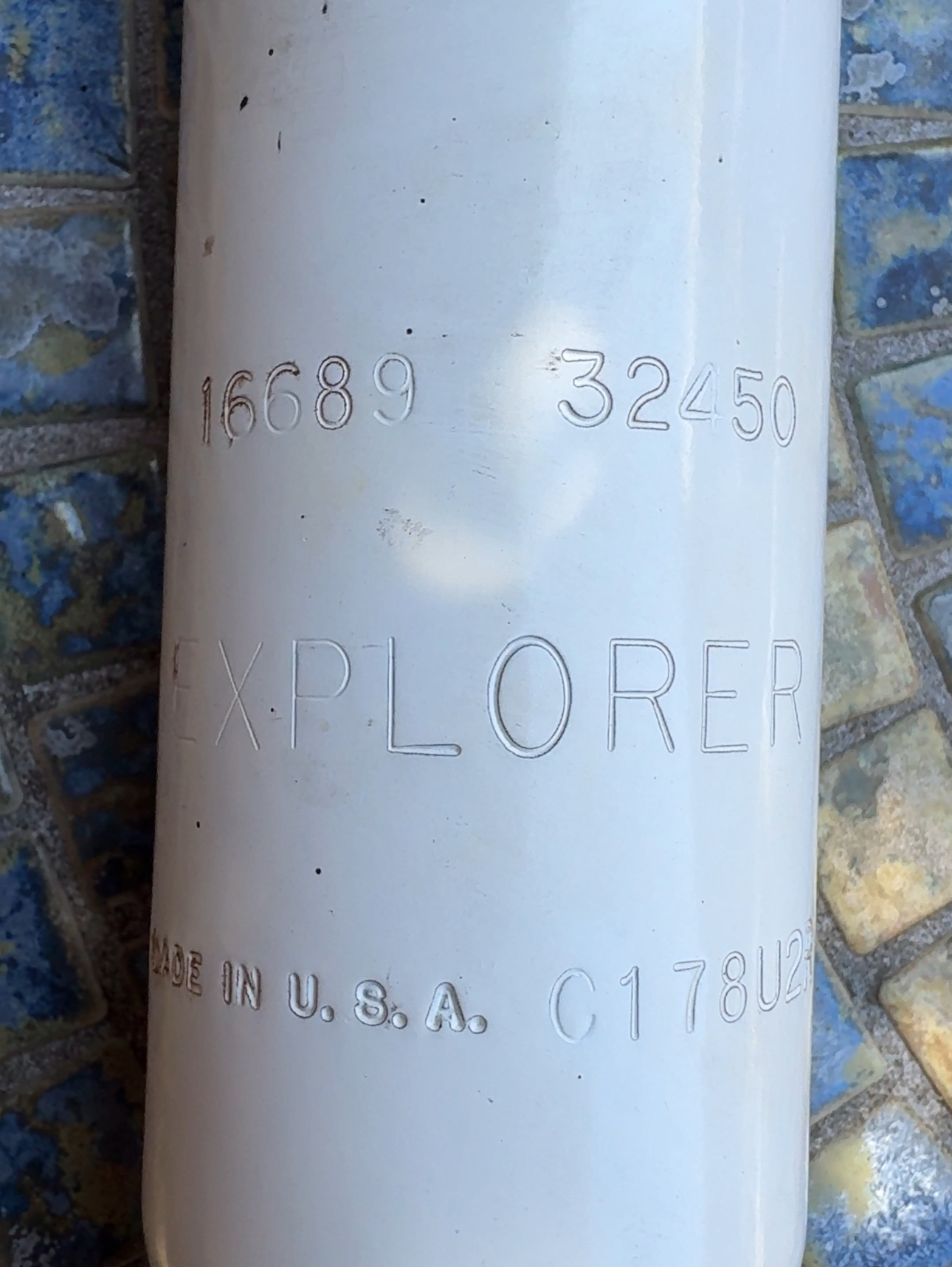

The shocks are SOR ProComp Explorer’s from 1998 when I installed both the shocks and springs.
The kit was a 4” lift I believe, with 2”s coming from springs and 2”s from extended shackles that I did not install because I stayed with 33x9.5s. There is only 200 miles on the rig since installation. I did use ramps on opposing corner wheels overnight and wd40 between leafs best as I could.
How does the shackle angle look at maximum flexion, and is that good compression for 230lbs bouncing on the rear bumper?
I took video which really illustrates better, but I couldn’t figure out how to upload the short clips.

Nothing wrong with those angles, vids need to go to YouTube and then you can paste a link.
