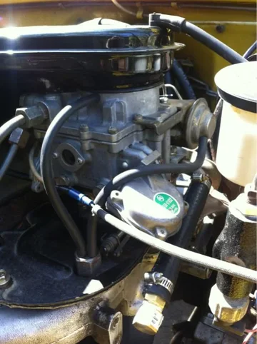

Can you post some new pictures of where you're at currently? Gas filter connections, carb insulator base connections, EGR blocked off, etc.?
Here is the current setup from a wide angle, sorry for the cell phone picks.
Vacuum to the power valve and the TP are coming from the gas filter.
I had tried getting both from the manifold below the carb but it's capped now. I just switched this this morning after looking at a Jim C diagram. It may have been better the way I had it before.
I don't have an EGR
Sent from my iPhone using IH8MUD

Are you sure that the vacuum connections for the PV and TP is correct? They need manifond vacuum and I think that where you have them now is some kind of switch and not manifold vacuum. Even if this is not the proper vacuum, I doubt it is the cause of your problems.
Yep that was after originally having both the PV and TP teed off the manifold port in the 3rd pic. Bottom line, I was looking for a silver bullet that was anything other than taking it all apart again. But after a few shots of good ole Berrymans carb cleaner I came to realize that I still have not solved the problem at the head.
Going to take it down and clean it up then get some more eyes on the surface of the head. I don't want to but may need to pull the head to machine the manifold mounting surface. I few years ago I lost the HG and had a local Toyota shop do the work, including the full head job since it was off and was told that the head was in great shape. Just wondering if the manifold surface is not perfectly flat although it seemed to be when i put a 2' level on it before this last reconstruction.:mad:
