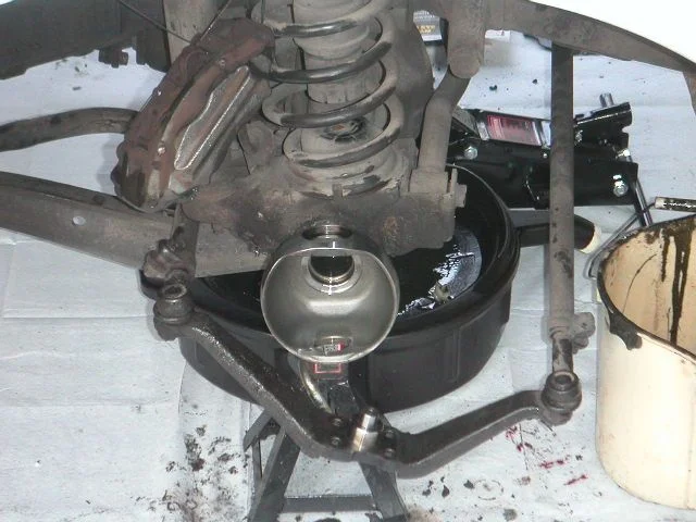

One thing I did to help control the mess was use one of the large tin foil containers like you cook a turkey in to catch all the grease and junk under the knuckles.
That is a great idea! I have an extra one from last Thanksgiving.

Another way to help contain the mess is to put a big piece of cardboard under the area you are working on.

Anyone know a good way to clean off the old moly grease stuck to the inside of the axle housing?
A little confusing....are you talking about inboard or outboard of the axle seal? Brake cleaner and paper towels for the cavity...
