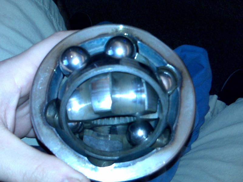

My basic description without pics would be something like this. This is how I did it this weekend (I'll skip the head scratching and blank stares that occurred while I was trying to figure out the orientations). If Woody posts a bunch of pictures I'll try and incorporate them into this explanation.
Clamp the empty birf (tulip) in a soft jawed vise. Take a look at the cage and notice that it has a flat edge and a tapered edge. The flat edge goes to the outside of the truck (facing down into the birf in the vise). Next look at the star piece. One edge of the splined hole (where the axle engages) has a groove where the C-clip will sit when the axle is installed. This faces the outside of the truck (down into the birf in the vise). The edge on the other side of the star has splines that taper down slightly as they near the edge. This is to help guide the axle splines during reassembly.
Assemble the cage and star, keeping a close eye on the orientation of both parts, and install into them into the birf. The 6 balls can be installed one at a time by aligning the grooves in the star with the slots in the cage and the grooves in the birf, and then tipping the star and cage assembly up. The ball should drop in with no force. If you have to push it in with more than one finger, something might be amiss. Check everything again. Drop the remaining 5 balls in, and presto, you have one assembled birf! Now, take it all apart, coat everything with moly grease (leave a bunch of grease inside the birf) and put it all back together again. Practice makes perfect, right?
Next, install the axle shaft using the ziptie/hose clamp trick. Install the C-clip on the axle shaft. It will be loose. Use a ziptie or hose clamp on top of the C-clip to compress the clip. Align the greased axle splines with the greased splines in the star and press the axle into the star. As the ziptie/hose clamp reaches the star, it will keep the C-clip compressed until it slides into the star. Push the axle in the rest of the way, remove the ziptie/hose clamp and check that the axle will not come out of the birf. Congratulations, you now have one assembled inner axle assembly!

Here is the first batch of photos (in no particular order).
Last group of photos. Whoever wants to use them for FAQs feel free. I need to get back to the reassembly!
