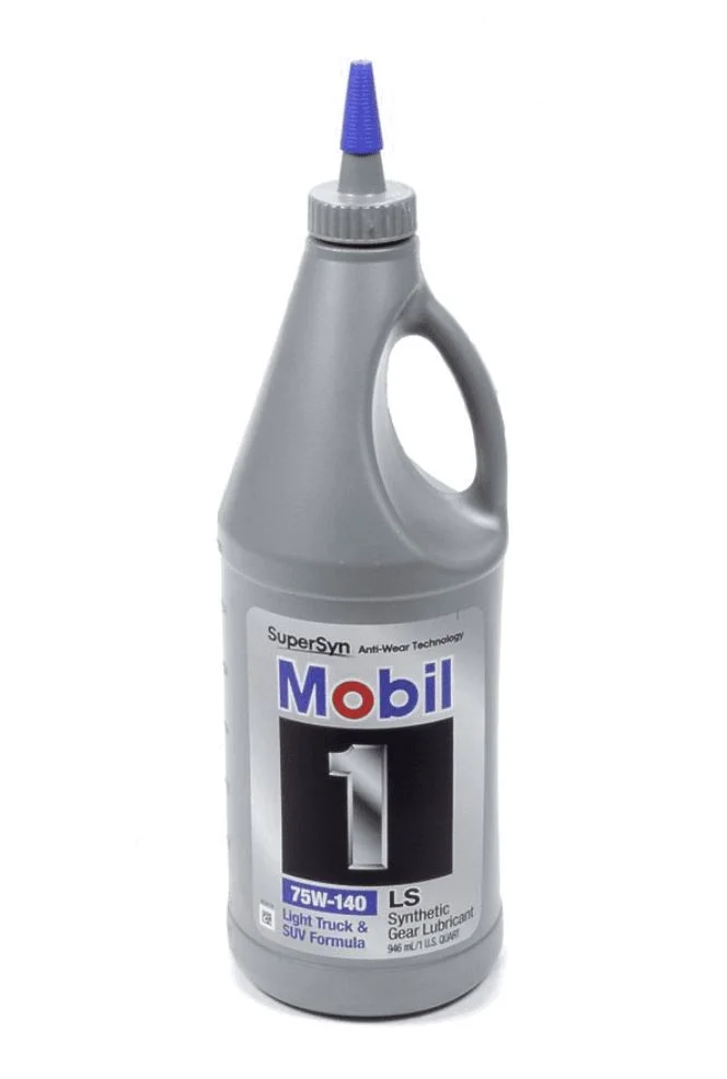

So, looking for data on the following
  1. Is the LS part harmful to the seals?
  2. Is there any data to really support in this application one brand over the other? I am guessing they are all good with small variations in the makeup
This is the one I wanted to get before I read about the friction reducers as part of the LS only because it's what I have used for years and never had an issue

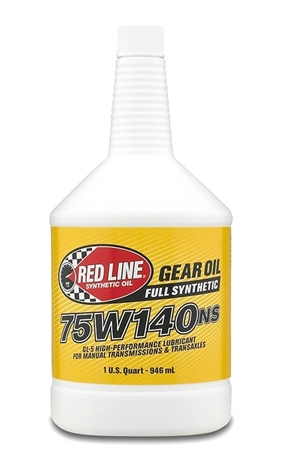

Then there is Red line

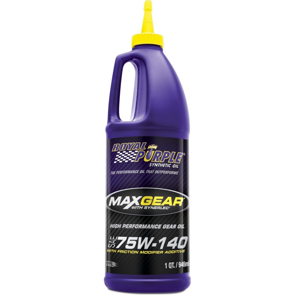

Royal Purple

Seals are either Viton or Nitrile. I did not find any documentation on LSD additives in regards to what they are, but I imagine seals would hold up fine.
The Mobil LS gear oil you listed has this in their webpage:
Compatible with typical automotive seals and gaskets
  • Helps to minimize leakage and reduce contamination

I did find lots of mentions of Friction modifiers are bad for ARB o rings. One was a post from an offroad site who called and they said LS is probably OK just stay away from high contributions of Friction modifiers
So looking into is more of the quality gear oils it looks like Red Line is the only one that has a 74wt140 with no modifiers. You have to buy the 75wt140NS NS for non slip) version
I used Red Line in my 80 years ago and I can't remember why

Whether the friction modifiers actually hurt the o-rings is probably a subject of debate. I believe we can agree that the ARB does not require Friction Modifiers.
