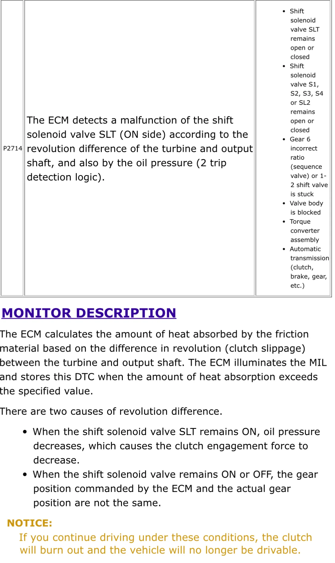

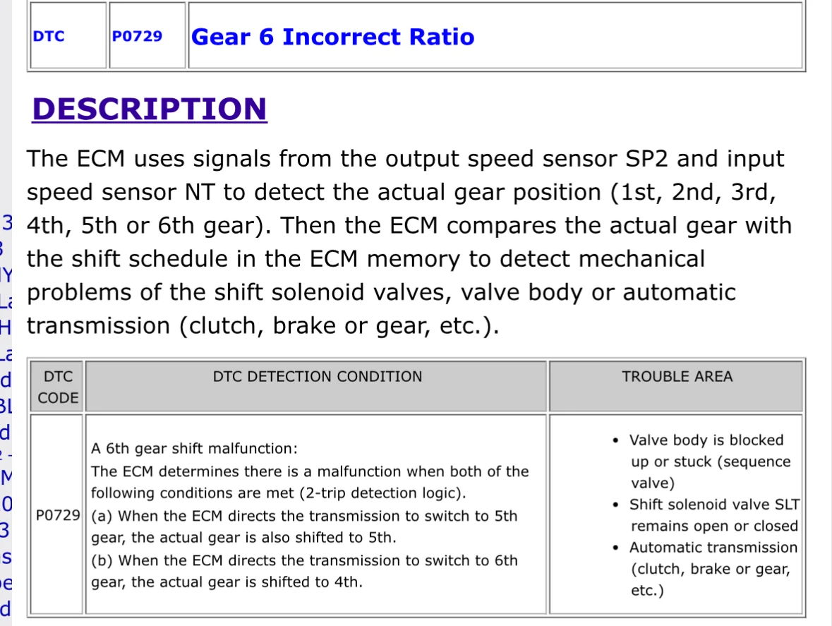

Figured I might as well include these. P0729 with another DTC indicates a solenoid. It doesn’t note my lack of engine braking but since gears 2 and 6 share a planetary gear and the B2 brake (clutch) handles 2nd gear braking and 6th gear engagement it seems likely they’re the same solenoid.
Now the bad news is that the second code, P2714, implies “if you drive it like this for 350 miles from Silverton to Golden you probably should expect what is possibly a solenoid problem to burn out your transmission clutches due to low trans oil pressure.”
So Slee’s recommendation makes sense. Not sure I could’ve saved the transmission by having it towed anyway, nevermind the $1500 quote from the towing shop in Silverton to do so.

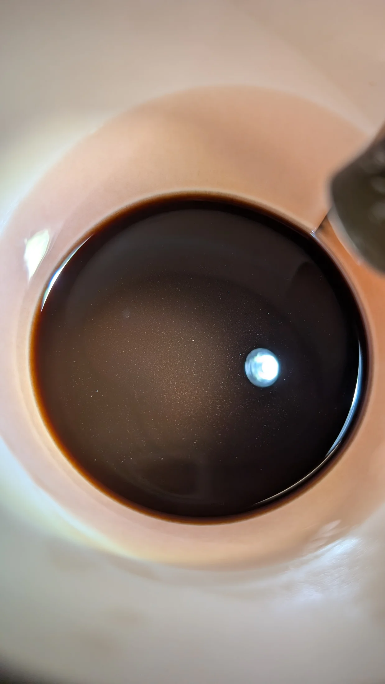

Sparkly bits.
Sparkly bits don’t belong in transmission fluid. Is the torque converter going to be ok, or is that part of the transmission replacement?
Forbidden glitter….

My gut says the root cause was a solenoid going out, and not catching that immediately meant premature clutch (and brake) wear. Slee said they weren't saying the clutches were shot, just that there's evidence of excessive wear and replacing the transmission is their recommendation. They did think that a bad solenoid would result in burnt fluid but not necessarily metal in the fluid (unless it's really worn I suppose), but again although I tried to mostly avoid 2nd and 6th gear ultimately I knowingly drove 350 miles like this...
