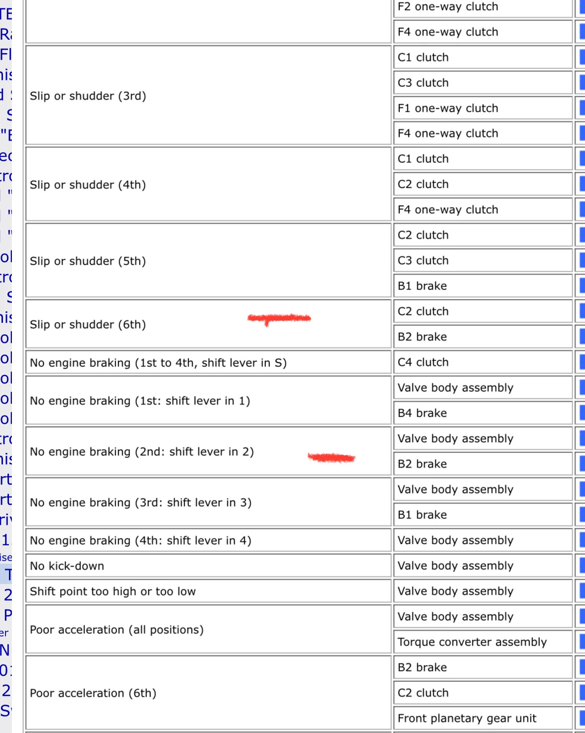

I think you nailed it with the B2 Brake issue above.
As I also wheel hard and tow at the upper end, I'm wondering how to ensure long component life and avoid failure. I'm right about the same mileage too.
Towing is towing and the only things I've done is to add a transmission aux aux cooler, while also servicing fluids on a regular interval.
I'm curious how often you're using 4lo?
I religiously use it once I hit dirt as it greatly reduces torque loads within the transmission. Only time I'm not in 4lo is when I'm on a fast 30mph+ fire road or desert wash.
Also use it religiously when towing, literally as soon as I hit the entrance gate in a campground, even if it's completely flat.
So what does the B2 Brake look like? If that's the root issue, it's a clutch pack and the friction material is worn either from loads, heat, or both. Unfortunately looks like a rebuild or replace rather than something that can be serviced.

The B2 brake is a clutch pack, but instead of controlling one spinning element compared to another, it controls engagement of a spinning element to the transmission case.

It’s interesting to me that the failure is on the 2nd gear brake. I would have assumed a clutch pack would have gone out first. Most of the heat seems to be generated during acceleration when the torque converter is unlocked, and I would have thought that’s also where the majority of the driveline stress happens. I guess 2nd gear engine braking and 6th gear engagement are the same brake so maybe it’s just a lot of 6th gear wear, but I don’t tow in 6th and the truck gets very little highway usage without towing compared to most vehicles.
