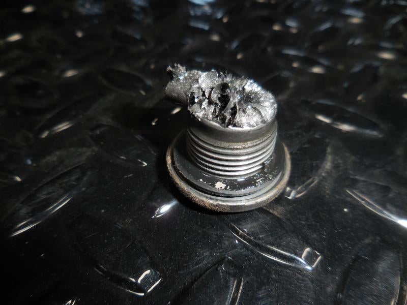

- The front and rear differential oils had magnetic drain plugs with ferrous looking "paste". When touched and rubbed between your fingers no substance or roughness to it. When I looked on the internet there are many examples out there of same behavour. Looks like the ring gears etc with metal to metal contact do create very fine run in and or continuous wear material, however normal per my search. I am interested to see at 60 to 70k miles how this evolves. I also noted slightly discolored oil, probably temperature effect, or perhaps the very very fine ferrous material distributed as I drove the vehicle to warm up the oil, probably a combination of temp & this very fine wear material.

Rear differential drain plug, already part at the top removed and rubbed between my fingers
