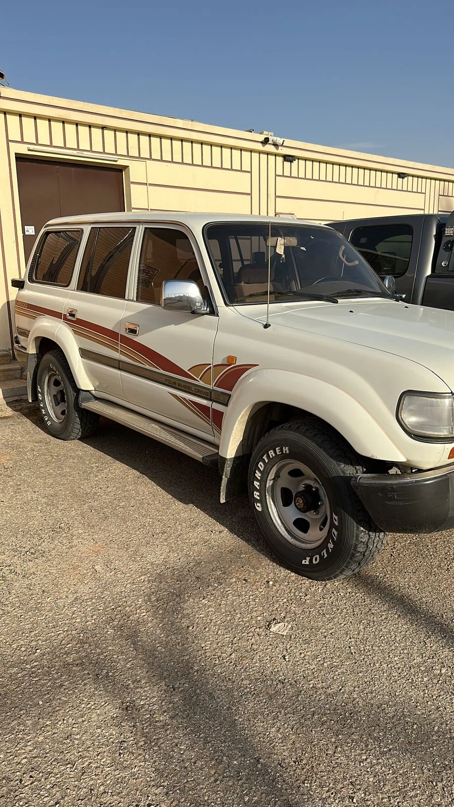

A few months ago @navydivedoc made the mistake of telling me he “might” want to purchase a Saudi 80.
Within a couple of days my friend @Meshal had found one that he had sold to a friend a few years back that he was willing to part with.
A few back and forth PMs and some What’s App messages later Steve is the proud new owner of this fantastic 80

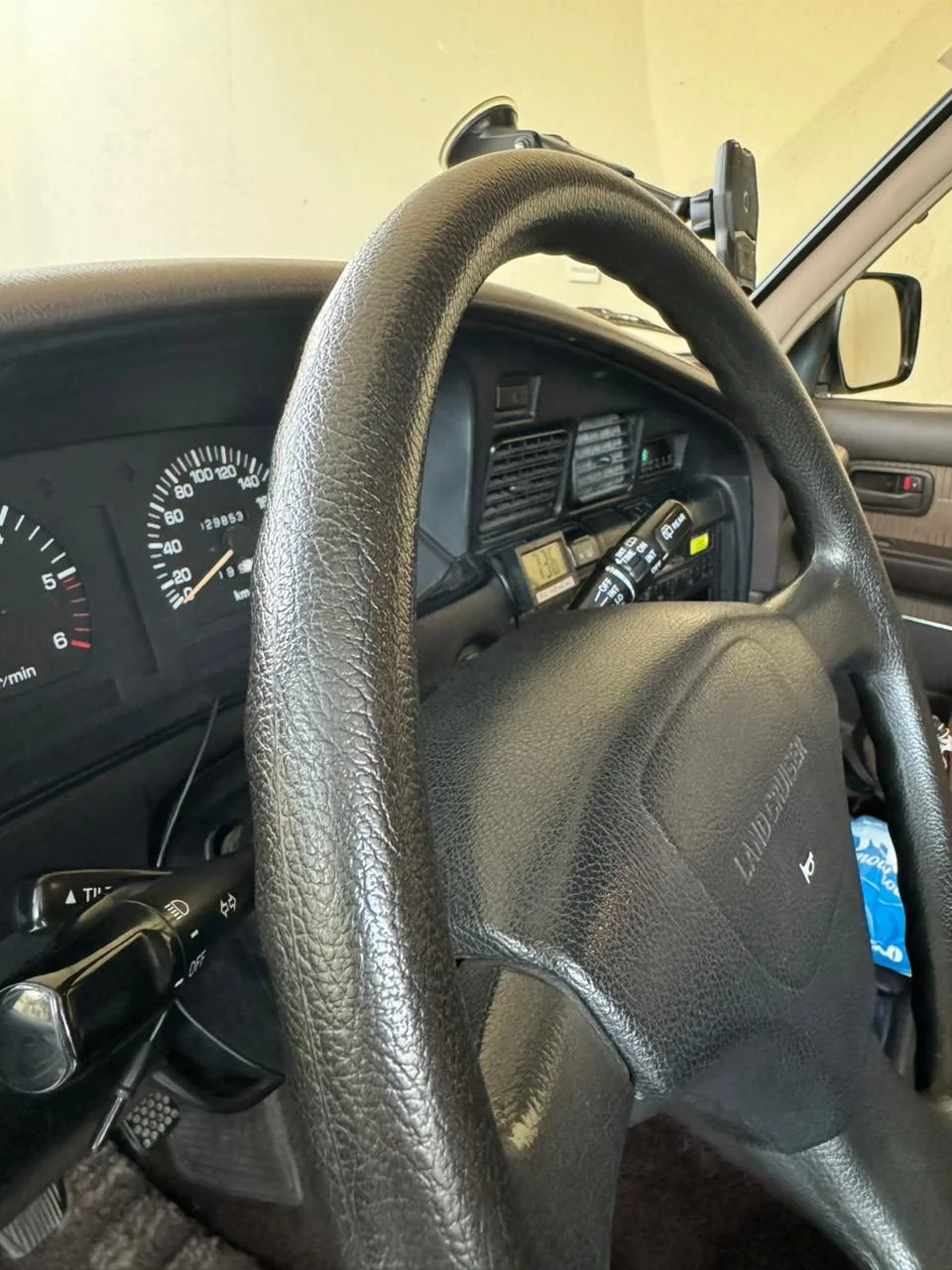

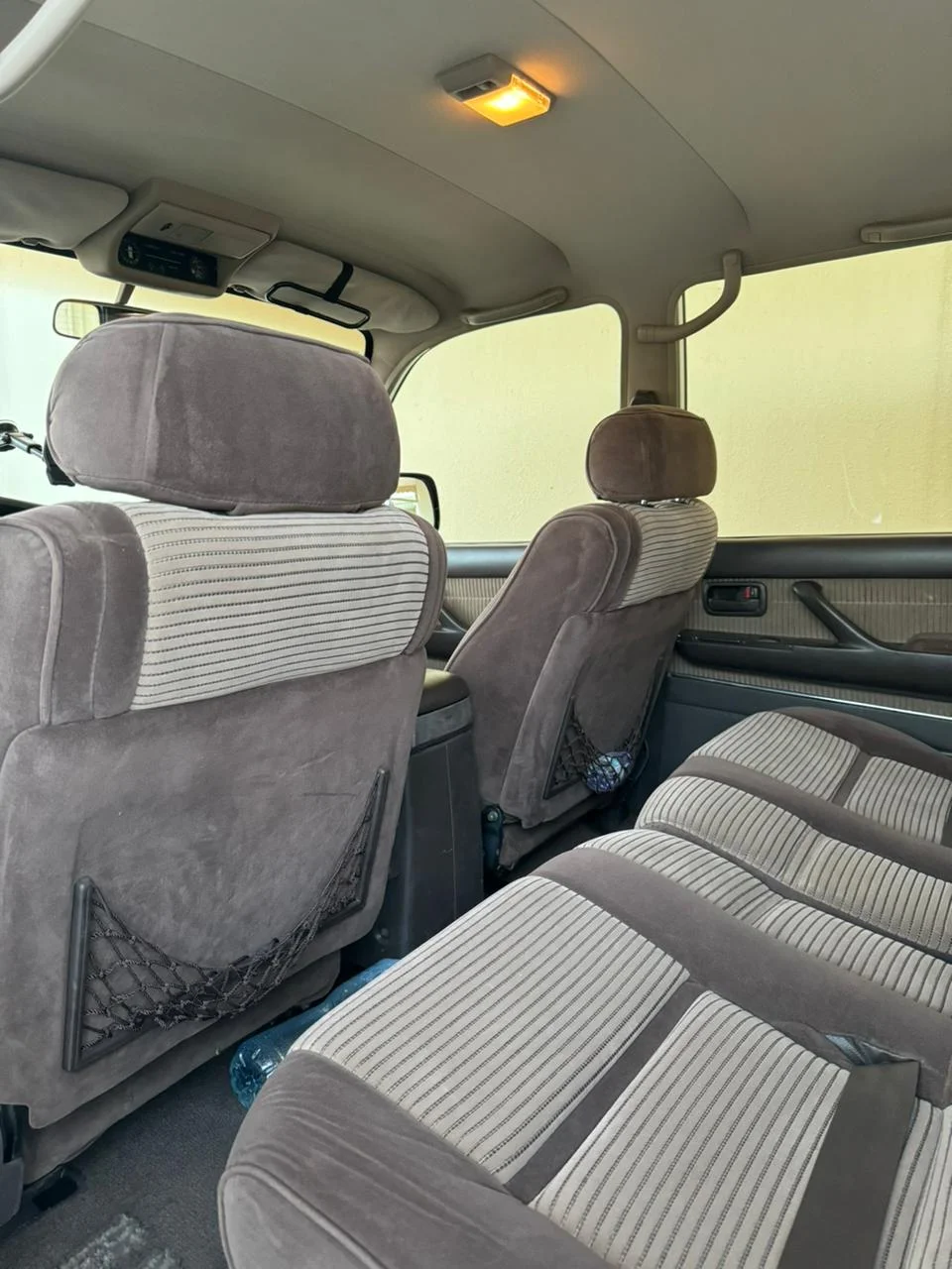

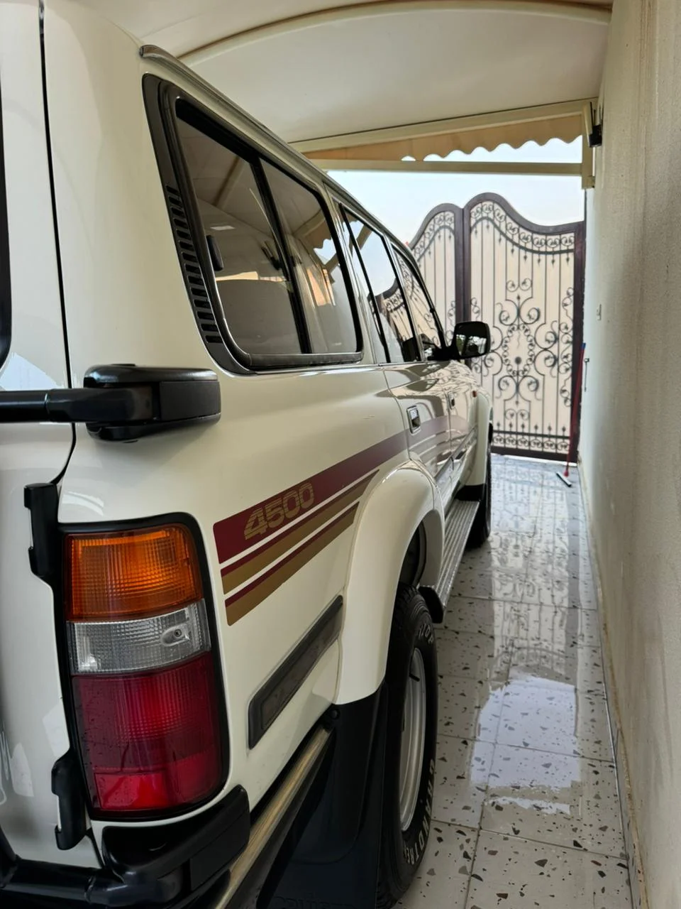

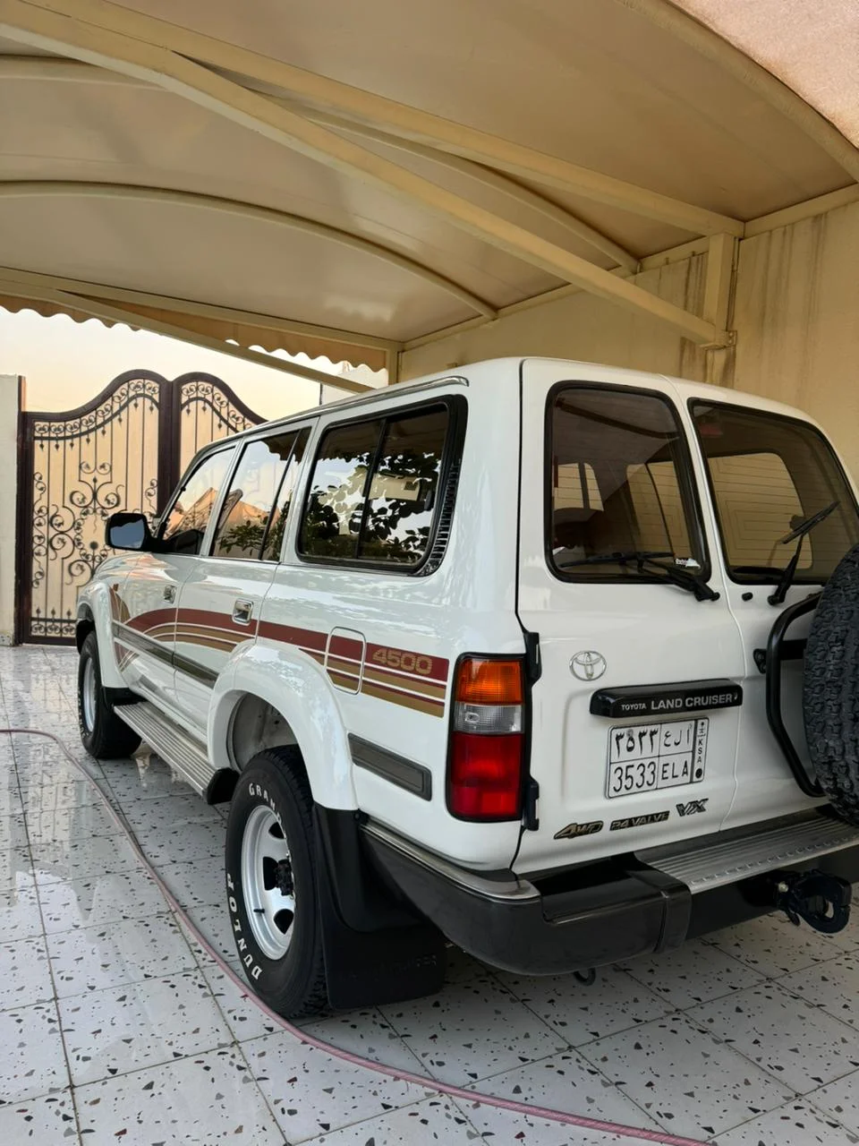

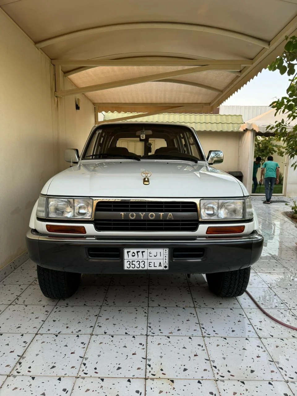

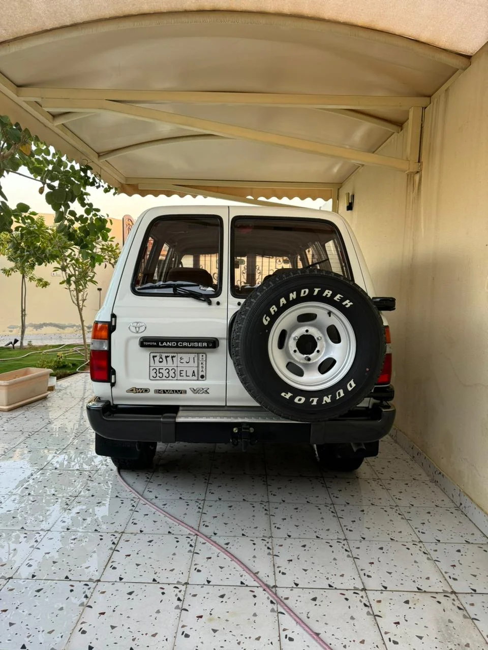

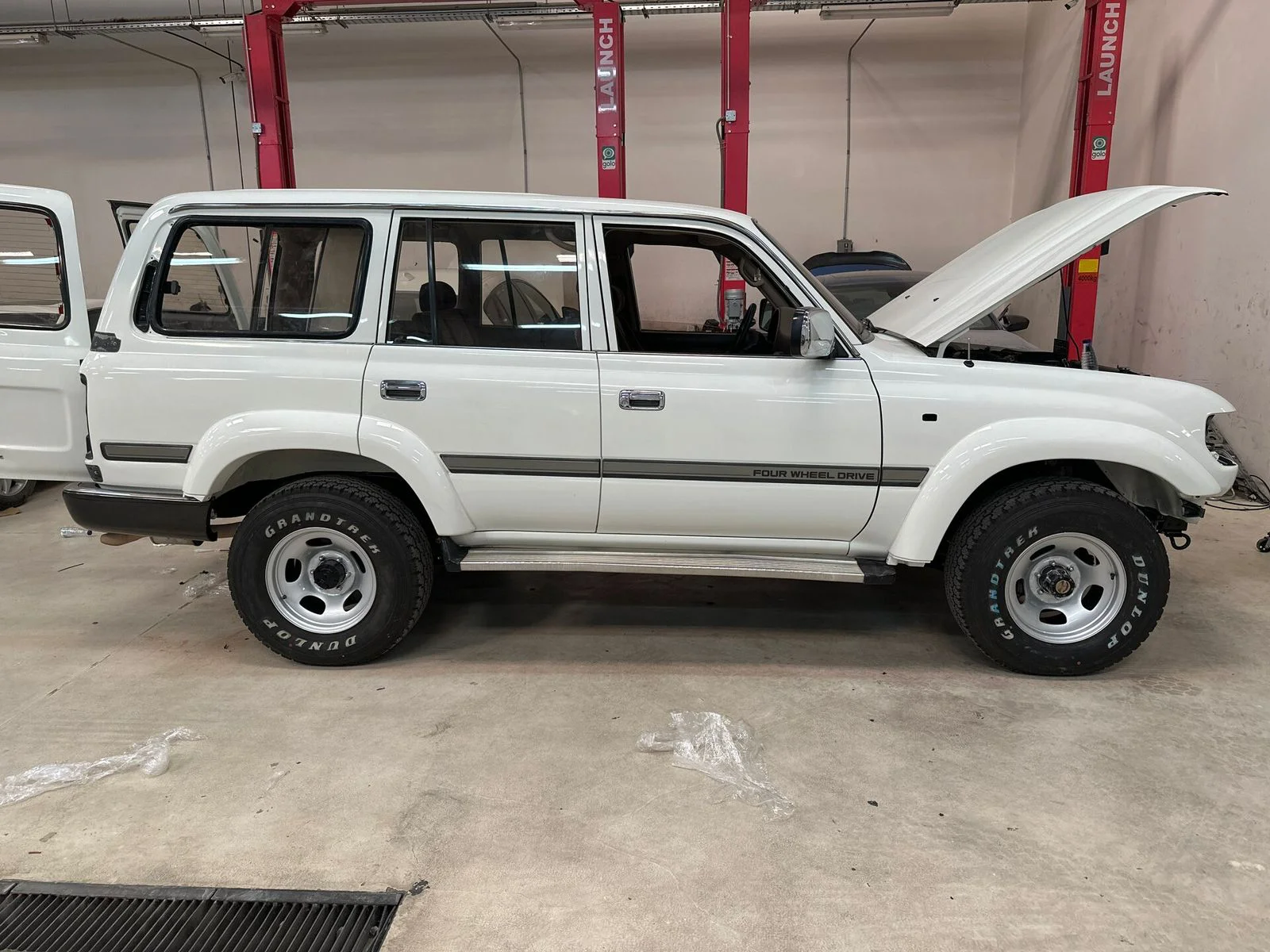

This one went through a nice baseline a couple of years ago and it has some really cool features Steve likes such as the VX package with cold box and dual AC. As with all of these GCC trucks this one has dual tanks and no sunroof.

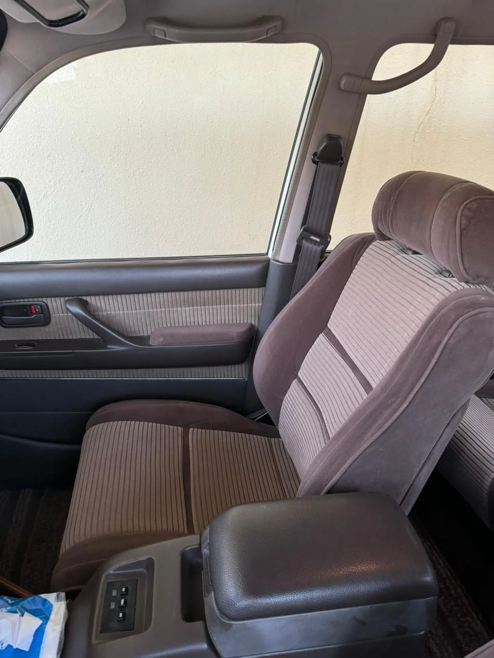

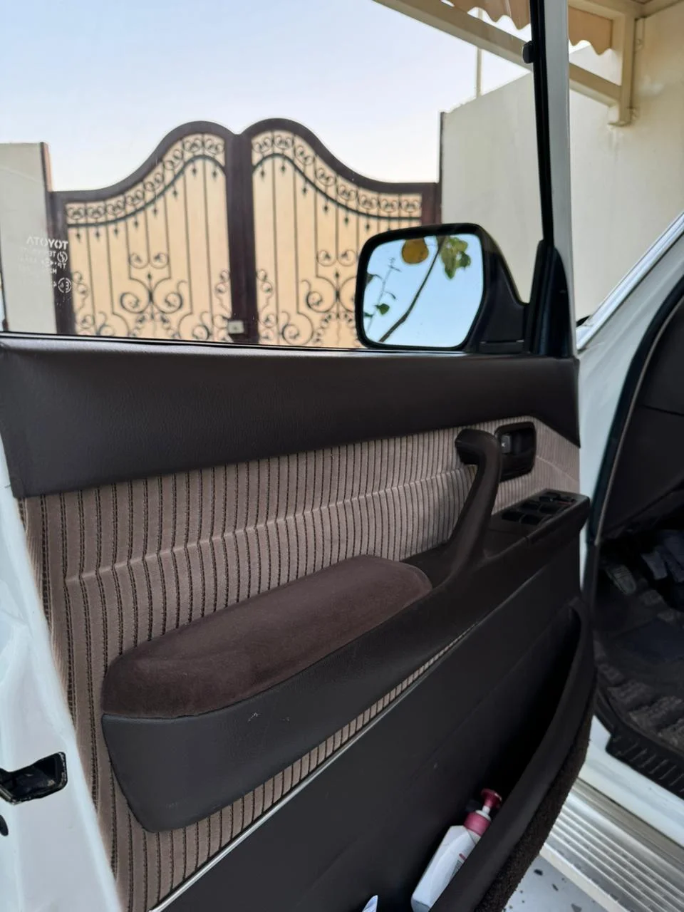

The interior is in fantastic shape.

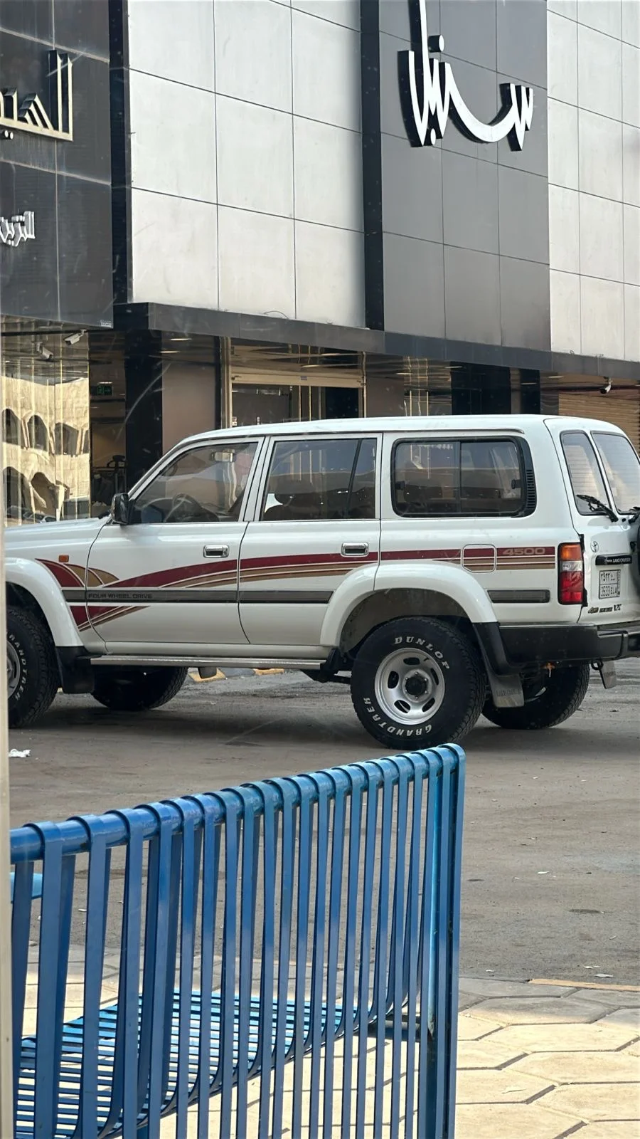

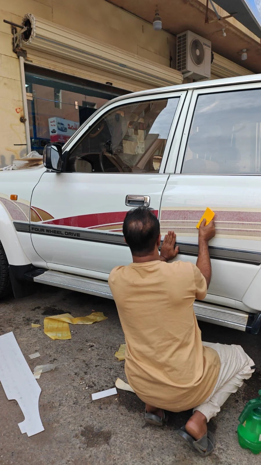

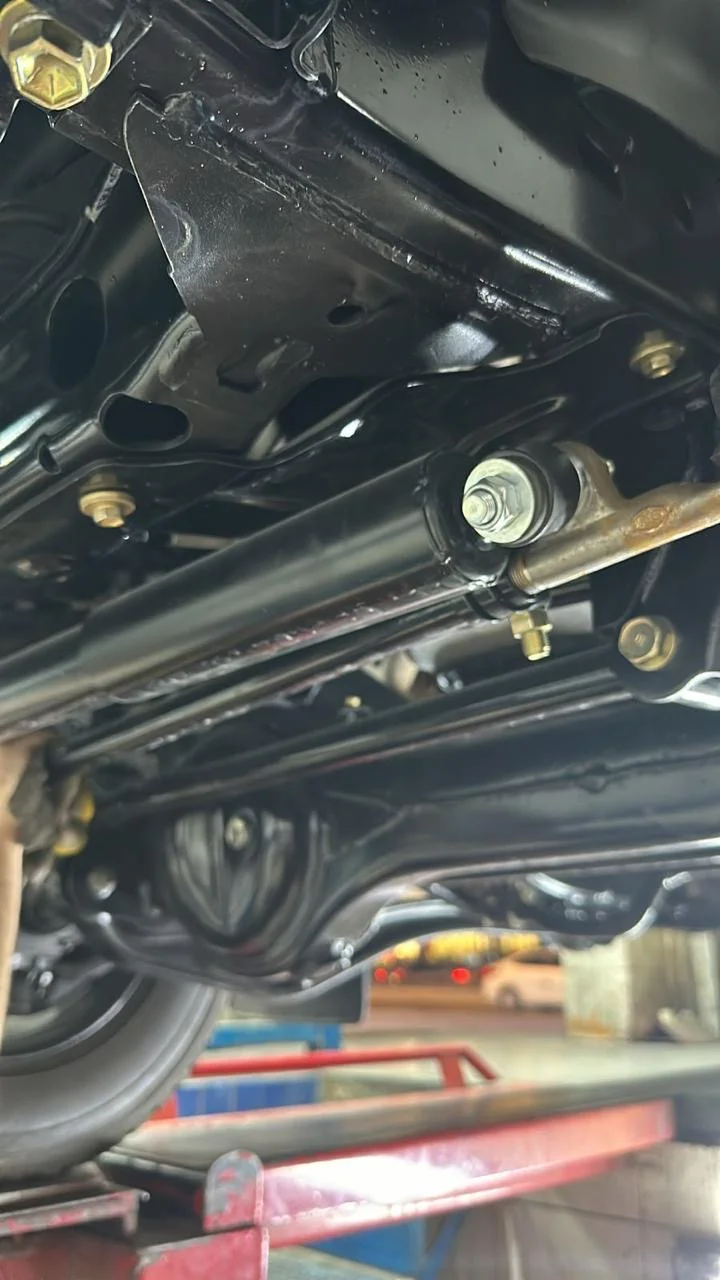

Nolen sends me most of the pics, and the videos above. I live in the land of salt and rust. I hate rust. The underside of this truck is pristine. I've never seen anything like it. The specs are right. Everyone wants a GX. Poverty pack. I'll admit it, I'm not ashamed. I like flares. This is a sort of stripper VX. Flares and a cool box, but cloth interior, no sunroof, barn doors. And 3 pedals. I like it. @Meshal Had done the underside. Bushings, hoses, it has a light dobinsons lift already. Original paint and new set of saudi stripes. Dash isnt cracked, its been kept under cover.

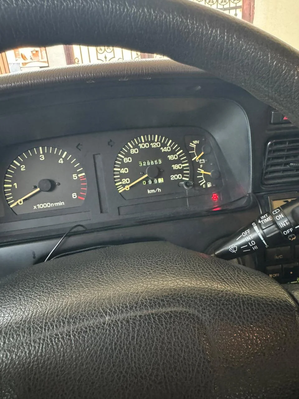

But, 320k km. Unknown maintenance history. It's clean and runs great. It had some seals done, it looked like a great driver. A great driver on the other side of the world. Houthis are bombing stuff, shipping is a mess. I start to think maybe this isn't the best idea I've ever had. I have impulse bought a fair number of trucks. So I wait a couple of days. A few back and forth with @wngrog about just what this thing needs for a baseline mechanically. @Meshal is here in the states for the 70 series get together. I wait a couple more days.

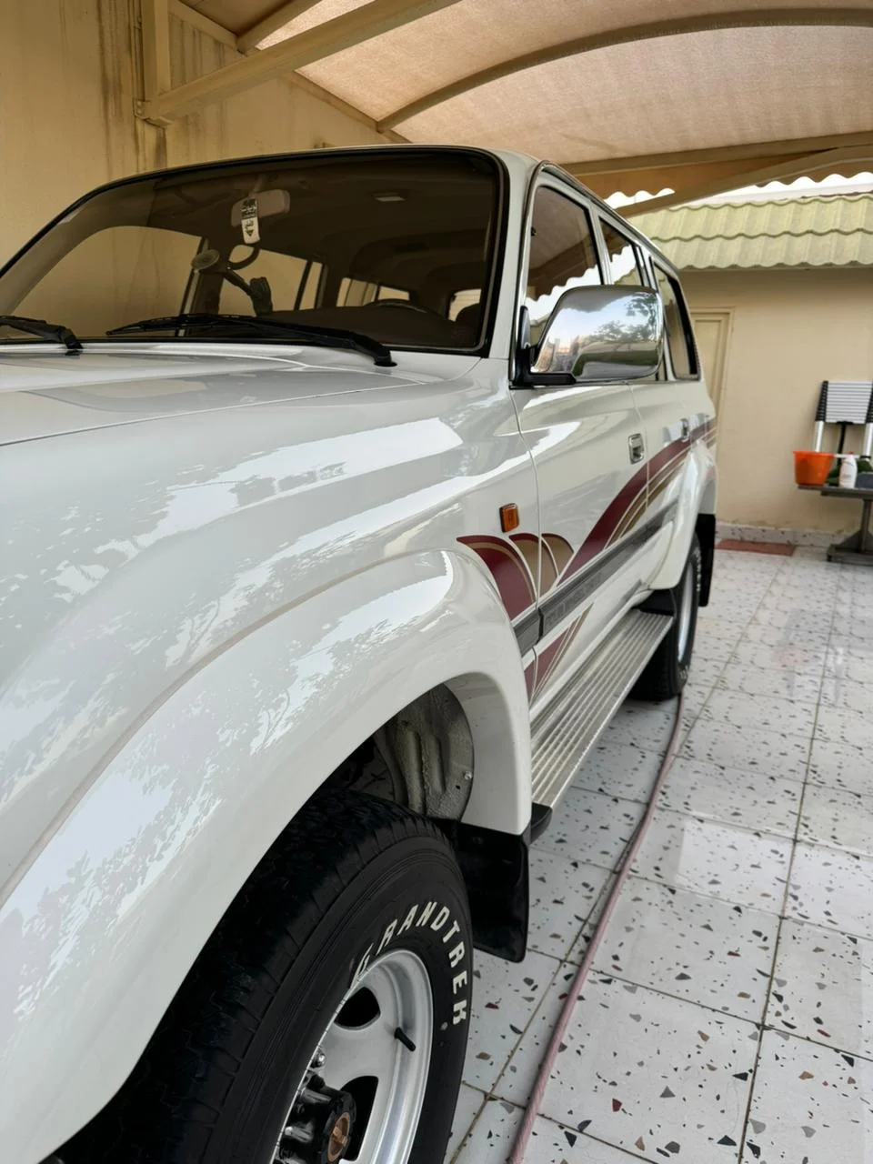

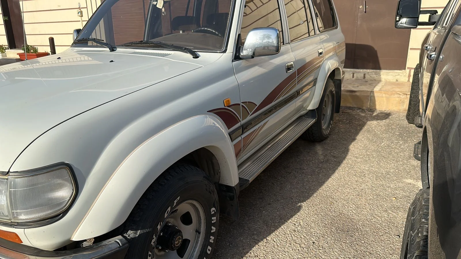

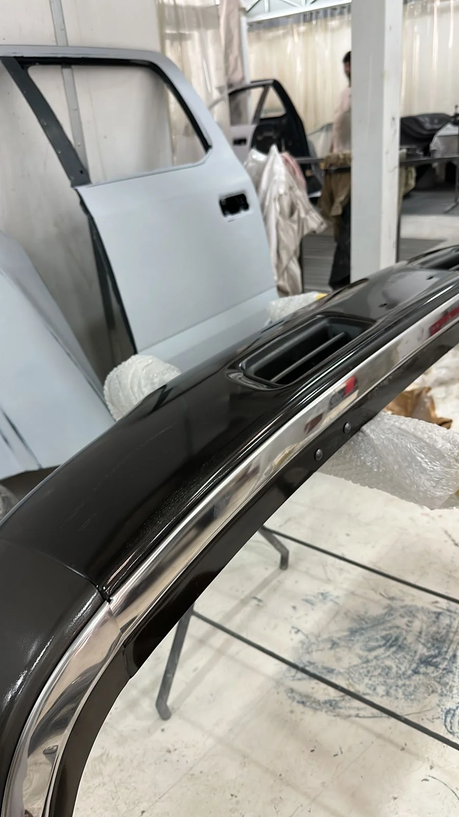

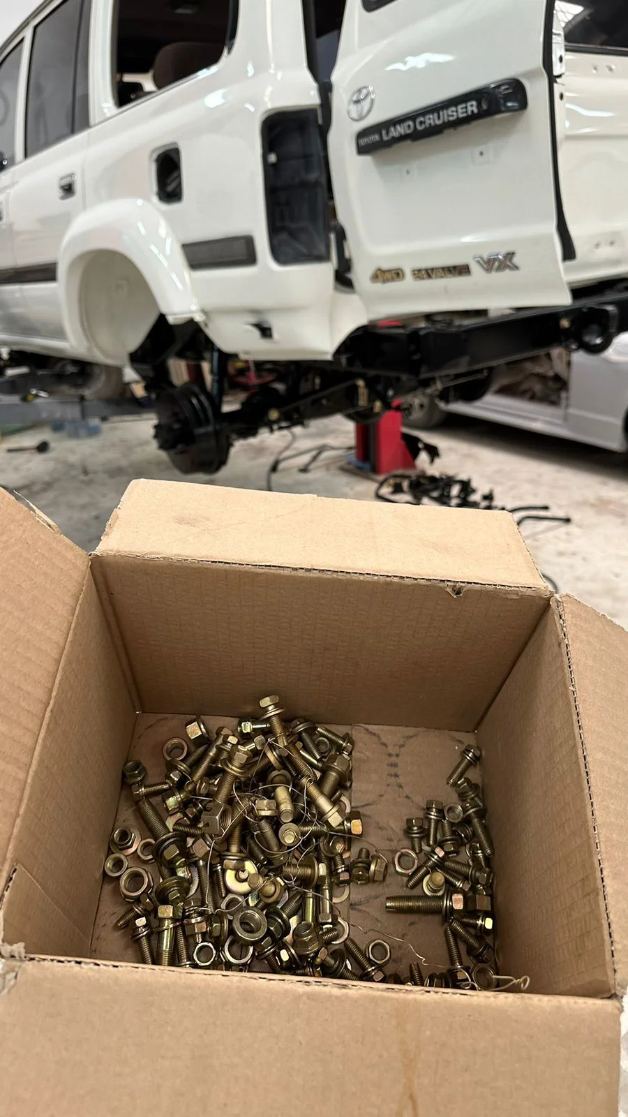

I restored this truck with little mechanical works and a lot of body work. When I got it it has light damage in the front
and in saudi we do not like to paint over metal that the great japaneses sent us so we like to put new body parts like weather strips, rubbers, plastics headlights etc, etc. So we decided to replace all the front with new parts from grill to rear bumper

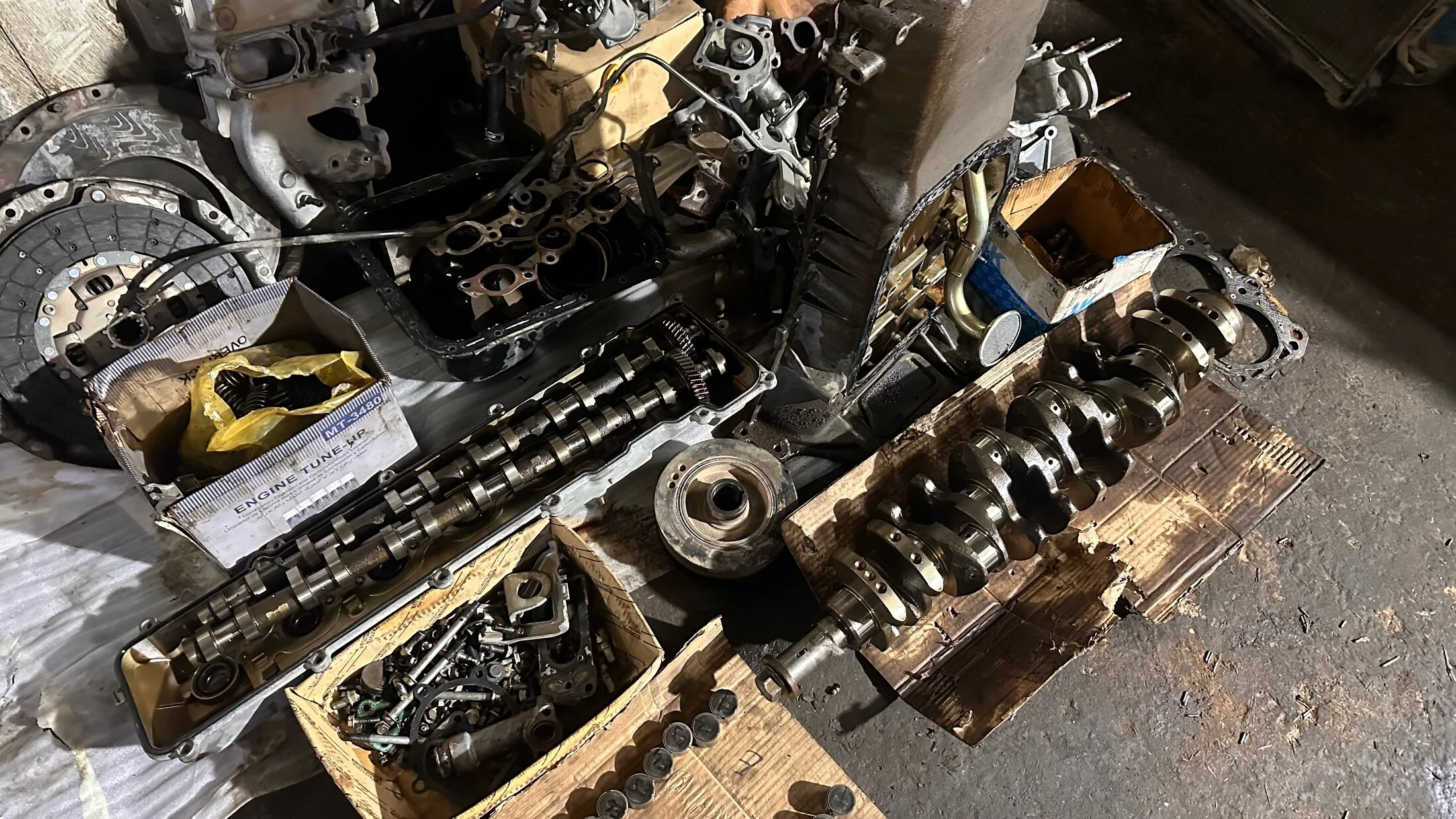

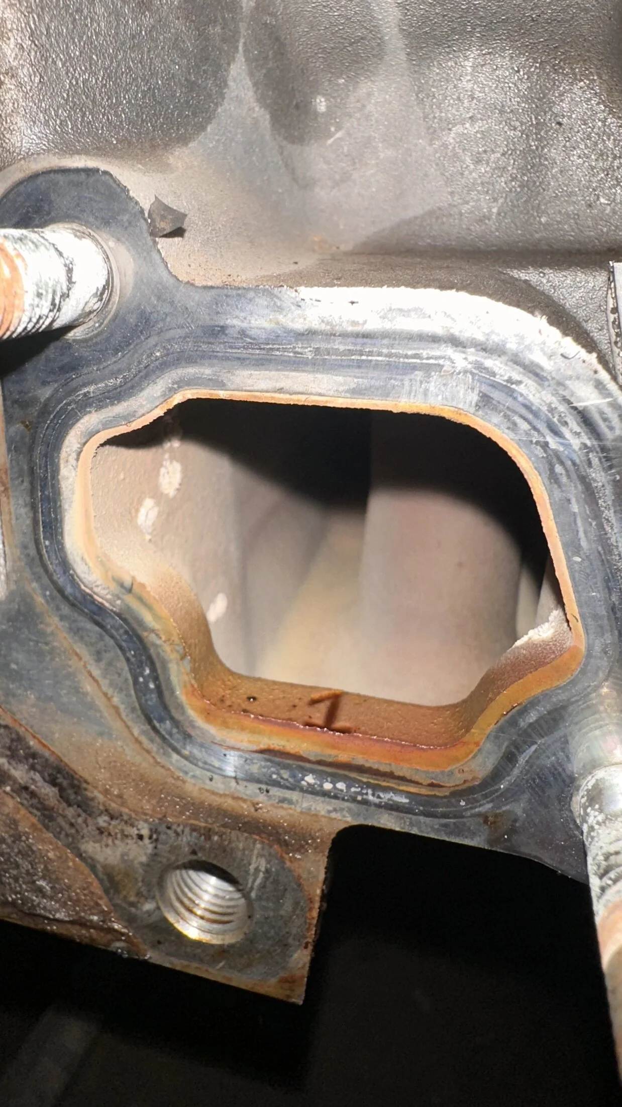

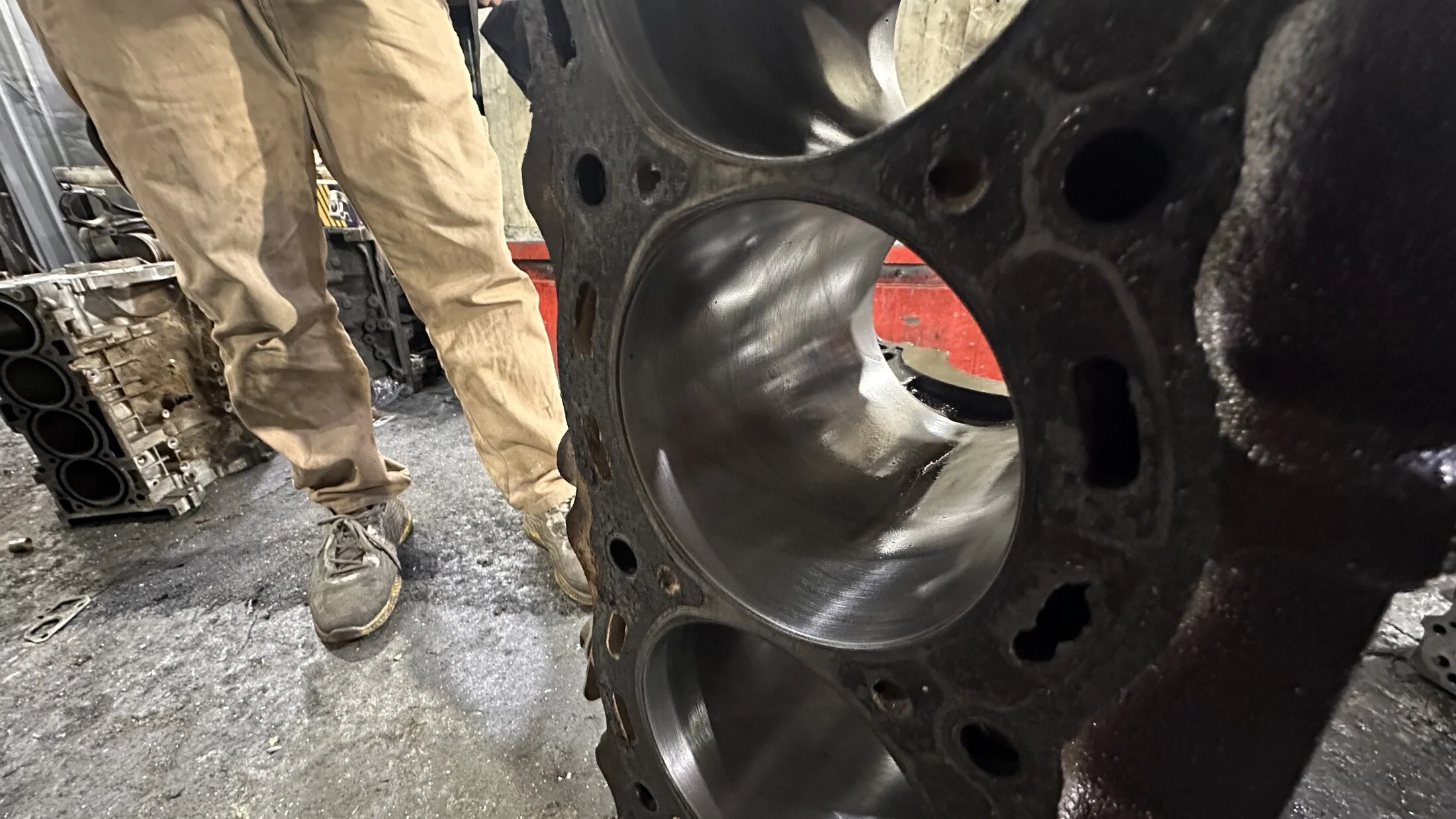

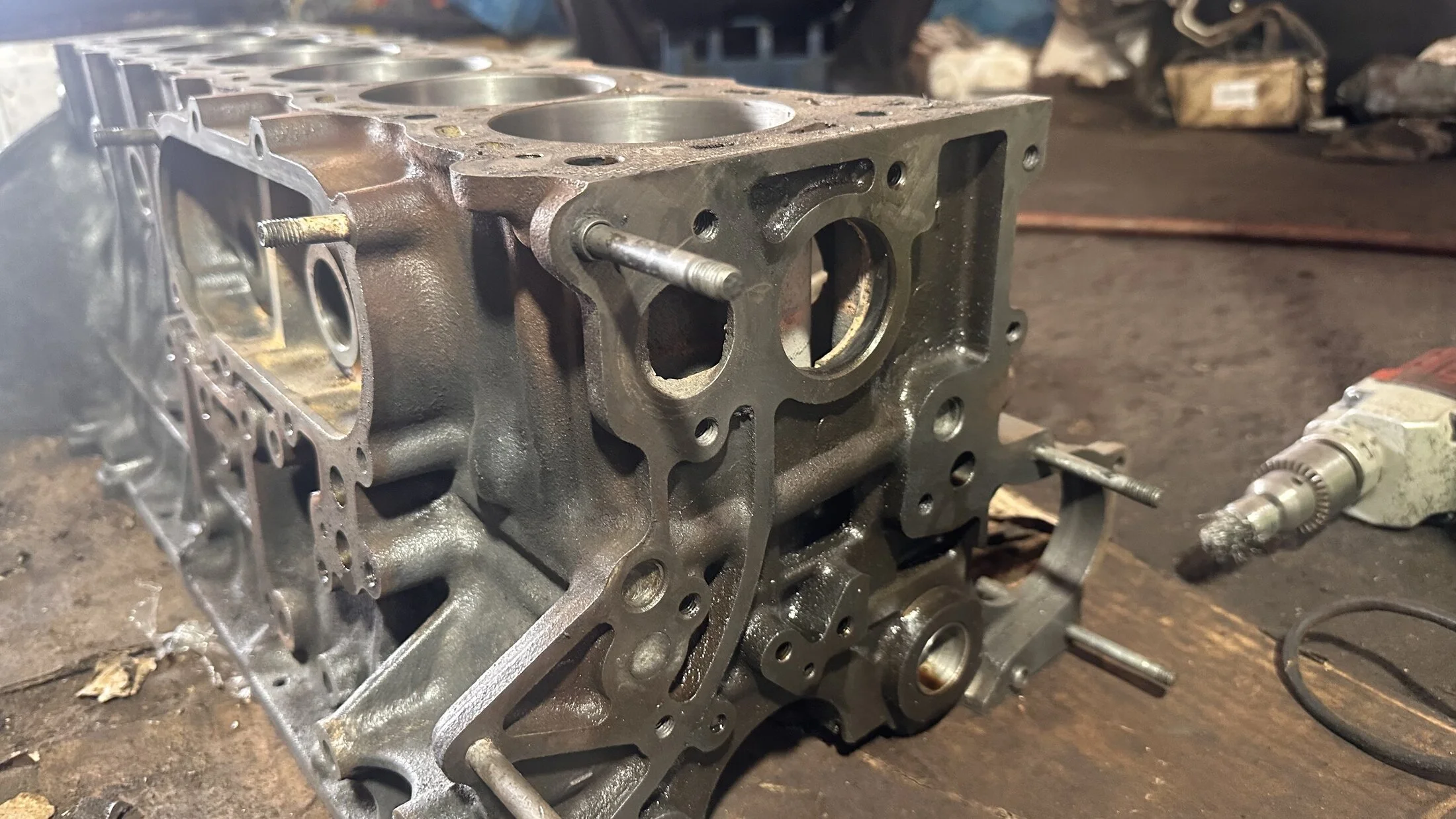

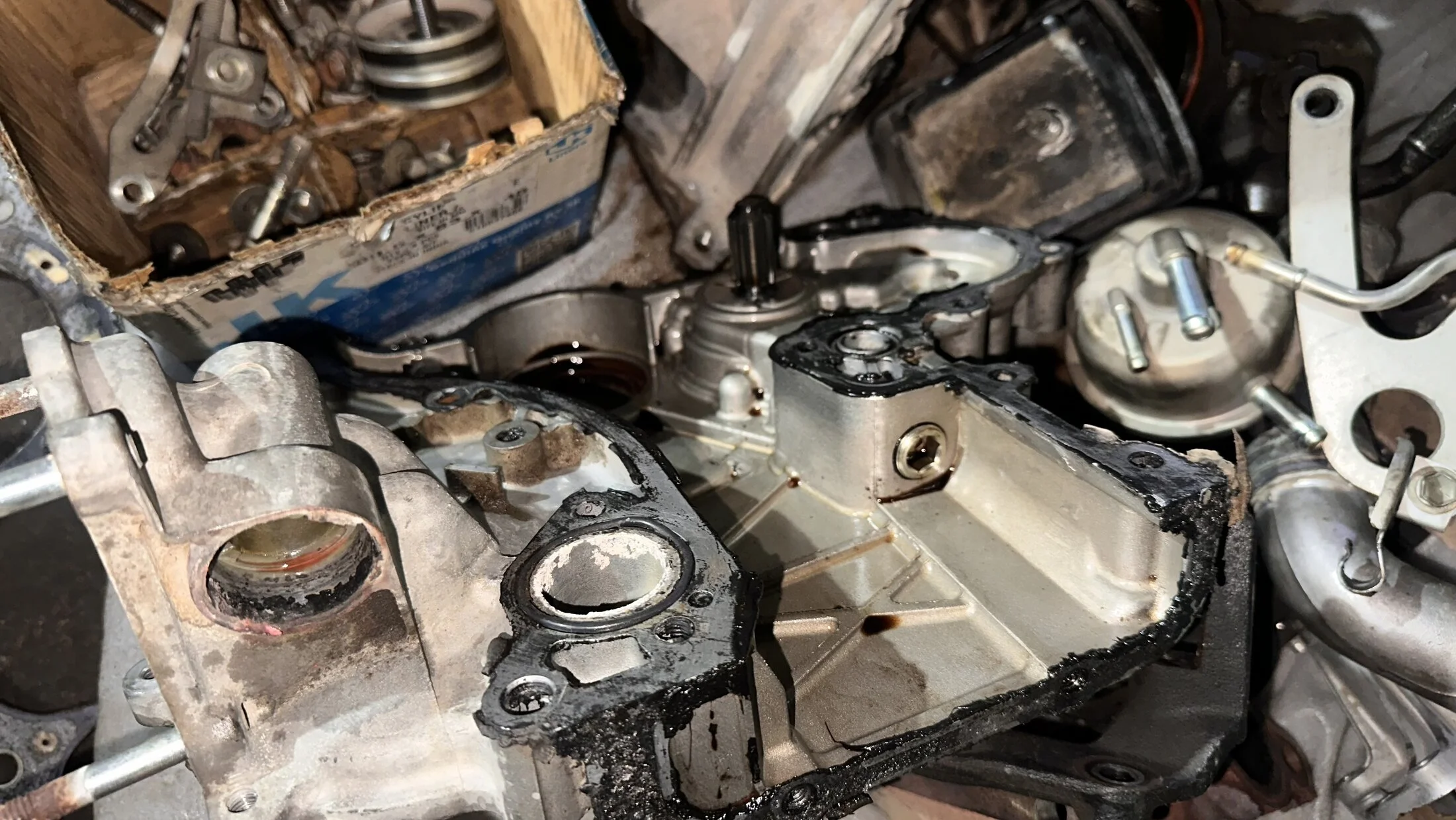

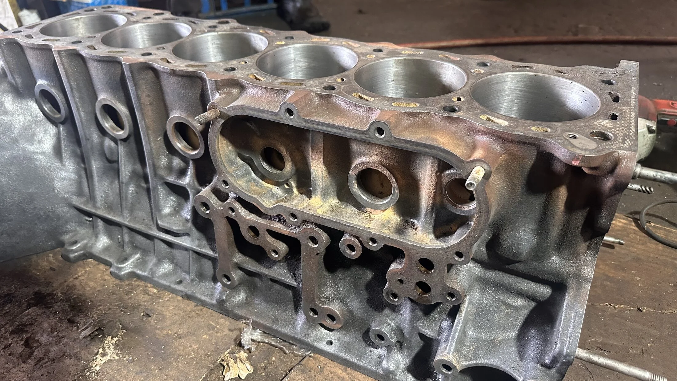

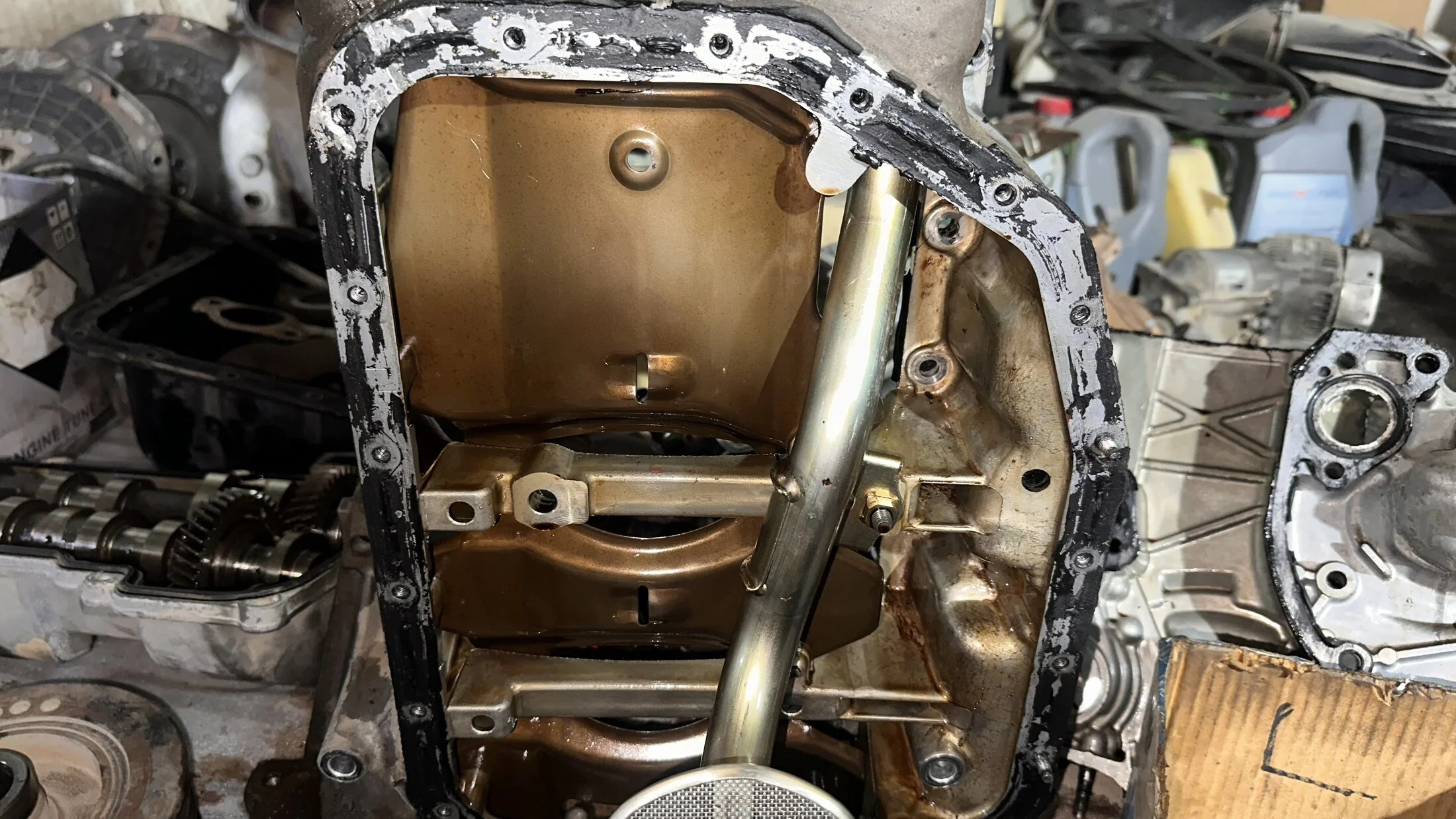

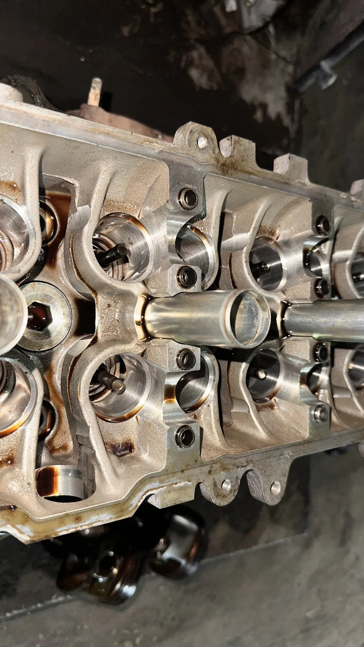

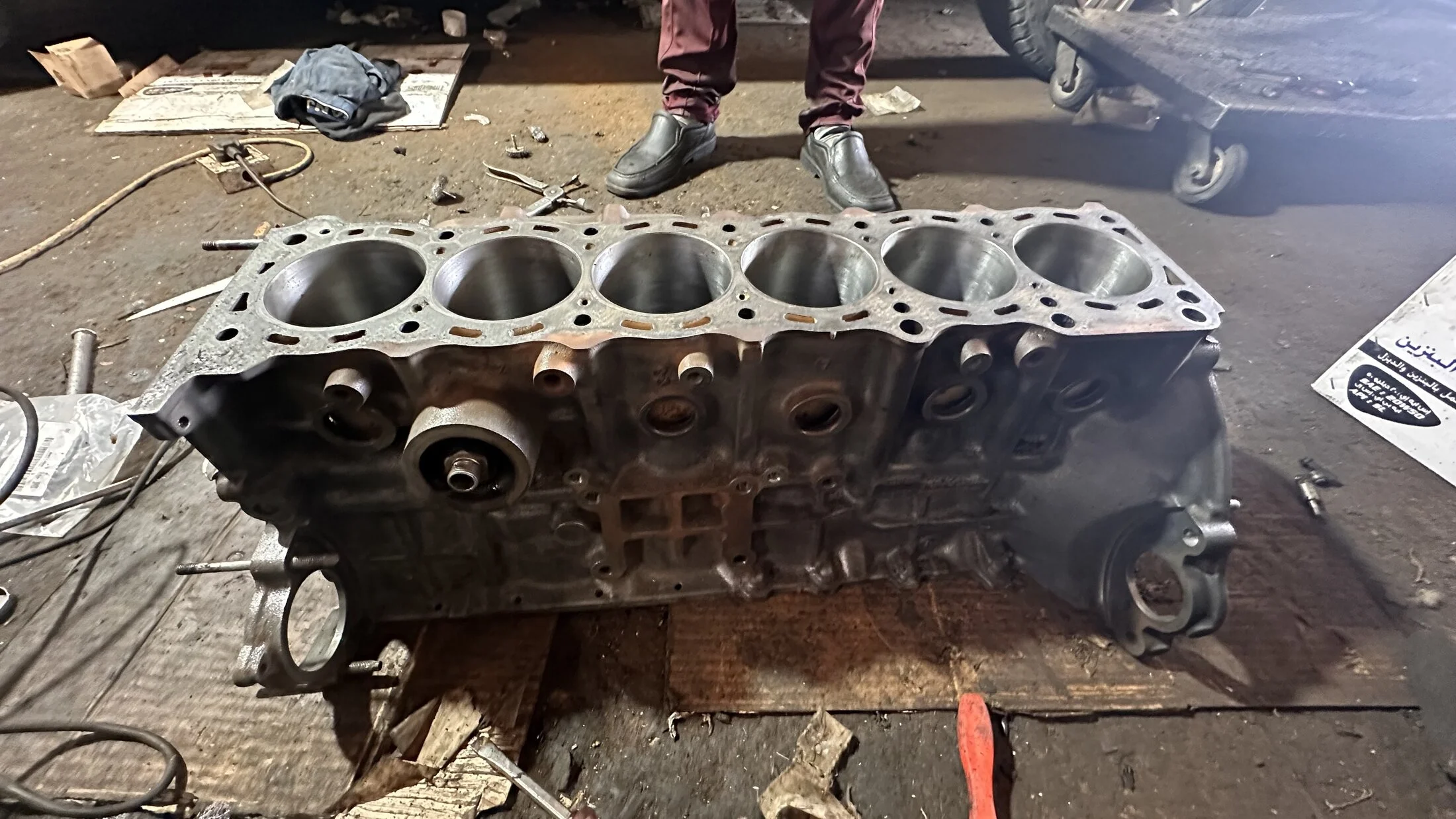

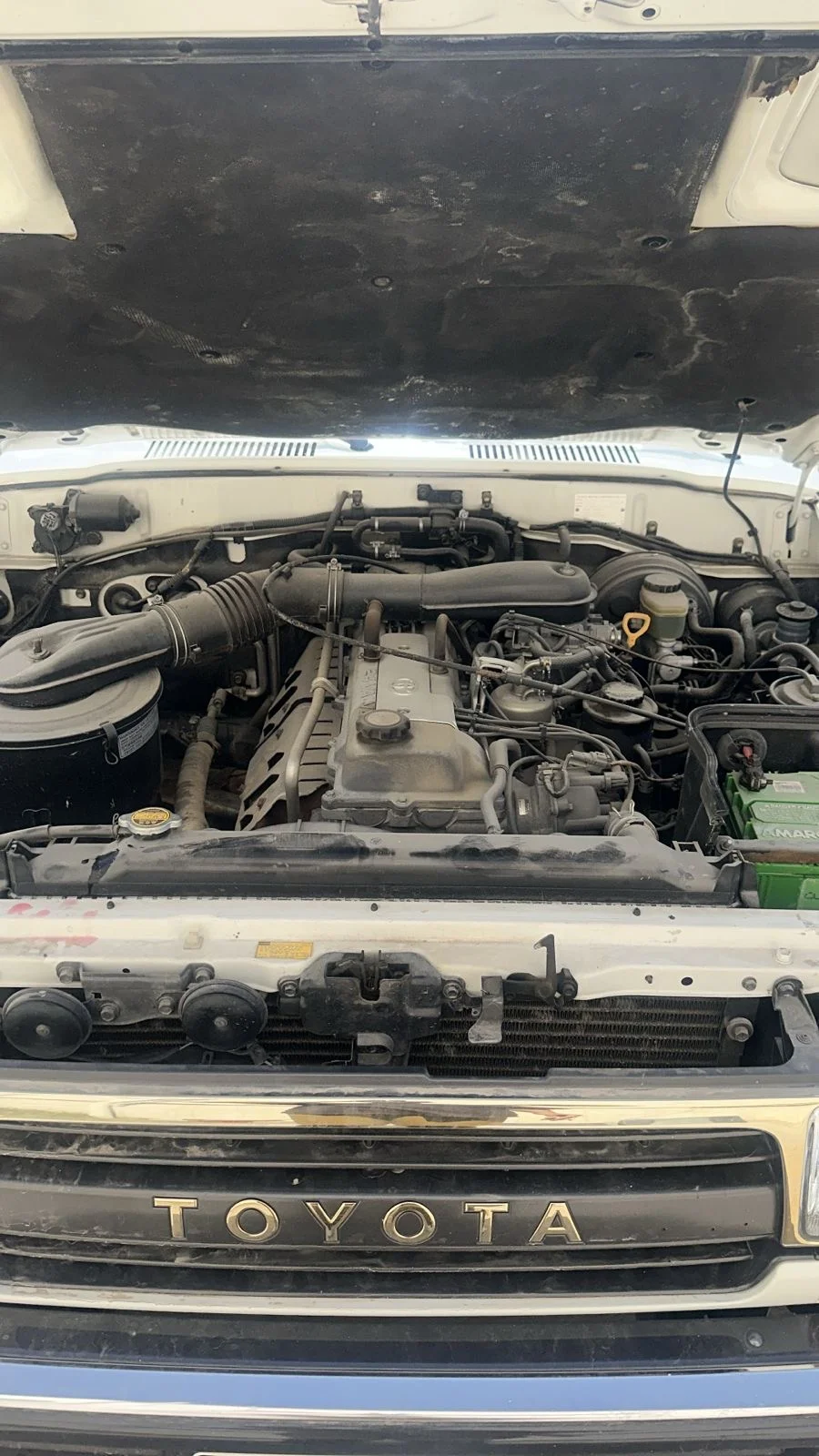

Well, the engine was pretty solid, and everyone here got mad about unplugging the whole thing. And yeah, it was satisfying to see clean coolant routes.
The oil areas were not burnt and all you see is clean aluminum

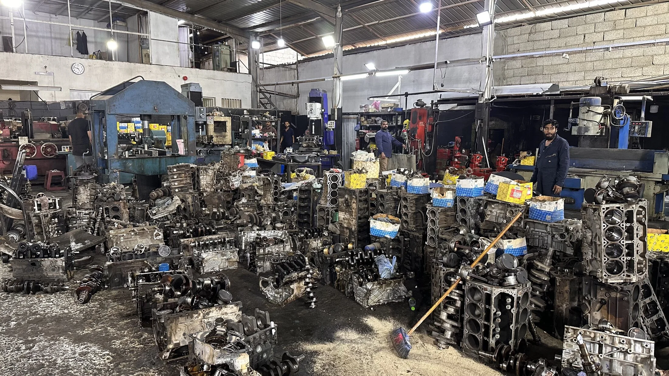

Today we should get a response from the machining shop to determine what rings and bearings we should go with.

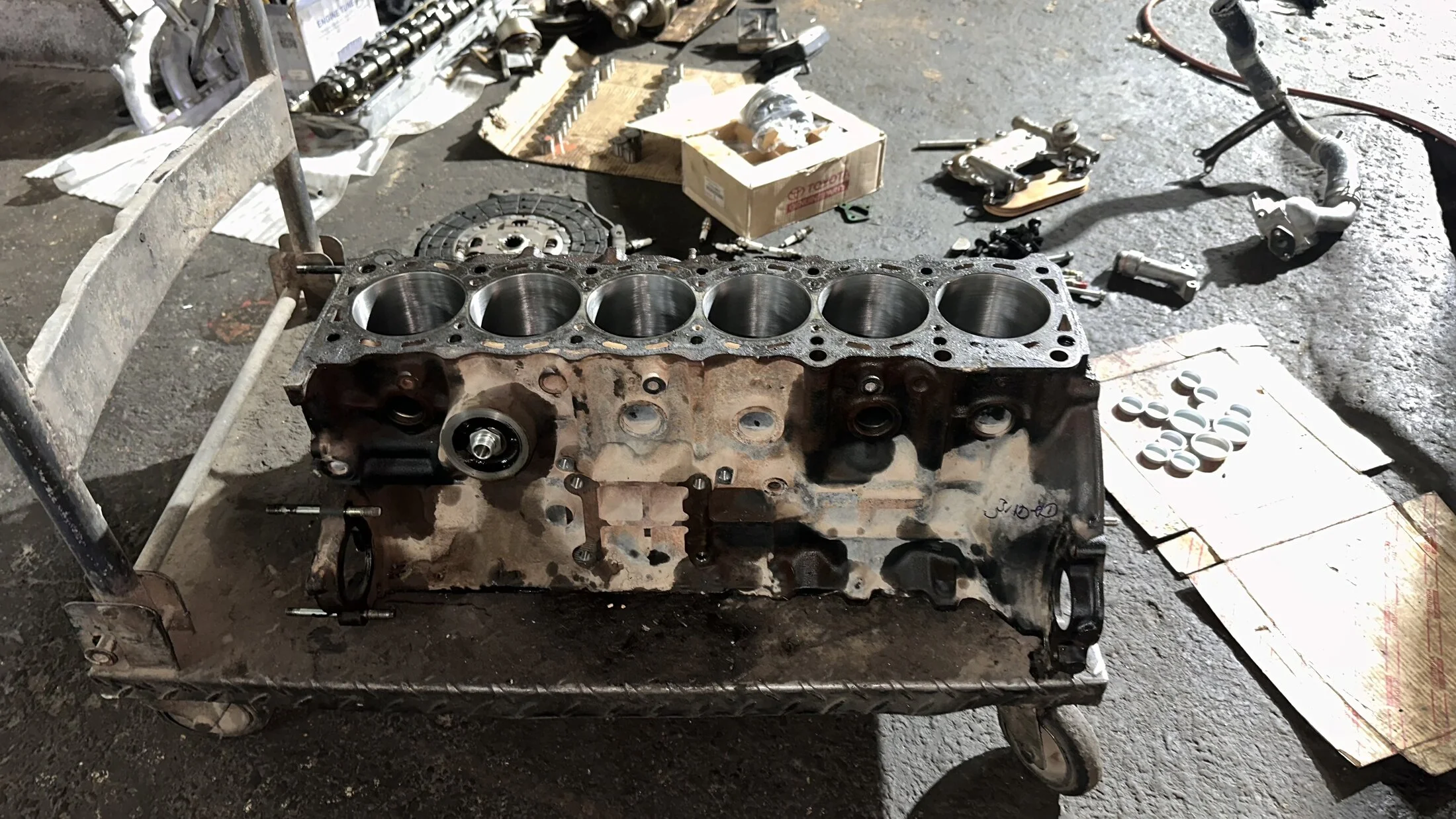

With such good bones on this truck, and the cosmetic and suspension refresh it had, decisions had to be made on mechanicals.
Before we got to the tear down point you've seen above, we had a lot of discussion back and forth about what to do. Meshal and his trusted mechanic did not want to disturb the known good engine. He told me there, that decreases the value of a vehicle. I made my case that here there is a lot of concern about head gaskets failing after 200k Miles and 30+ years. That taking care of that would add, not subtract, value to the truck in the states.
Then mission creep set in. If we were pulling the drivetrain to do a head gasket anyway, why not do the rest? OEM parts won't be available forever.
So we've gone from a cooling system and overall light refresh to a full mechanical rebuild.
- engine rebuild with new OEM pistons, rings, bearings, valves, etc.
- transmission and transfer case rebuild, new bearings and synchros
- full cooling system Refresh

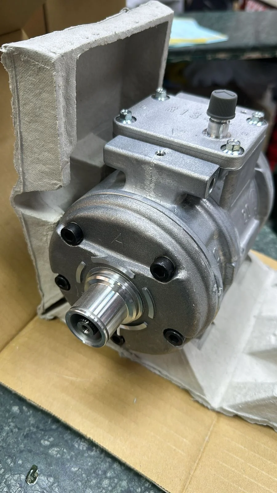

- AC refresh
- new power steering pump, brake MC, clutch MC and slave, clutch, etc.
- diffs are on hold for right now. If I retrofit lockers, Nolen will do them stateside with eatons.

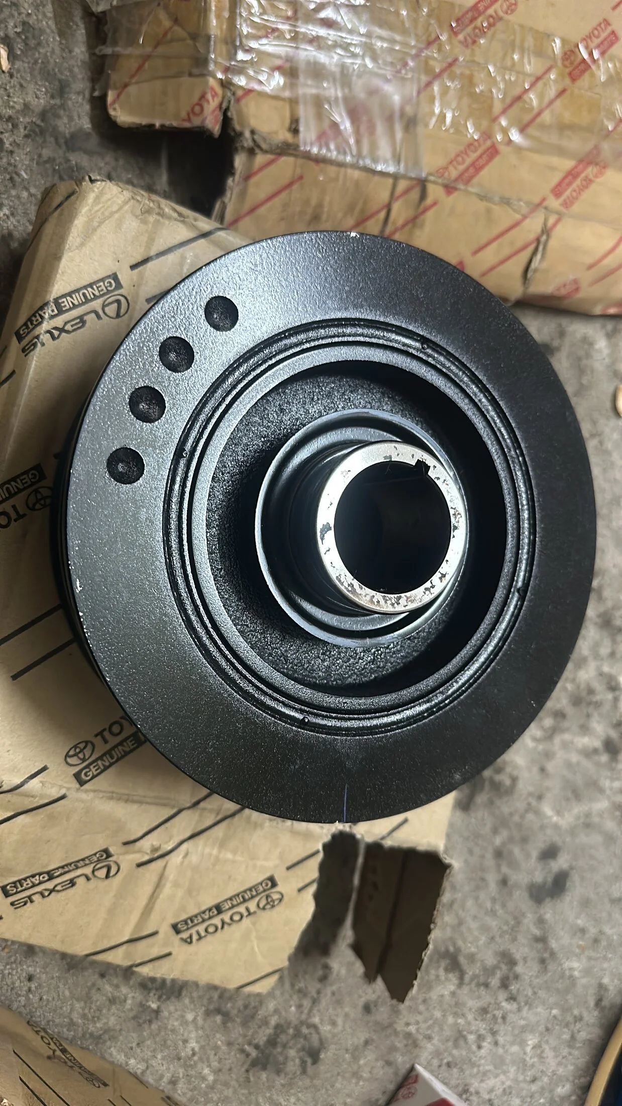

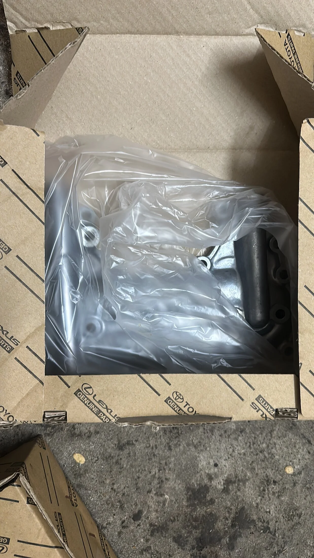

I'm amazed that all of this is available as NOS OEM.
Meshal working his part finding magic

Machining shops are crowded and yes not clean at all. i keep screwing my fancy Carhartts

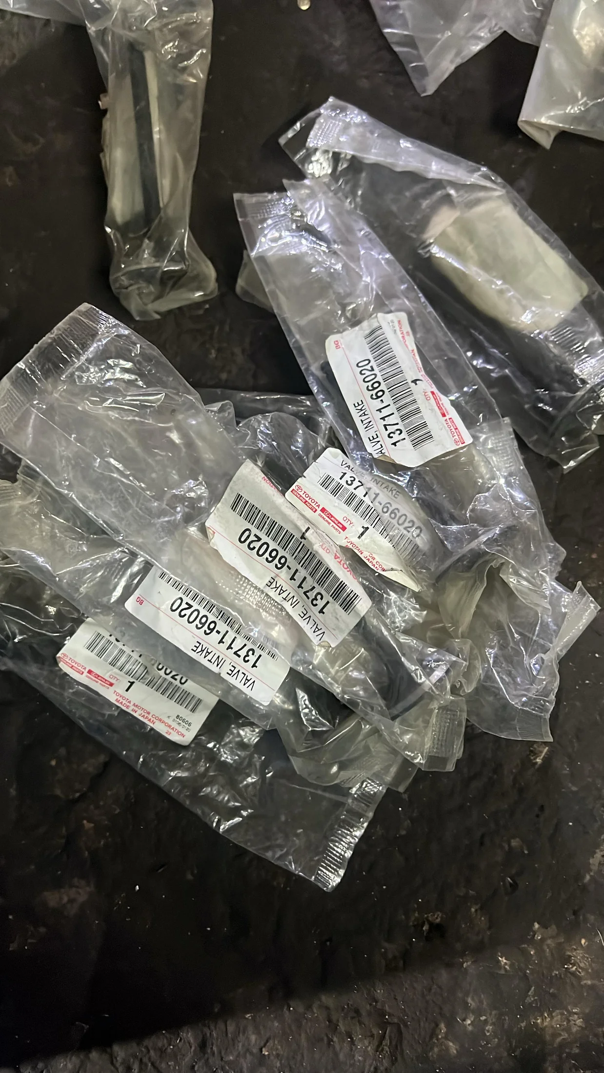

We found new valve set for cheaper than the main dealer so we are going to do full head
