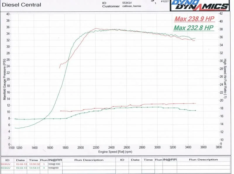

Here is 1HDFT with Gturbo Bad Boy STage 2, very bad water to air intercooler (post intercooler temps 130C). Will be dynode again when intercooler is fixed.
this is real power at the wheels - ramp rate = 100, so nice and slow, power is at the wheels (no correction for flywheel)
Yes that is 35psi boost..... ;-)
Low end boost will improve when intercooler is working. You can see that at ~1700rpm its making 24psi on one run, then falters a little before it rises - thats compressor surge. Once the intercooler is fixed and temps post intercooler are dropped to 50 degree C or below, the surge line will move to the left and should move far enough to not be a bother :-)

Another good result Graeme. Are those figures ground or flywheel?

Hi Dougal, thanks mate. Power is at the wheels - the Dyno Dynamics always show at the wheels. People can tickle the corrections to give higher results but this is setup with a ramp rate of 100, so nice and slow, real power at wheels. The local Bosch dyno does back correction to flywheel (surprisingly accurately) but doesn't show low rpm correctly
