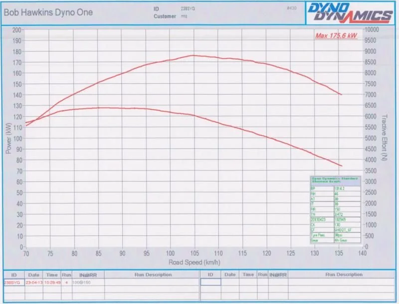

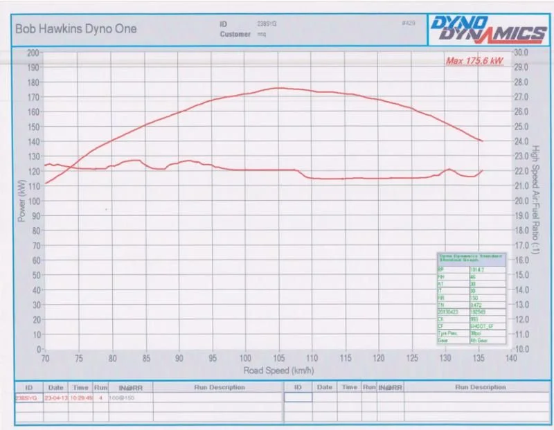

I asked the customer (in Townsville) if the dyno mob were surprised at the power. You'll laugh at the response:
Yeah mate they were. It was funny when I came back they had my Ute off the dyno and he was on the phone to dyno dynamics saying that the dyno wasn't reading correctly. He then put a known vehicle back on to make sure it was reading correctly and even then he couldn't believe the cruiser put down 175kw. The most he ever got out of a 1hdfte Ute was 130kw and 147kw out of the V8. We both think there is room for more power because under load there is absolutely no smoke
Impressive numbers!
ps. any chance for torque curve?
Torque is shown above. Rpm isn't shown and they didn't do the run from 1000rpm like I like. And... its shootout mode not a high ramp rate. But.... you get what you pay for - in as much as this customer is 4000km away so I didn't do the dyno or pay for it and wasn't even there :-)
As for the torque, it will be over 7000N tractive when retuned. Also, to give an idea, a std ute is ~ 4000N tractive and 90kW in standard form. Considering no smoke and better normal driving economy - thats quite profound!
This ute is seriously quick! What is important is the power and the afrs and lack of smoke at full load. We already know that low rpm torque isn't an issue with a Gturbo :-)
