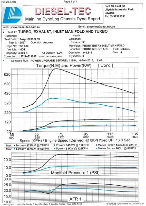

Well, it is done (except for the airbox mod) and it feels amazing to drive. I've never had one of my LandCruisers push me back into the seat and that's even going up the windy hill of the Mt Dandenong Tourist Rd from Ferntree Gully! I'm on 35" tyres too with full fuel tanks (265 ltrs). I have a big 2nd tank. ;-)
I can also not praise Andrew at DieselTec in Lilydale highly enough. He spent an enormous amount of time making sure everything would be perfect and safe.
The intercooler is incredible. Whereas before I'd see up to 130 degrees on the inlet manifold and 450 degrees EGT (post turbo) I have now only ever seen 44 degrees and I can't even get the EGT gauge to register above 300. Andrew did his own tests and found the intercooler was dropping the temp by about 70 degrees. You can't really see the mods from the front and the grill didn't need cutting which is pretty amazing considering it is 9cms deep.
Unfortunately the other airbox lids wouldn't fit properly so that is still standard and probably a restriction to higher boost levels (current max is set to 27 I think). When Graeme makes his new airboxes available I'll probably get one.
Performance wise I can feel something from as early as 1500 but it really takes off around 1800. And the sound of that sweet turbo ... ;-) I should add that my clutch is now slipping so that, along with a general gearbox overhaul (synchros mainly), is on the list to do.
Anyway, what you want are figures, graphs and pics so here they are. What? A maximum of 3 pics per post! Hmmm. OK.

Nice work. I think your EGT gauge is definitely reading too low, does it protrude to the centre of the exhaust stream?
Well it was giving a reading before it went there for the intercooler and final tune and it looked to me like it was connected properly under the bonnet still. I don't know. I'll have to ask Andrew about it.

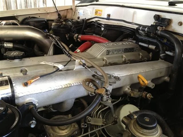

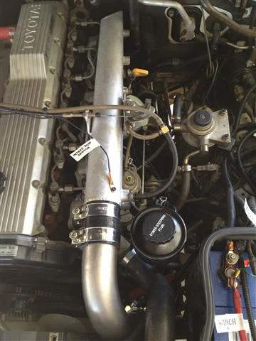

Custom intake manifold
Any more pics of how the intake manifold was modified?

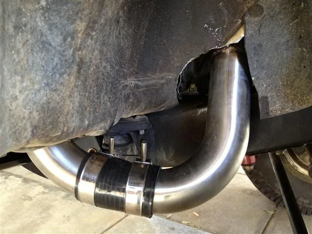

Yep! Basically as I understand it the guy in Qld cuts the top half and front end of the original off and then weld on a bigger top and the front opening. I don't have any pics of it uninstalled sorry. Also a pic of one side of the piping going around underneath.
