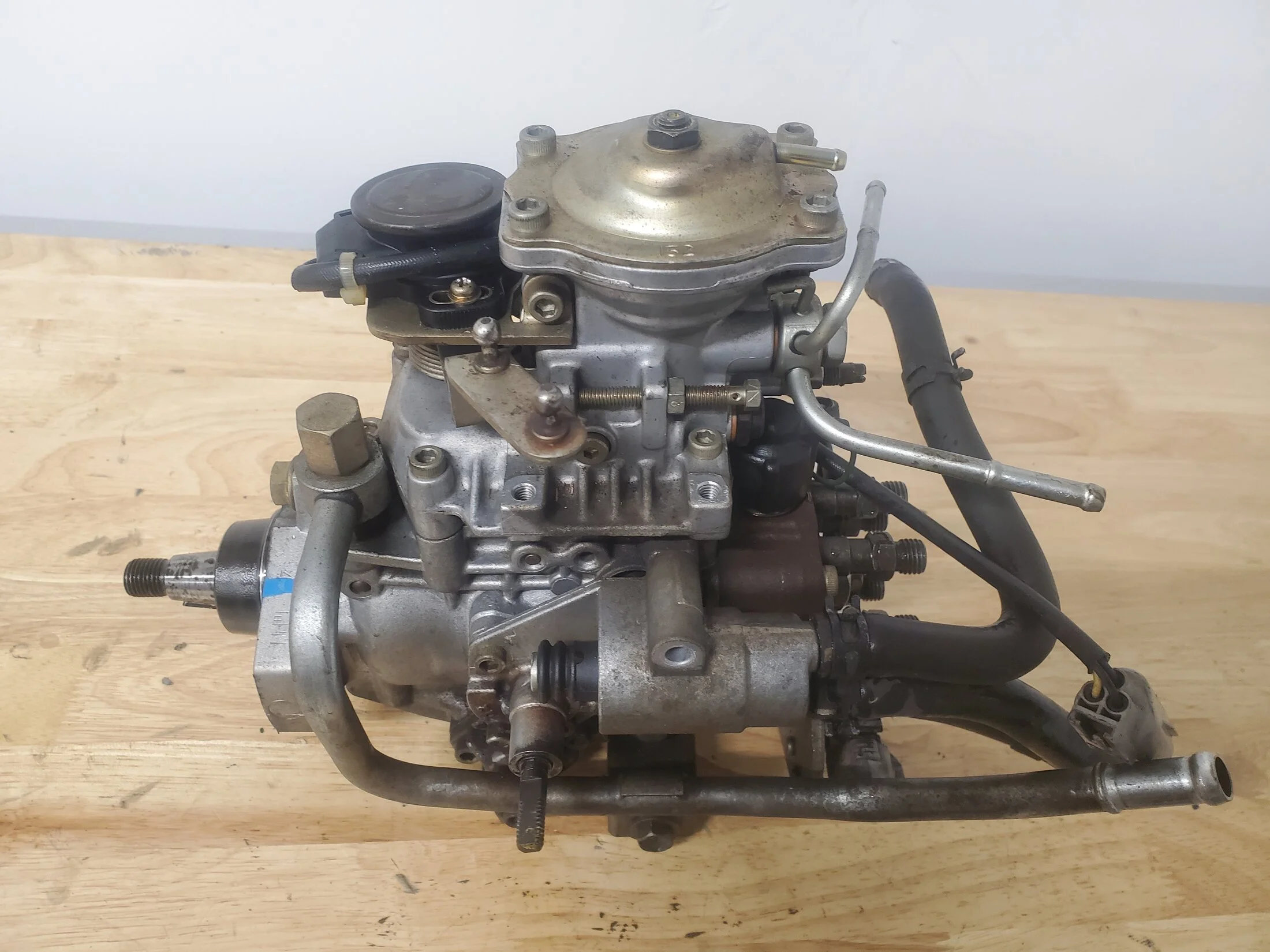

So, update. This morning -6 degrees F. I plugged in the circulating heater and let it cook for about 45 minutes. It was working marvelously, pumping loads of hot coolant around (1500w heater). I jumped in the truck to start it, ran glow plugs 3 times, cranked it over, not even a splutter.
Now here's where things got interesting. I let the starter have it for a few seconds, and there was no smoke. Zero. Which means, no fuel. Popped the hood and sure enough the lift pump is soft. As I am operating the lift pump, I saw two drops of fuel roll off the ACSD arm on my pump.
My suspicion was correct all along- the hard starts and weird idle were air in the system. Pulled truck into the shop.

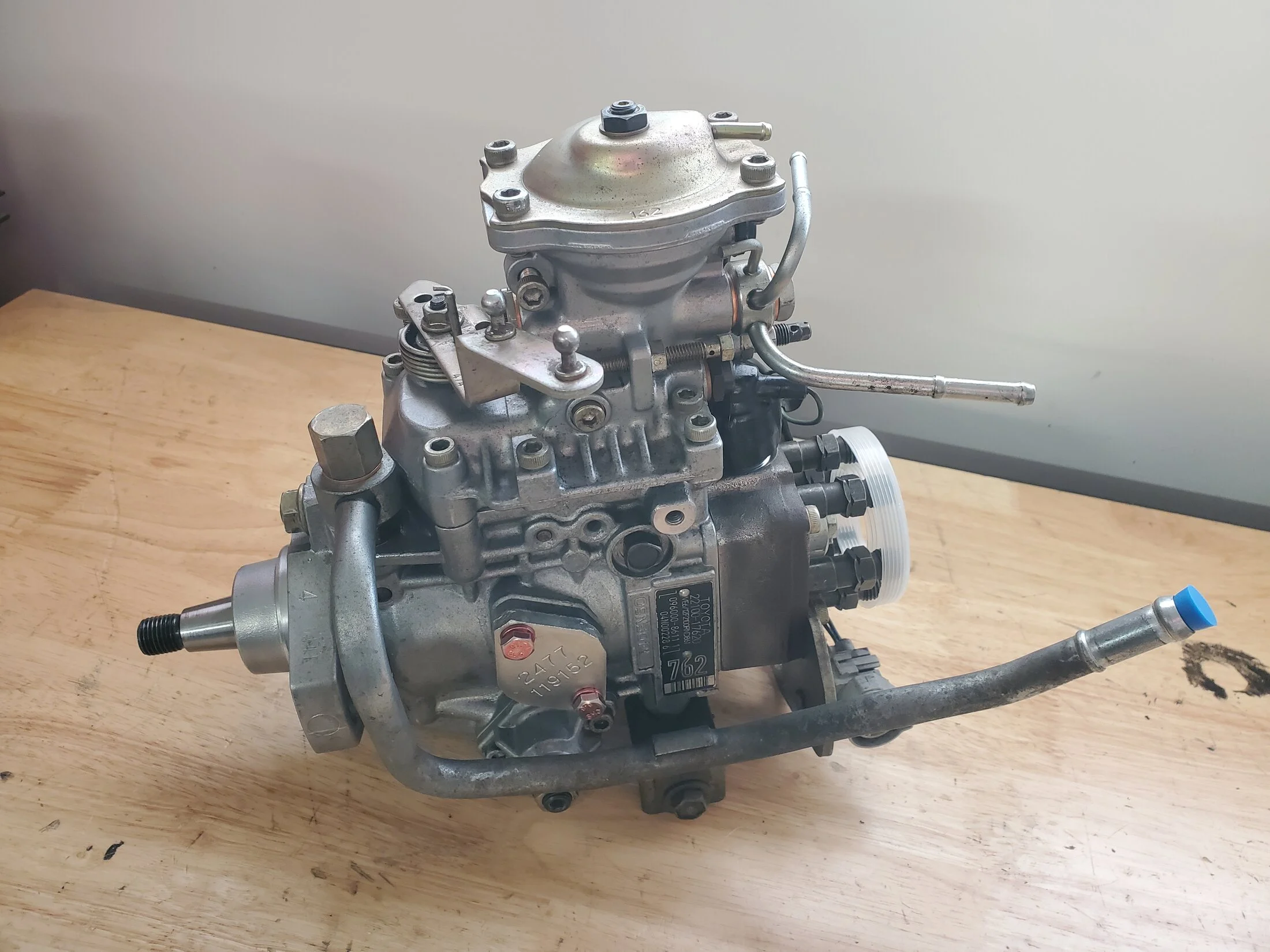

Removed 12mm nut from ACSD arm, took of the arm and springs.
It is difficult to tell in these pictures, but the ACSD shaft is the culprit. A significant amount of fuel has been escaping. It's been going on slowly for some time, judging by diesel sludge all over under the pump. I figured it was my power steering underneath but it was diesel all along.
The shaft has a tiny bit of play, if I push it to the side and pump the lift pump, I can hear the whistling sound of air entering and diesel dribbles/squirts out.
I ordered an ACSD delete plate from Dave at Back40 Imports. He is a few hours north of me up in Kalispell MT. So it will be here this week.
I guess that all the work I did exacerbated the problem, and it got bad enough for me to finally notice. The super cold weather also pulls the ACSD arm, which in turn increases the leak. So when I park it for a few days in subzero weather, all fuel is leaking out of the lines and pump.
It seems like mystery solved!

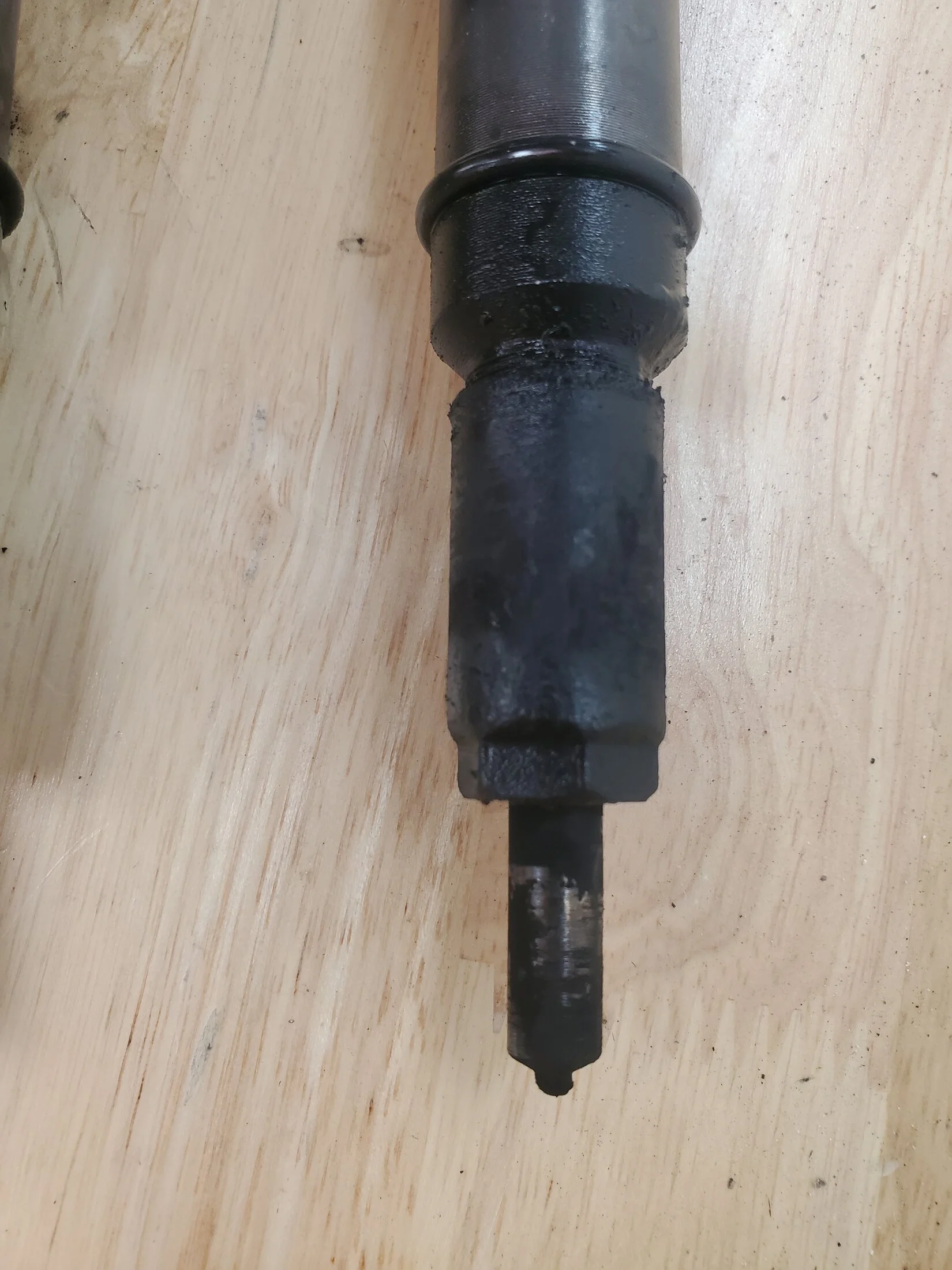

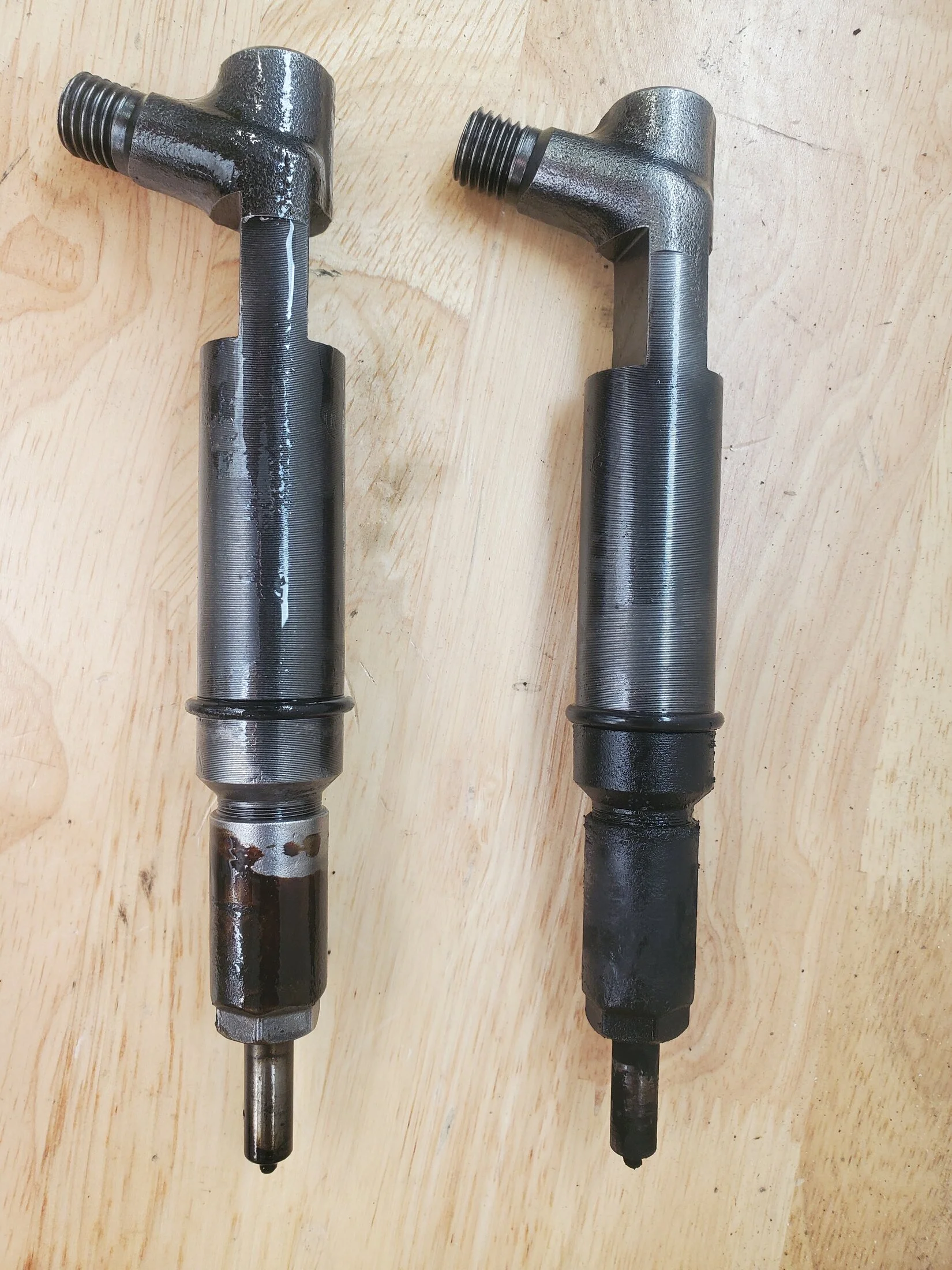

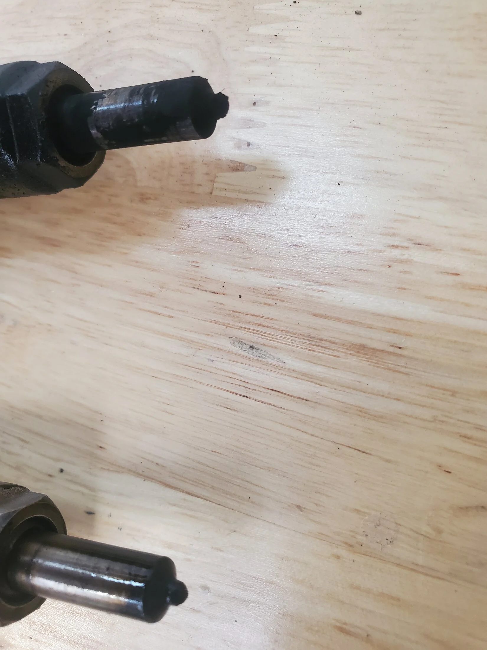

As suggested by @67azcruizr , I pulled cylinder 6 injector. Indeed it does look VERY sooty and gross above the copper washer but below rubber seal. 😥

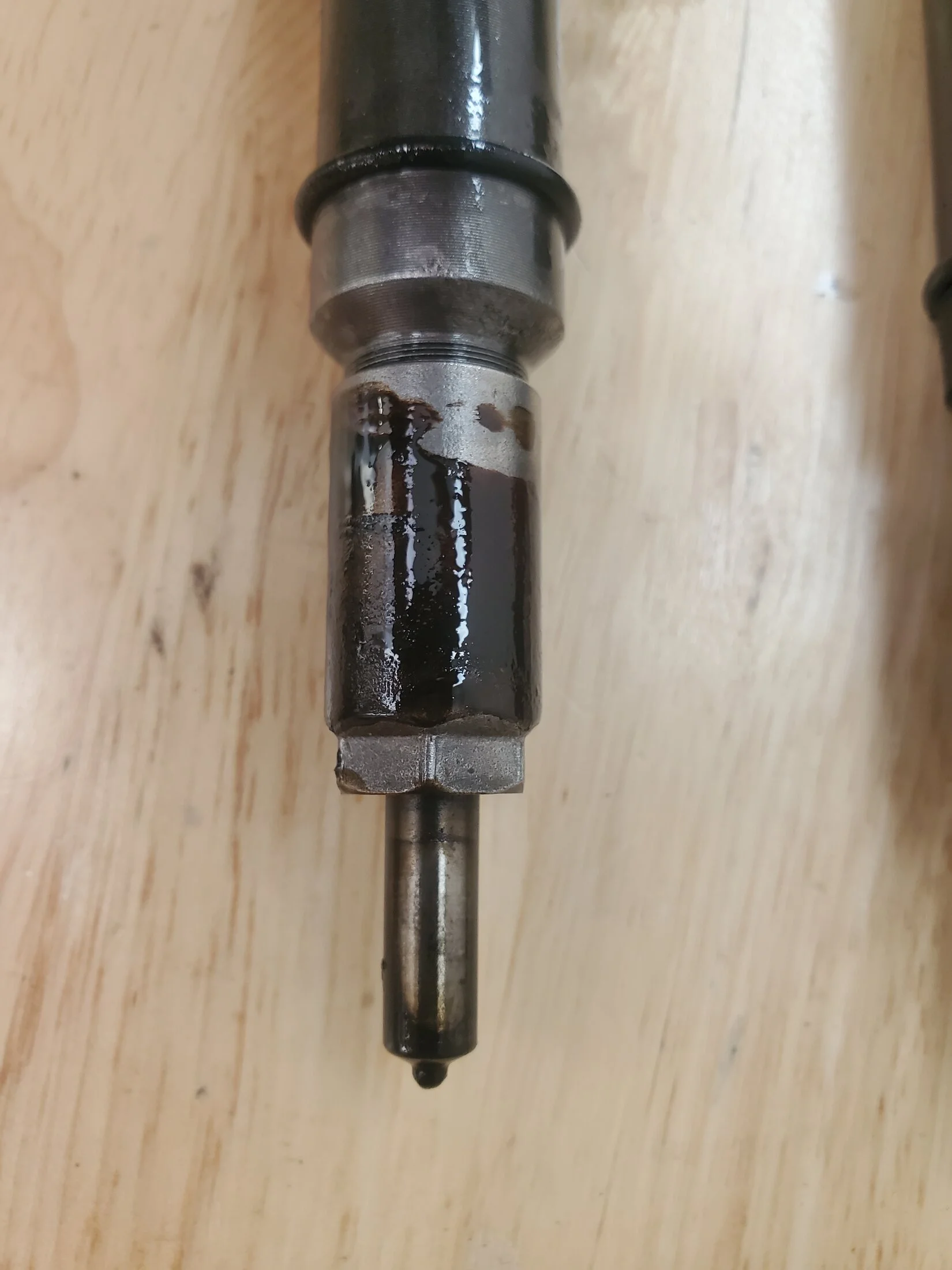

Cylinder 5 pulled, shown for comparison.
What is my next move here... is there a way to seal/repair the injector seat without pulling a head.
I found this thread which discusses a few solutions like an epoxy. Has anyone tried this. What did you use to keep the cylinder clean.
Well, s***.
Well, s***.

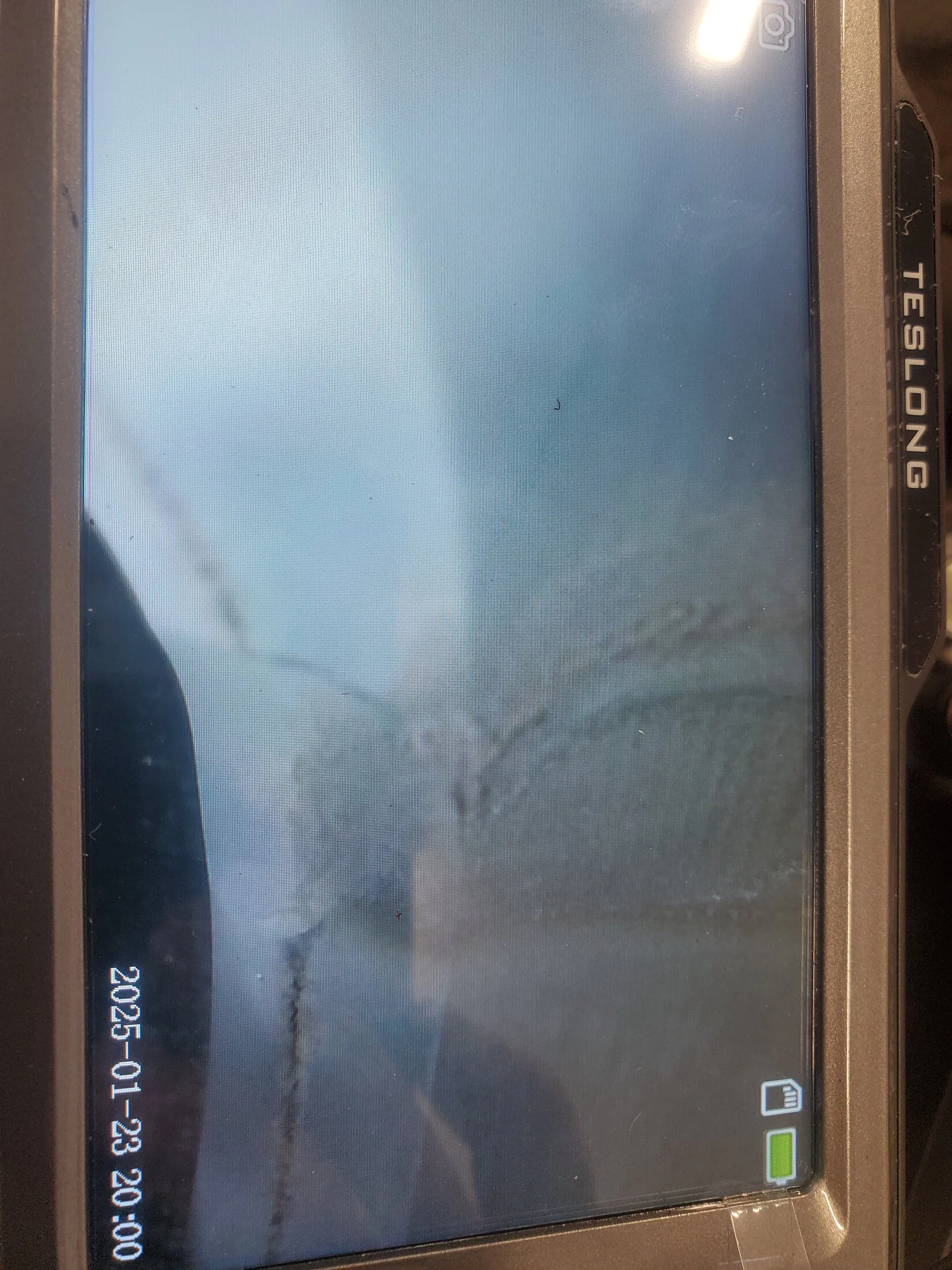

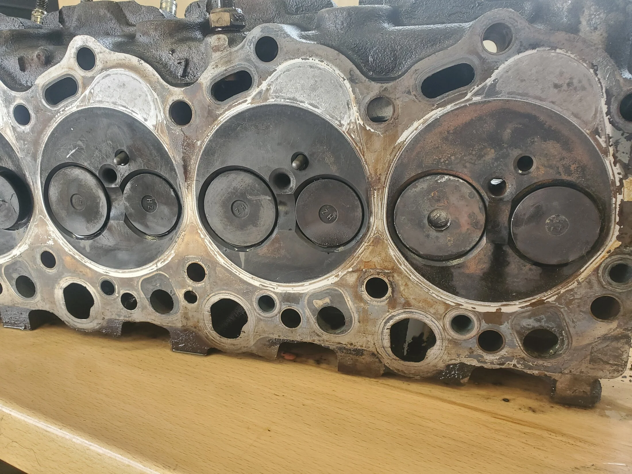

So I boroscoped cylinder 5 and 6 today out of curiosity. Cylinder 6 piston initially looks HORRIBLE. However it is not damaged, swollen or cracked, but rather stained with awful looking rust colored and white stains.
cylinder 5. Later type piston bowl can be recognized by the "frills" on edges.
Cylinder 6.
The silvery blob is a drop of liquid reflecting boroscope light.
As you can see the edges of the bowl are not chipped, melted or deformed but rather stained with crap.
Some penetrant oil did leak down into the piston when removing the washer, but I vacuumed it out with a shop vac + straw.
Anyone seen this before?
yea i don't think it's much to worry about, the pistons are just raw aluminum on this motor, id spend more time looking at the cyl walls that's much more important. Should be easy if you have the articulating camera, i use mine all the time.

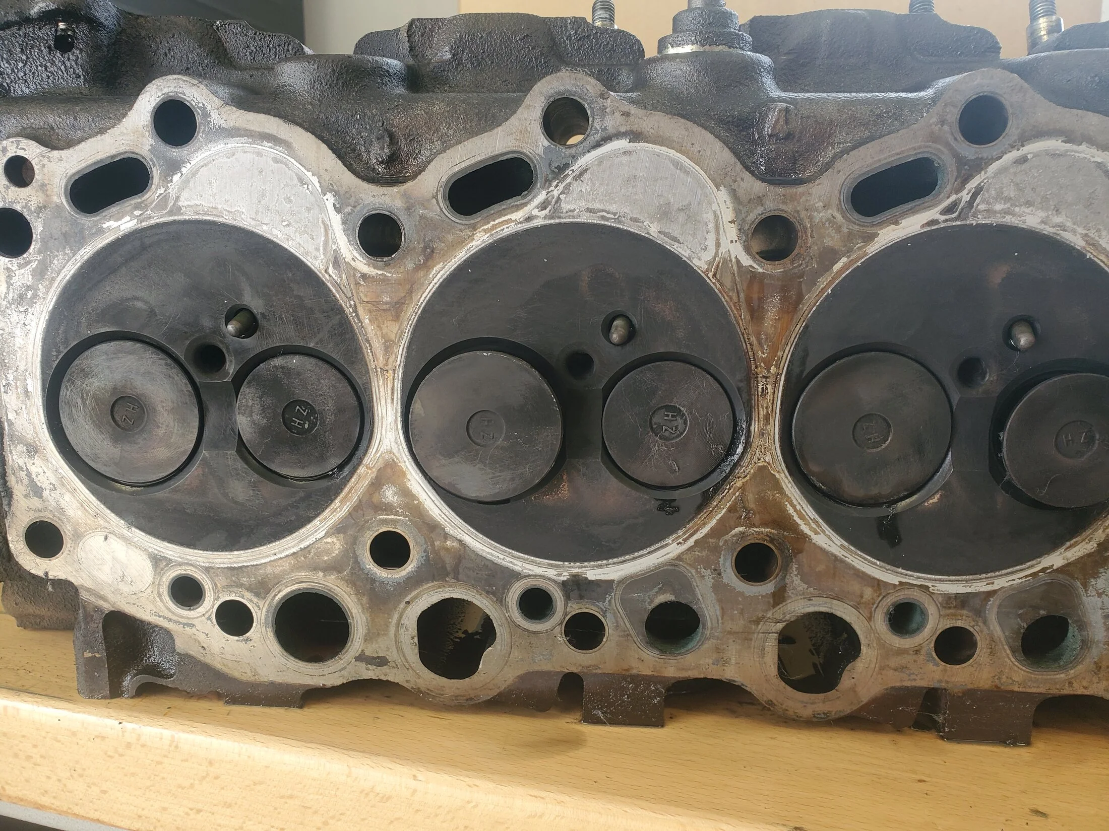

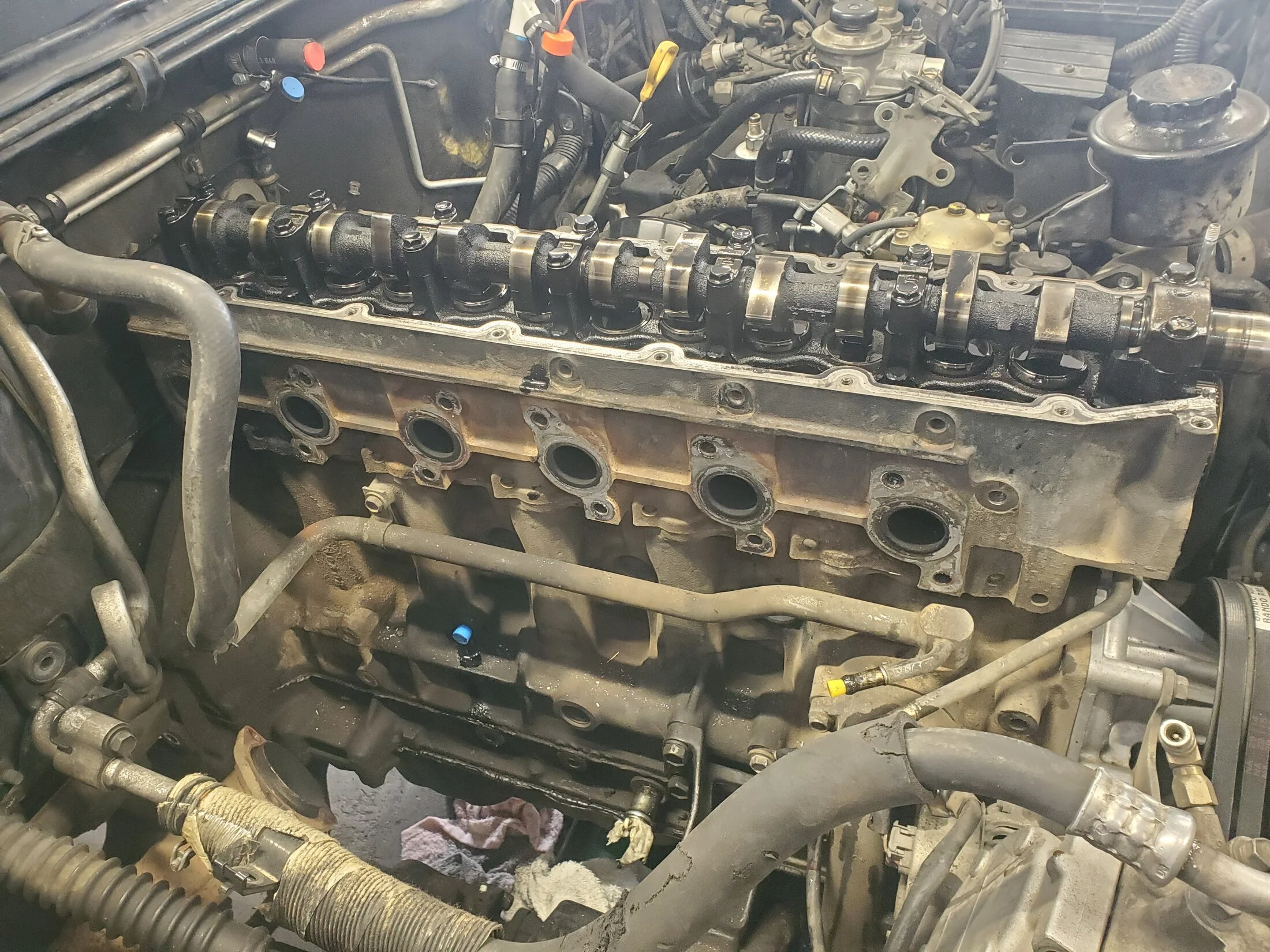

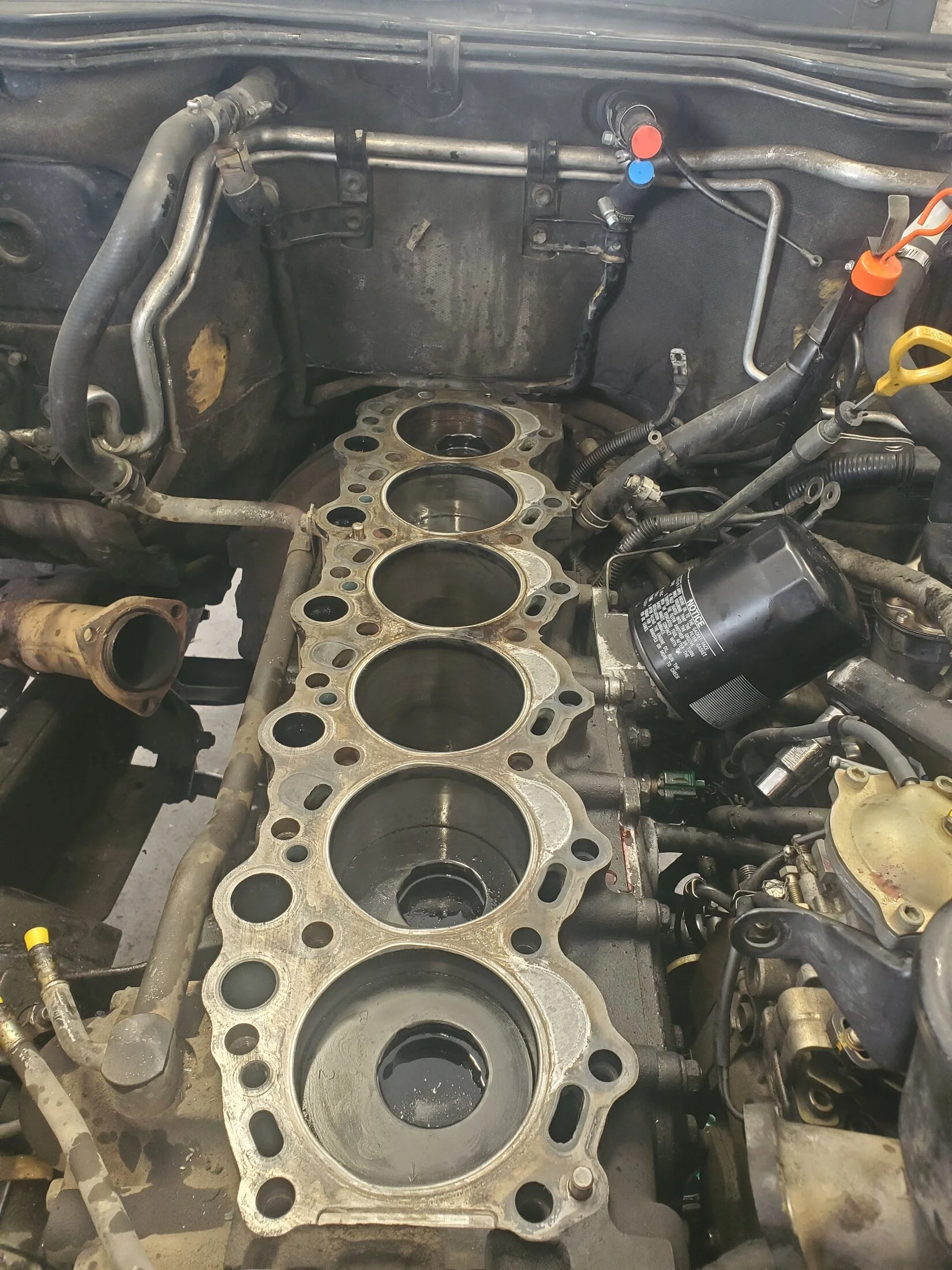

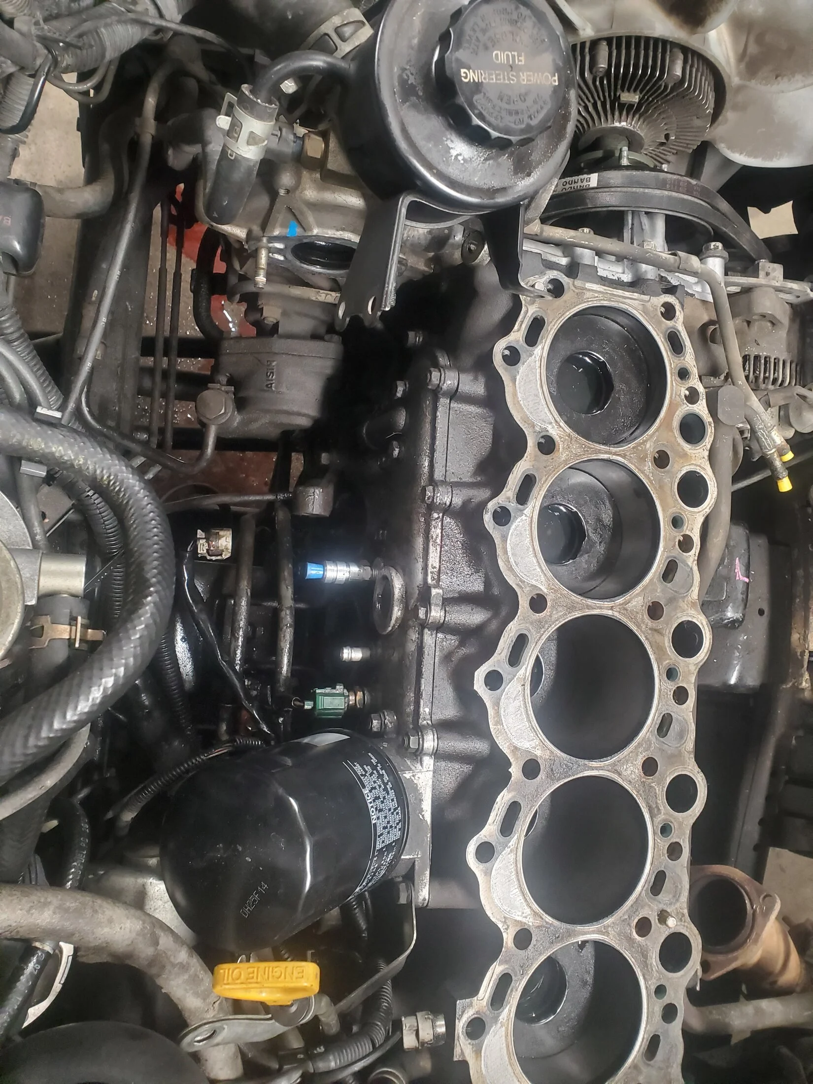

Head is dropped off at a local machinist. The folks that normally do my engine work recommended him.
I will rebuild the head since I have it out. It's gonna be two weeks, probably more like 3. Machinist is going to recut my injector hole for cylinder 6 and either add a spacer or do 2.5/3.5mm increment so I can stack washers.
Also I'm taking the opportunity to send my injectors pump to Dave at Back40 Imports. Since I'm basically rebuilding the whole damn engine I might as well do the pump.

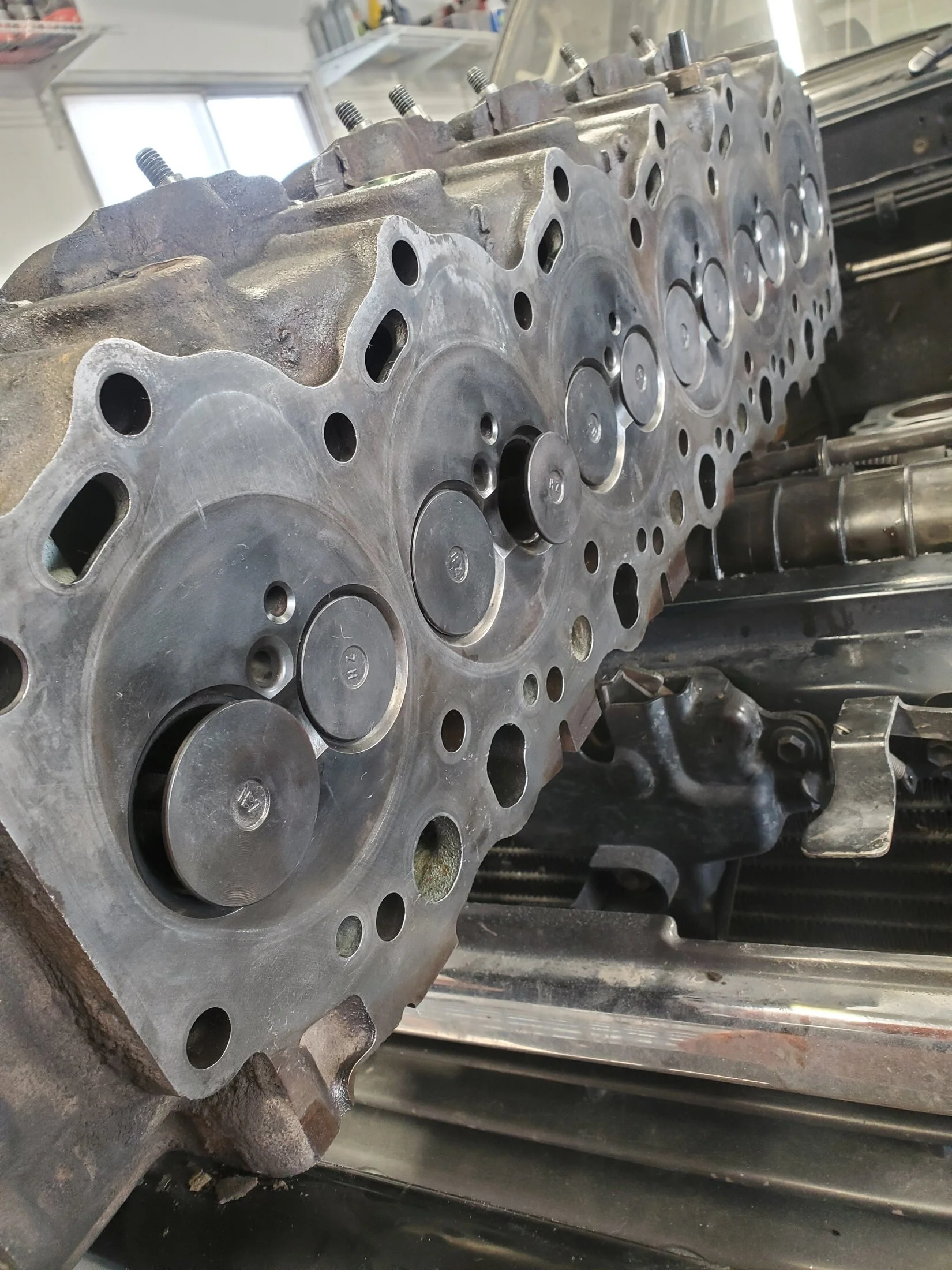

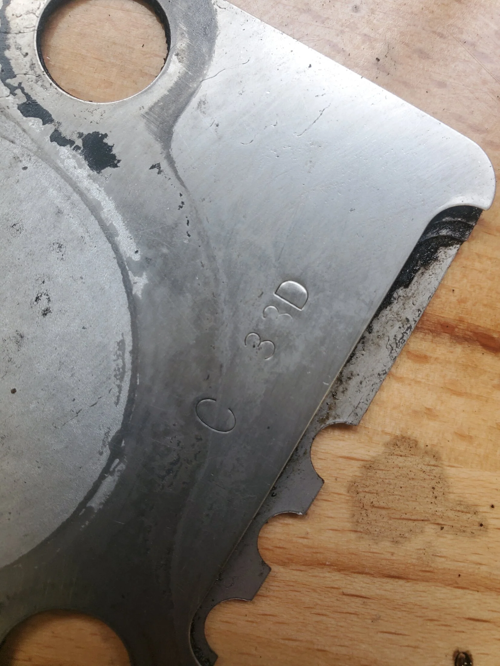

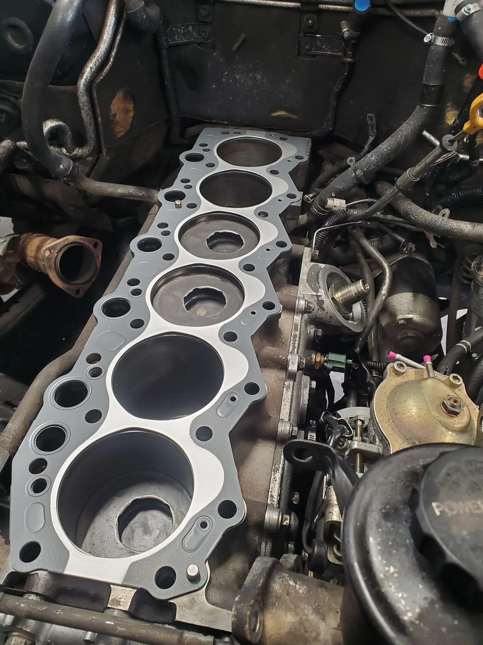

3 notch head gasket. (Red circle)
From the factory, they were assembled with either 1,2,3,4,5 notch gaskets.
Replacement oem gaskets are available as 1, 3, 5 notch gaskets. Same with aftermarket.
Best to measure the piston protrusion height to the block deck at all pistons and determine which gasket thickness you need.
A little update, I spent about five weeks waiting on the machine shop to fix the screwed up injector seat on cylinder 6. They did a great job - ended up cutting the seat down about 1/8 inch, then made a spacer and pressed it in to raise up the injector seat to the original height. I was very pleased with the results, injector hole in cylinder 6 was indistinguishable from the others, and now providing a nice flat sealing surface for the injector washer.

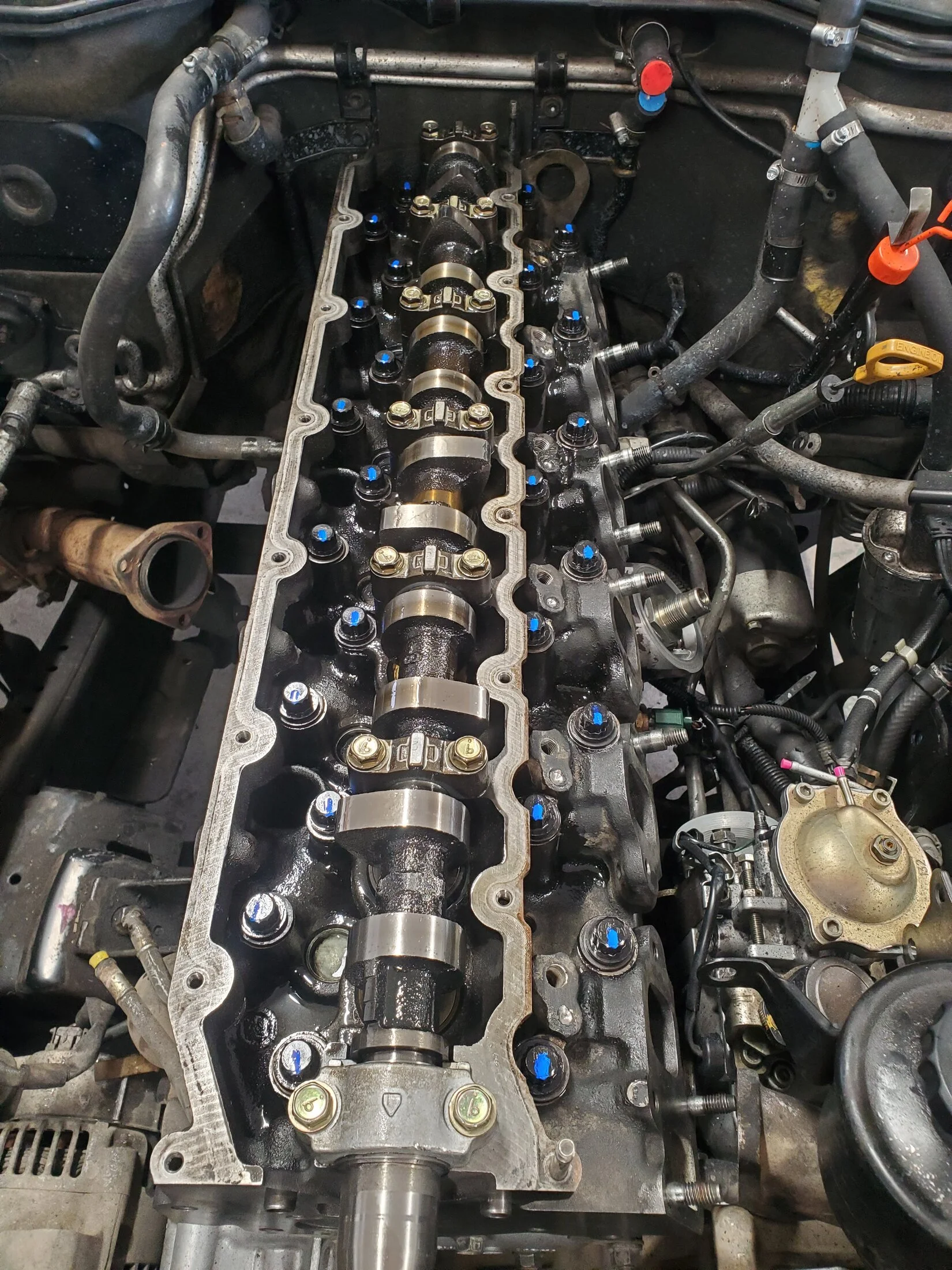

Originally, I was planning on rebuilding my head, since I had it out, and I ordered a full new valvetrain while I was waiting. But the head looked to be in incredibly good shape. Hard to believe it has 420,000km on it. I ended up cleaning everything up and putting it back together as is. Used a new three-notch head gasket, new head bolts, and replaced a few miscellaneous parts while I was at it.I also got my rebuilt injection pump back from Back40, and installed it.
Truck has been back together for a week now, and overall seems to be doing very well. The Arashi Dynamics turbo is working out great, I have left my fuel screw at the factory setting, and am running the turbo with a 16psi wastegate. Green boost light comes on about 1200rpm, orange boost light comes on under heavy acceleration about 2500rpm. While cruising on the highway, unless going up a steep grade, boost light remains green. Noticeably less exhaust smoke, before I was chugging out some black and grey unburnt fuel at several parts of the rev range, now I am definitely running cleaner, hardly any smoke except the characteristic puff right when I start up. It seems like the rig is running the best that it ever has during my ownership.

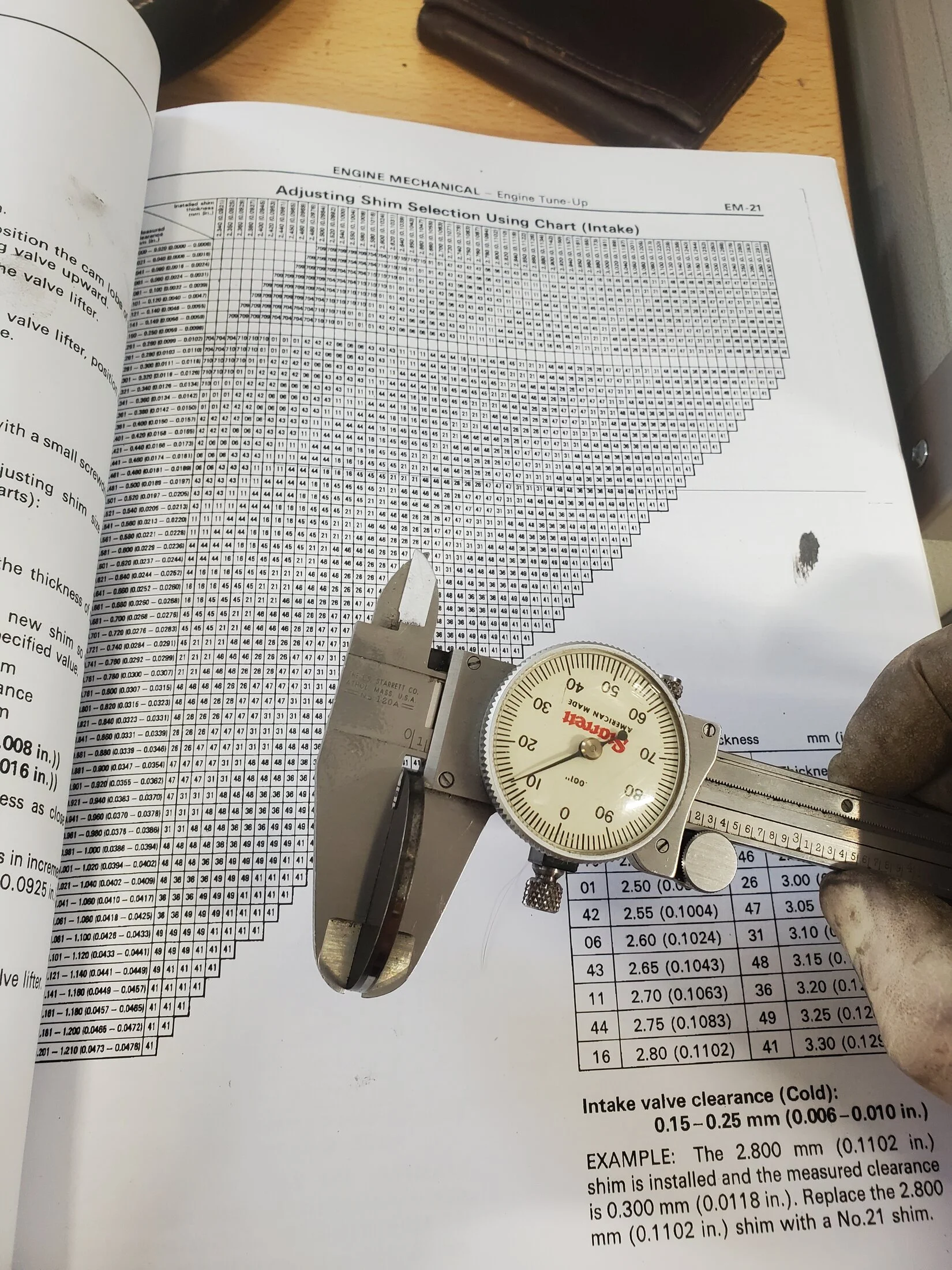

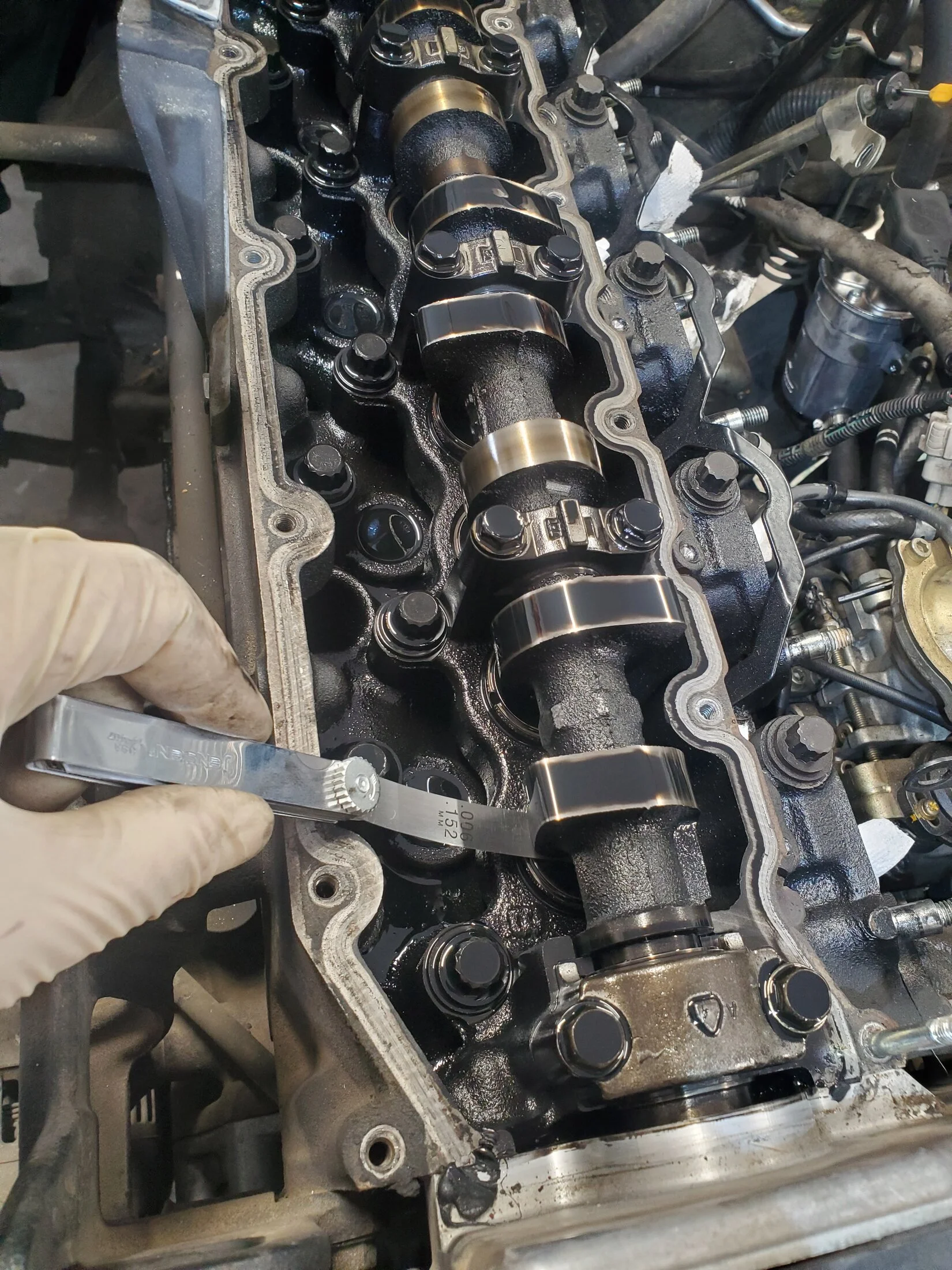

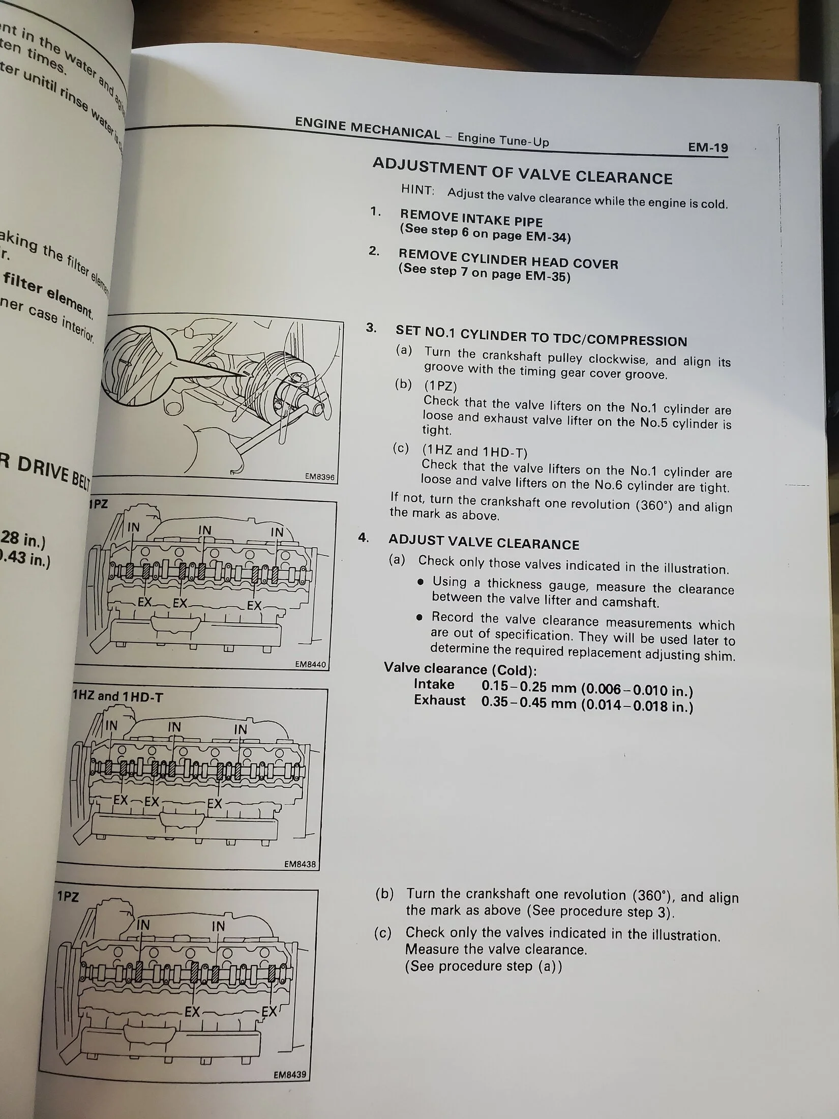

I did my first valve job this weekend on the 1hd-t. Luckily my 3L valve tool is the exact same SST #09248-04011, which works for both. I've previously mentioned the poor gas mileage earlier in this thread... well, that is all making sense now. Gillett diesel tested the injectors yesterday, and they need new nozzle tips (no surprise there).
The truck has been sitting several nights in the shop, so it was definitely a "cold" reading. Once I got the wood stove going, I did my clearances at room temperature. Not one, or two, but EVERY SINGLE valve clearance was out of spec. All the exhaust valves were too tight measuring between 0.23-0.28mm. Intake valves were all too tight as well, aside from cylinder 6 intake, which was too loose... weird.
As I went along, I thought maybe something was up with my feeler gauges. I had a second set, so I double checked everything. Both sets of feelers returned the same reading. I did the same process when measuring shim thickness, I doubled checked the readings from my Starett calipers with my Mitutoyo calipers. Measured clearance is shown in blue pen, shim thickness in black.
Ordered a bunch of new shims, and now we wait.
please fix typo, "SST# 09248-04011", should read 09248-64011
