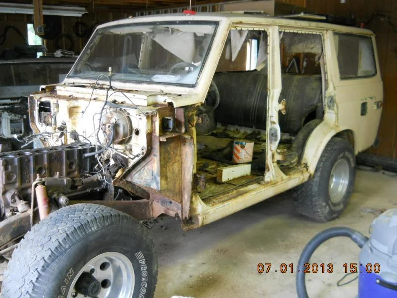

I didn't get a chance to look much today, but tomorrow, I hope to do a more thorough inspection. I think most of the body mounts are decent, but I did find one that had a rusty hole in it. I will try and post more photos tomorrow. I have a garage at my office, and I piddle when I get a free moment. But...sometimes I have to WORK....I have torn everything out of the cabin except the dash, and I will leave that in for awhile. I wasn't supposed to start this for about 6 weeks, but I just can't seem to leave it alone. I will start wiring my c10 next week, and I have to get it off to the paint shop so I can get jiggy with the 55. I hope I can get this beast on the road by the end of the year....

Ok, after not wanting to get too involved with this, yet.....I have torn everything but the dash and steering column, and the windshield and cargo windows. Per the usual for this thing, I need to do more than I thought. I want to now take the windows and windshield out and get the rust removed under the window rubber. After that, I can start on replacing body parts, working on the firewall, priming, sanding, patching nick back rusty spots, rebuilding the engine, and wire brushing the underside and treating that with rust treatment and seam sealer and undercoating. I can't stand knowing that rust is eating away at the vehicle, even though I could make it look good on the surface. I already know that I will not be able to take it back OEM on the interior and some of the exterior refinements, so I am thinking up some ideas, like using diamond plate for the cargo area liner and bed lining the back of the seat, tailgate and floor.....I will not put a headliner back in, but instead, I am thinking about using a 12v electric radiator fan as a ceiling fan. I want the windows and rubber to be right, and I want the tailgate to work as it should. I want the body 99% rust free, I want the drivetrain reliable for a thousand mile trek. I am going back with the seafoam green factory color with a cream/white top. I am looking into a old man emu spring system for the front and back, any comments on that? Any pitfalls about shackles, bushings, pins, etc? I also want to overhaul the steering system with new joint, ends, damper, etc. I am on the look out for a a front disk brake system too. Sound ambitious?

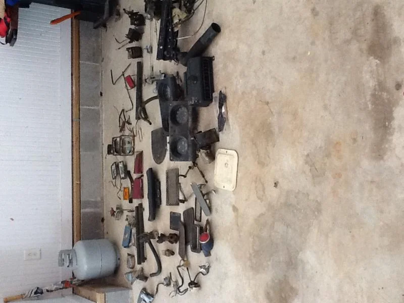

I made a new friend today, and just got back from N. Atlanta with my goodies. 4 doors with glass and rubber intact, small amounts of rust and only a couple of holes...plus what you see in the photo. I have a good start on my nick knacks plus when my parts truck gets here, I should have 90% of the trim stuff. I am still looking for a couple of front turn signals....oh well back to BBQ-Ing my ribs. Have a great 4th.
Scrap daddy, I have been thinking about what you say about not knowing what to do first since so much is inter related. Well, I keep taking it back more and more until, I am convinced that the only thing that you can do with these things, since they rust so badly, is to strip them down to the core and remove or stabilize the corrosion as you put it back together. The hard part is finding suitable parts to use as u do this. I feel certain that I will be having to replace all of the rubber on this beast, the windshield, and several body parts as I go back. About the only thing that I will not have to rework is the wiring harness on mine. Since the 1F is not running, I am presuming that the transfer case and tranny are good. I cannot take the chance on the clutch when the engine is out, so I will replace it when I rebuild the engine.

I wanted to brag a little about my parts find....I also got two tailgate regulators with motors and wiring intact, no apparent rust, a carburetor..and ......A Tailgate Latch, a steering column with key, and another cylinder lock...not sure about the key. I am slowly digging up the pieces I need to get the beast altogether again. I have twp more gauge clusters too. I will not need all of these when I am done, so keep that in mind. I also posted tonight in the brass gear thread that I may be able to source some new gears for the tailgate window. I want to help a little if I can. Now that I have a tailgate handle, would you guys want me to check around for sourcing the tailgate handle? No promises.
