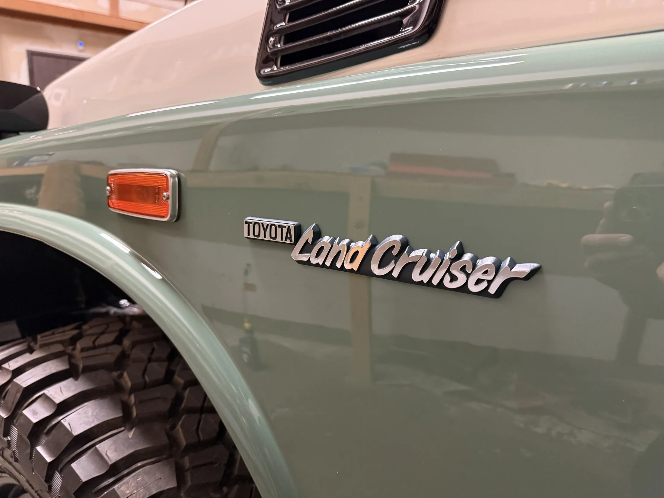

I use Ogden Chrome and never had an issue, YMMV.

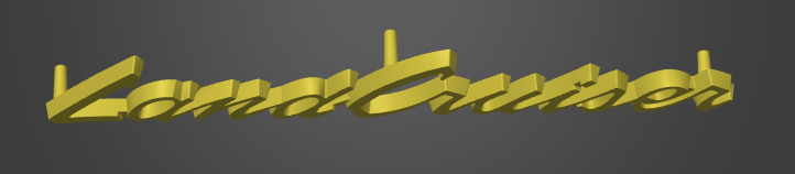

To your point of looking original this is not a great plan "A". If you're able to cast the script after shrinkage it will be different hole spacing and it will be bronze not chrome plated...
So if it where me and I was just trying to get something on my fender that looked appropriate I would use the file I provided and get it printed in plastic and use one of the many inexpensive "chrome" looking coatings.
There are many but this is the first to pop up on my search.
If I wanted to have an ultimate cool badging for my show pig then I would send me a PM and I'll machine you some out of brass and send them to Ogden Chrome and have them do their show plate. Either way if one couldn't be found on the secondary market we have options to make them.

As do I but that's not what you originally implied..
You left us with the impression that Chrome plating pot metal was a lost art and near impossible to have done anymore and that's just not true.

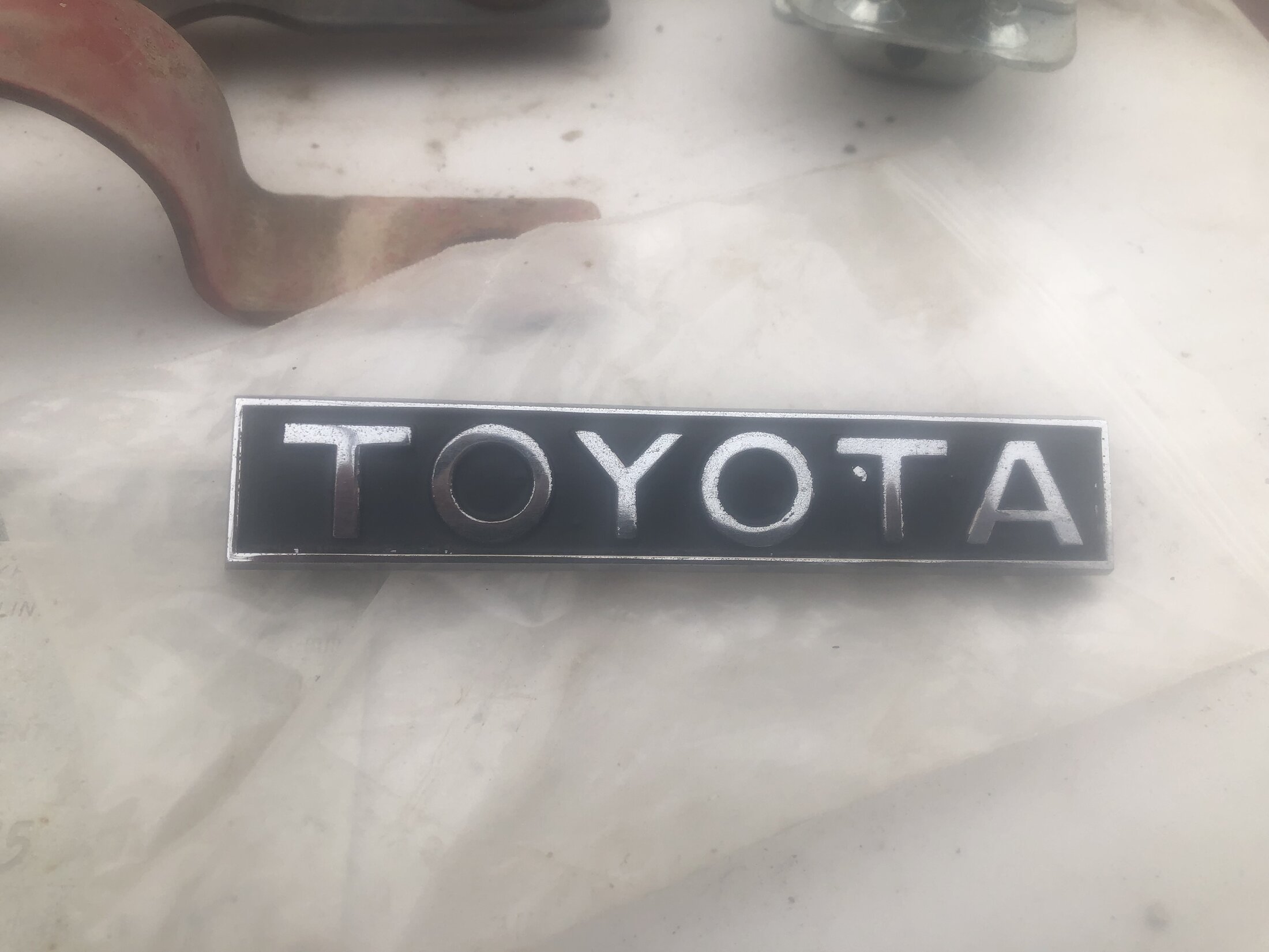

Your highlighted number is not the actual p/n. See my post above with actual p/n's. That may clear up some confusion.
That might have been the part numbers in the early 80s but not today.
So, the 74 and newer 40 emblems are different than the 55 series. Is that what I just learned? I can see the older ones are, but just by 5mm or so for the newer.
