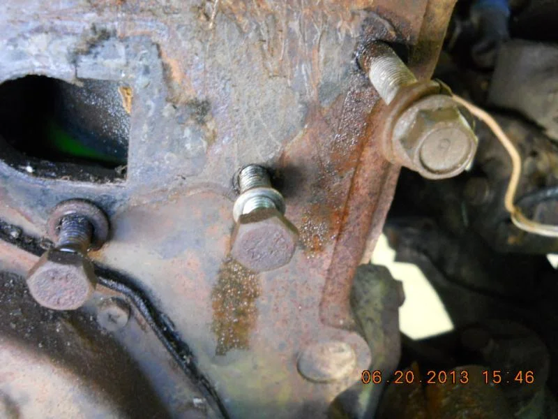

water pump bolts.webpI looked at the disassembly chart and made sure that I took out 15 bolts. On a different note. See photo below of the water pump bolts that I screwed back into the block. IS the upper right bolt the correct one? It is the odd man out of the bolt set.

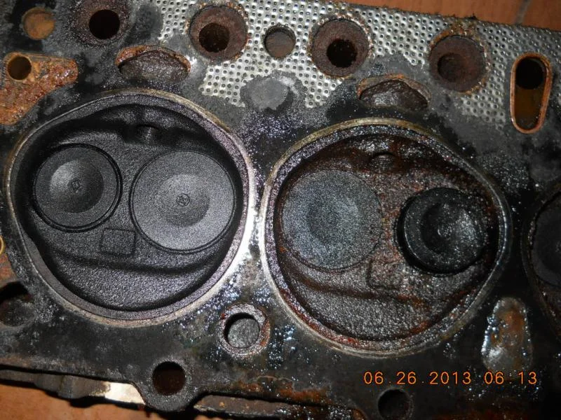

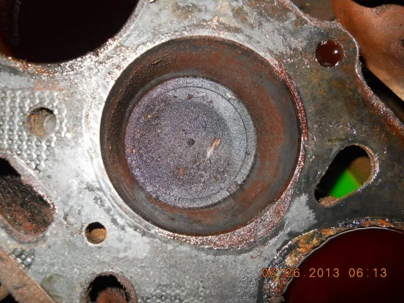

its been a rainy night in Georgia....I filled the holes with transmission fluid and lacquer thinner to try and break the pistons free. it looks like three of them are the culprit. I took the head to the machine shop. They said it looks like the head gasket was blown when it was parked, which would explain why the rust etc in some of the cylinders. I am going to assess the head. If it doesnt need much work to be re-worked, I am going for it. I found a machine shop in Utah that has an entire master rebuild kit including cam for $1100, less the oil pump. I can get the block bored for $250. I am leaning that way. What do you guys think?

That's on the shy side of what estimates I'd be given awhile back and know there's nuances to this particular blocks machinable material, but Pighead or Ige will be much more in depth with a reply regarding, I'm sure.
