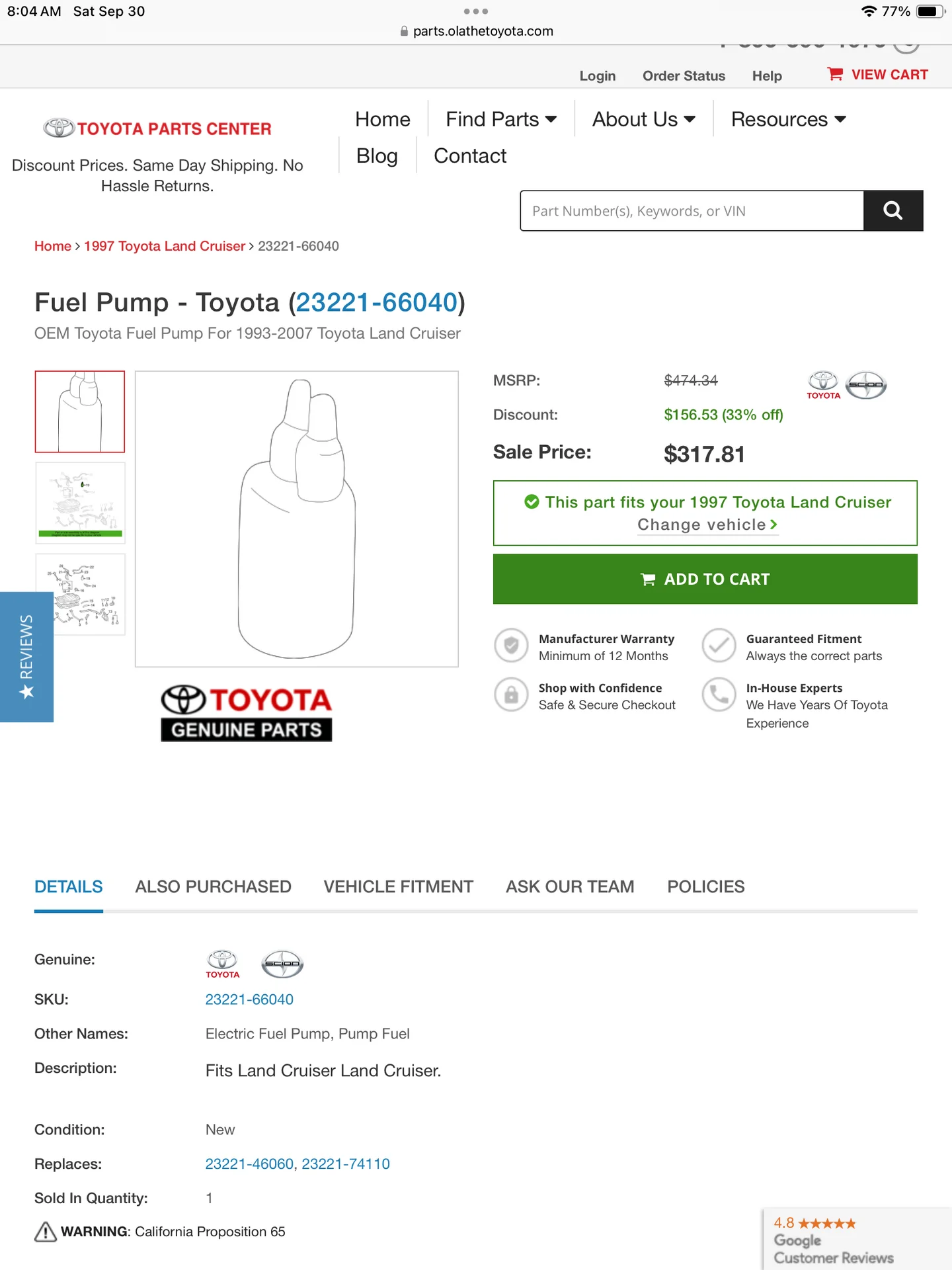

I’d go with the OEM pump for something this critical. Olathe Toyota has it for $317
Shipping to Alaska of course additional.
