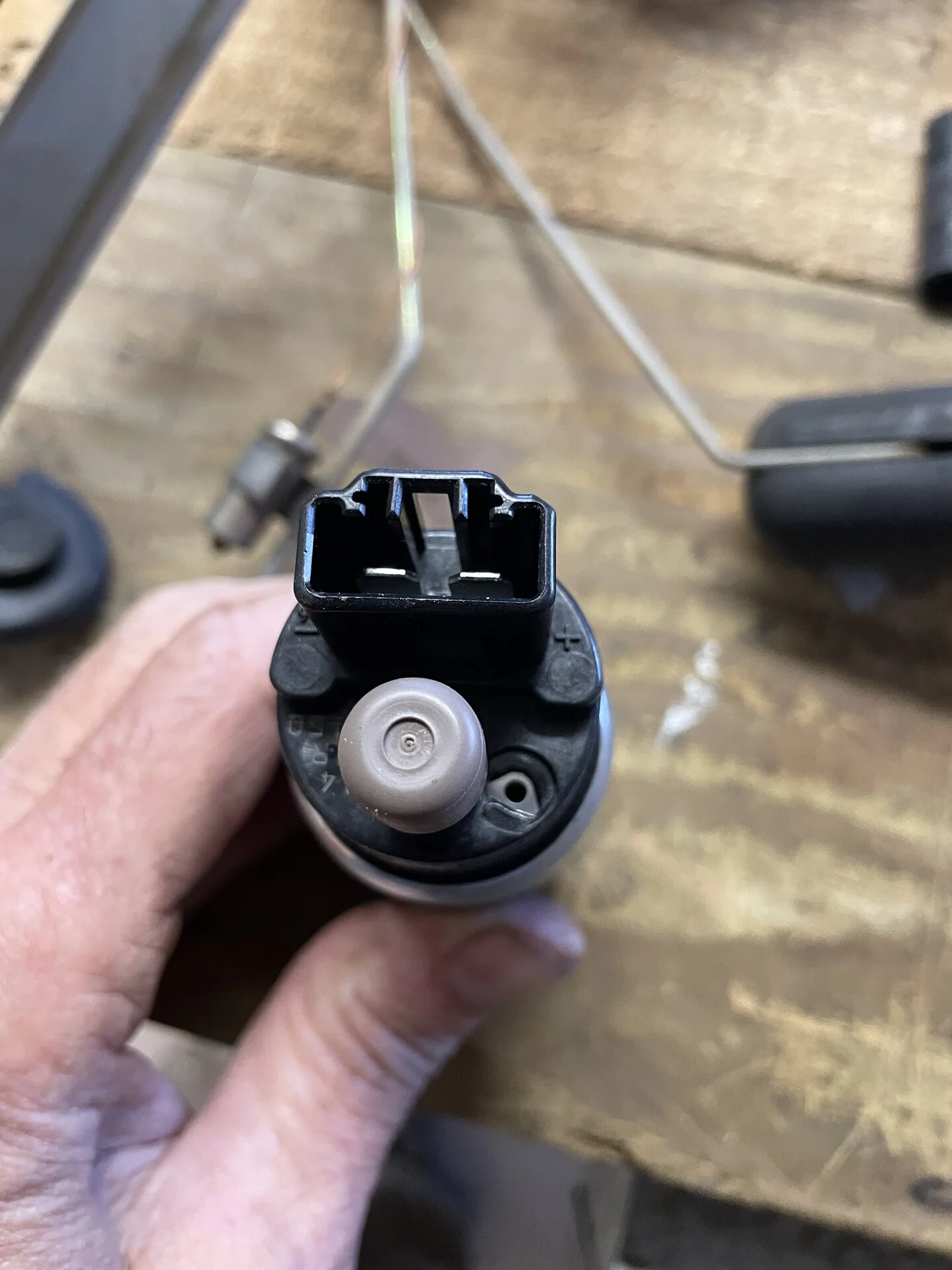

I bring it up because I’m changing my fuel pump. After 24 years and 300K miles I thought it would be prudent, and easy to do.
I bought a Denso replacement pump. When I got to it I found the Denso to be shorter than OEM and would require me to rewire because the connector plug has different pins.
So, I don’t mind the spend on the OEM fuel pump. Let me know what replacement pump, if any you are using.

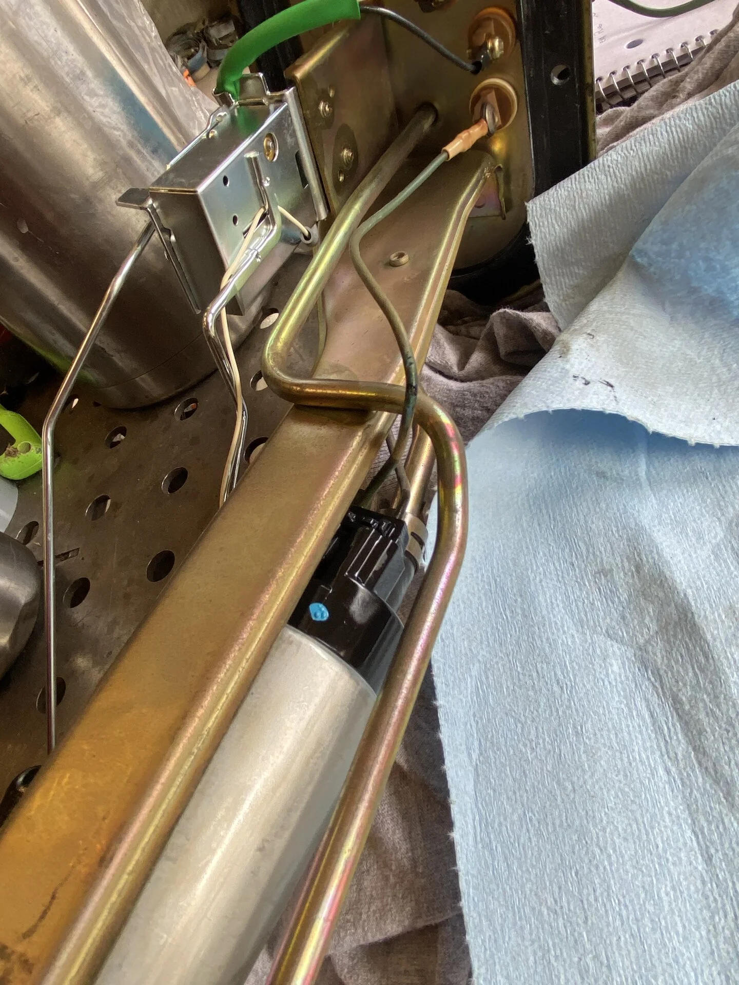

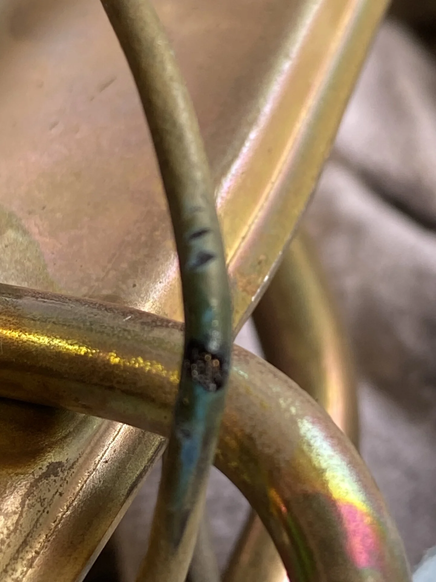

I went with OEM, installed it about a year ago, then while out hunting, my 80 stranded me for the first time. After getting it home and searching for the direct short (EFI fuse kept popping), turns out the sub-harness that connects to the fuel pump, was pinched between a fuel splash baffle and pick-tube. I repaired and rerouted it. Luckily I had a Toyota mechanic friend talk me through diagnosing the short over the phone.

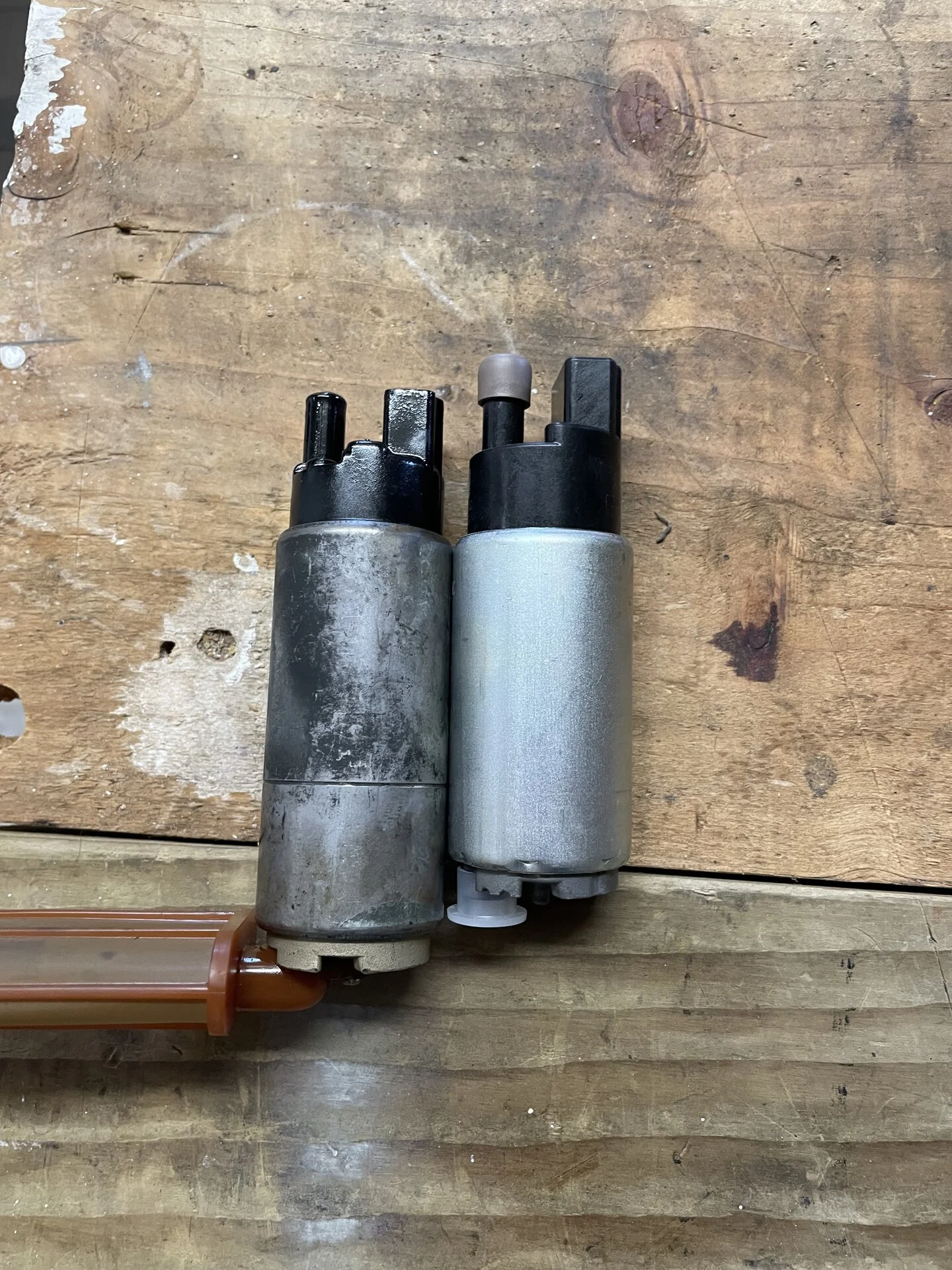

A month after ordering the Denso I ordered Delphi via Amazon. These units are made in Japan, I believe. Go figure. The Delphi is also shorter than OEM but not so much that you can't plug it in. Before ordering the Delphi I bought a pump from O'Reilly's that was said to be "plug and play". It was not, the electric plug wasn't compatible.

The Delphi FE0204 seems like a good option at half the price, and if it’s really made in Japan thats a bonus. What I understand is that the Delphi is shorter that OEM (like in my photo above) but is not an issue?
Correct. The shorter length is not an issue. The electrical plug wiring is long enough to reach without modification.

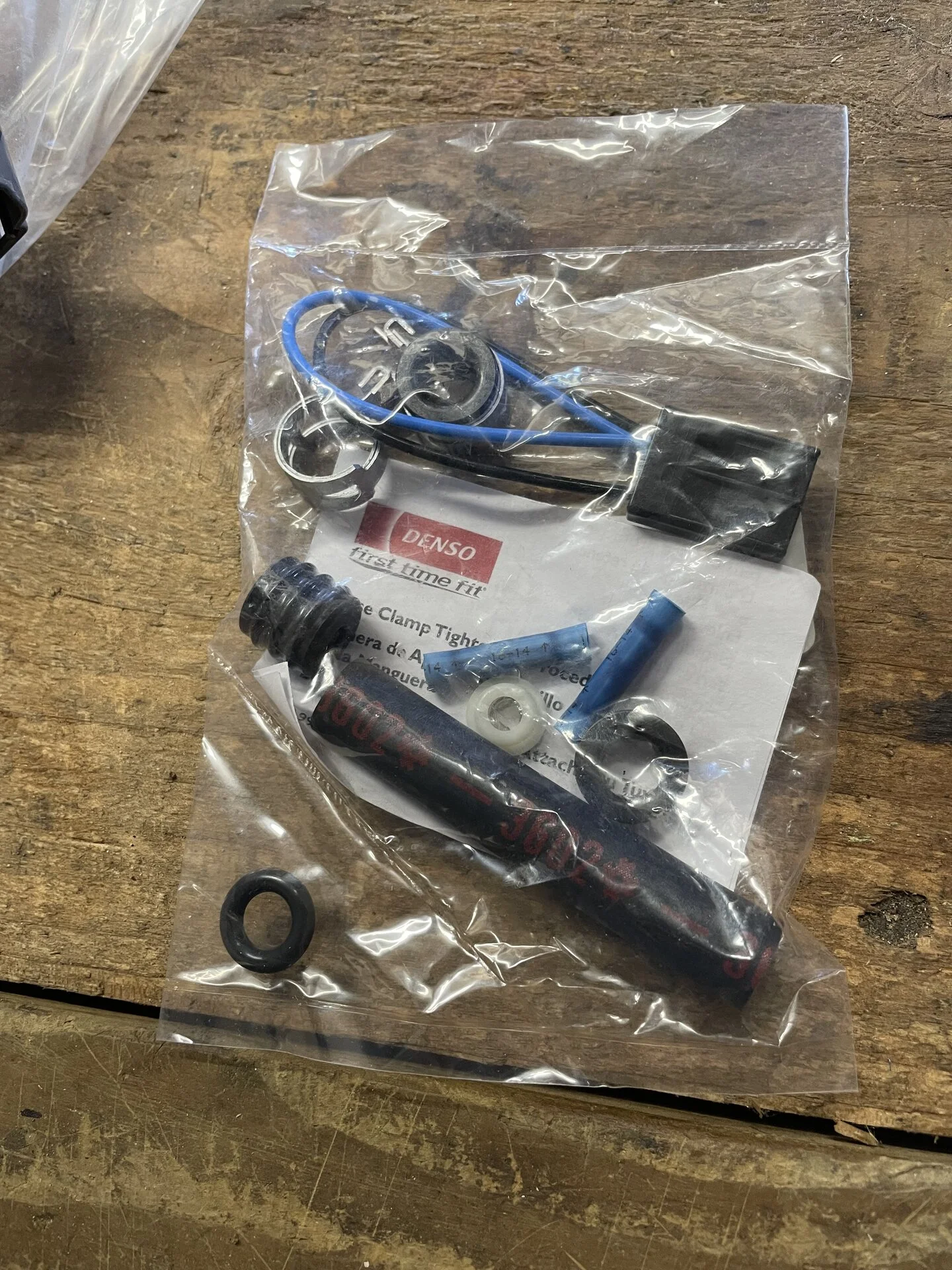

A few of the LS swap folks have used Denso 950-0266 ( me included ). order on Amazon right now for $115. Pretty much plug and play for a FZJ fuel tank pump. Buy 3 for the price of OEM😁!
For a V8 4Runner.
For a V8 4Runner.
I did the same. If I remember correctly the plug from the old pump had to be swiched to the new pump. Other then that fit like OEM.
