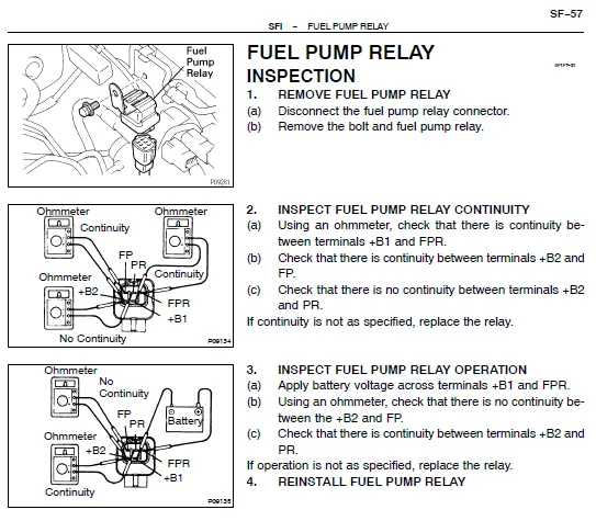

i missed earlier that you said you had a Lexus. I was looking at the LC EWD b/c that's what I have on my computer. But looking at the 97 LX EWD, it shows the same schematic for the ECM and FP Relay. Relay pin 1 is connected to the ECM, which is the collector of a NPN transistor. the emitter is grounded. they don't show what is happening to the base. my elementary understanding is the transistor is being used as a switch, based on the conditions Toyota doesn't specify.
the relay tests out using this from the FSM?
As long as the circuit opening relay is closed, I was expecting to see FPR alternate between ~12V (pulled up through the coil) and ~0 V (maybe 0.6 V, pulled low from through the open collector output from the ECM).
hmmm. i dont think the voltage the fuel pump sees is changing, but instead the current is being changed by the 0.73 ohm resistor. no?
Yep, my relay behaves as described in this diagnostic test, and also as shown in the schematic earlier in the diagnostic section of the Lexus FSM. But it’s worth noting for anyone trying to troubleshoot this system that both the Toyota and Lexus Electrical Wiring Diagram schematics show the opposite behavior between pin 2 or 3 being the normal connection to pin 5. The actual behavior shown in this diagnostic (pin 5 and 3 connected when unpowered, bypassing the resistor) is the correct one, but it was confusing at first trying to start from the wiring diagrams.
Sure the current is being reduced, but since the fuel pump resistor and fuel pump in series set up a voltage divider, a quick diagnostic while running was to look at that voltage running fuel pump (e.g. tapping into pin 3 of the relay or other side of the resistor - line that goes to power the fuel pump). While probing there low speed mode shows ~ 9 V and high-speed mode ~13.5 V (full battery/alternator voltage). I was able to jam a sharp probe tip past the rubber boots around the wires entering the connectors.
