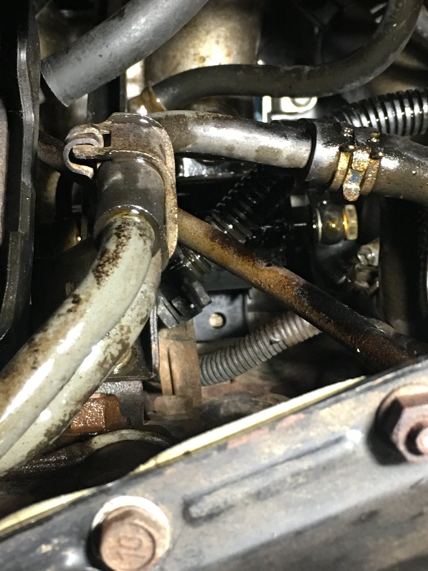

Here’s a photo of my one bolt-mounted Chinese fuel filter...you can see the filter bracket didn’t quite fit, so the guy just said screw it and left it with only one mounting bolt...

Oh, and you can see where that Chinese filter bent when I was disconnecting the fuel line. Cheap. I have no idea who put that on or how long it was on. I don’t have a record of that being done.

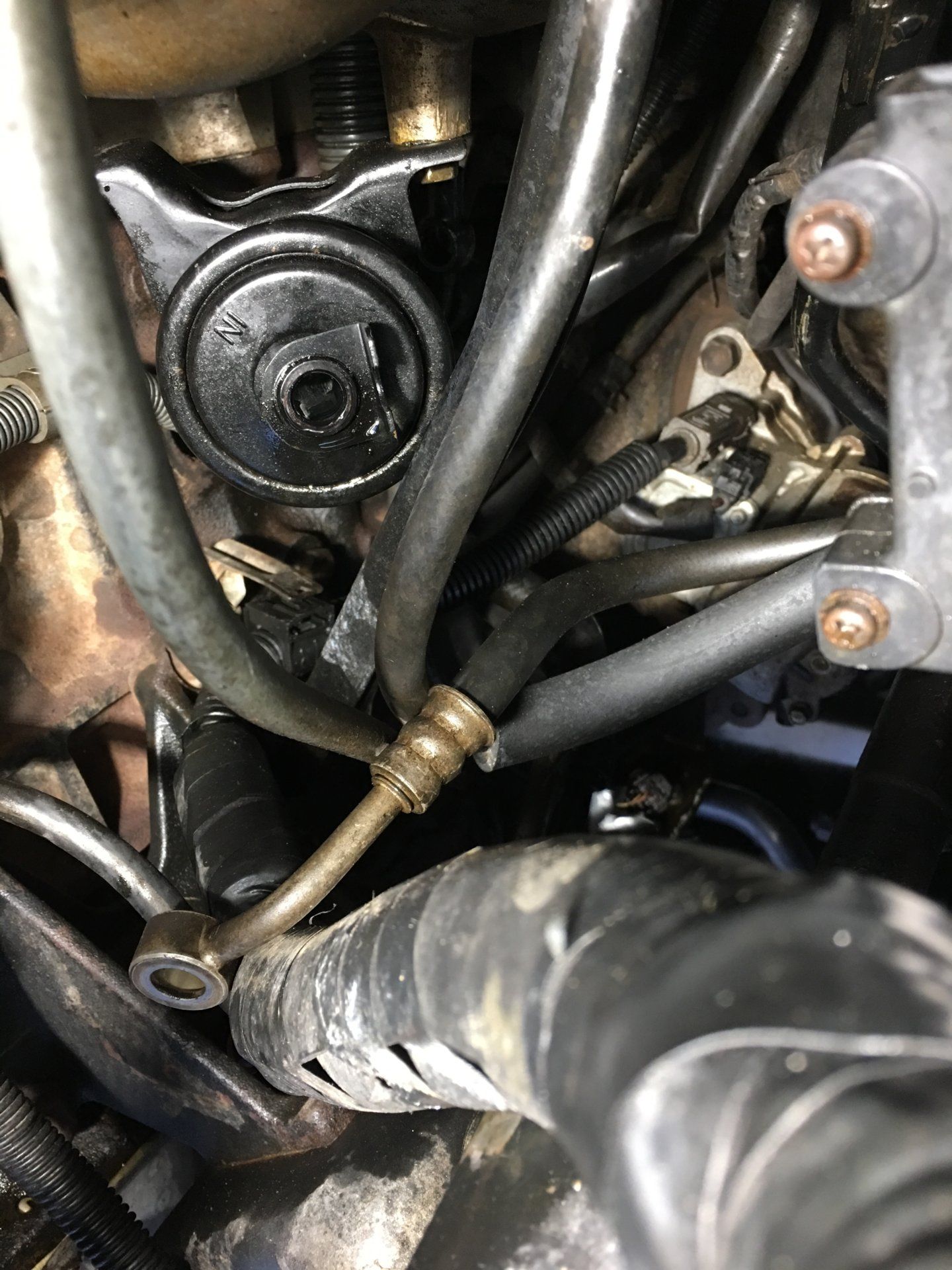

Photo of the new Fuel Filter with the front Union Bolt torqued down before mounting the filter...

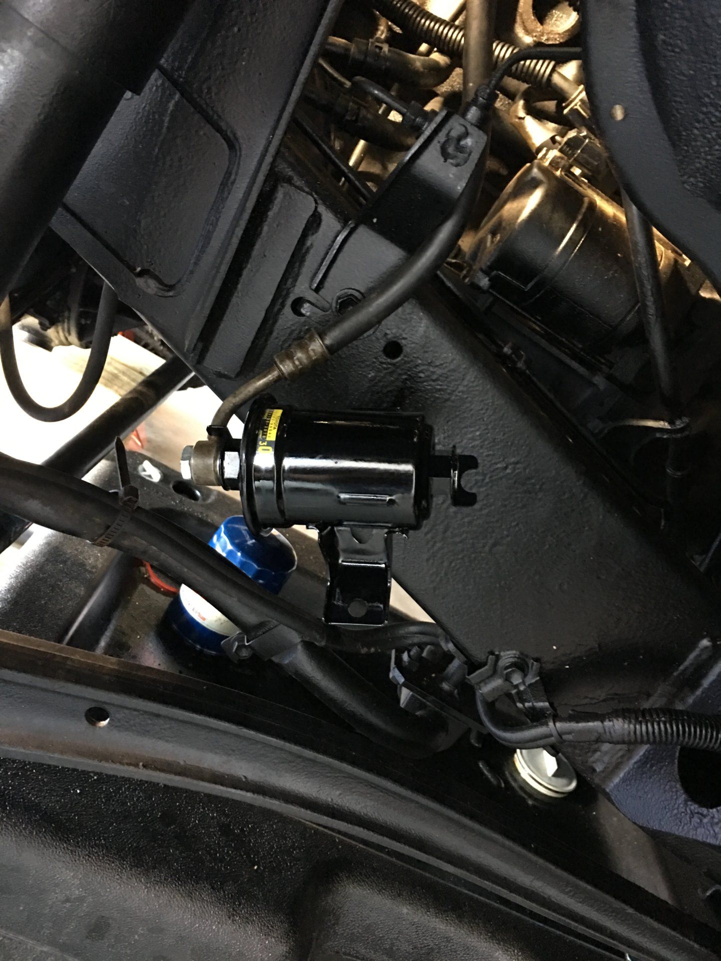

Photo of the socket extension setup I used to mount the filter, accessing it from underneath near the oil pan...

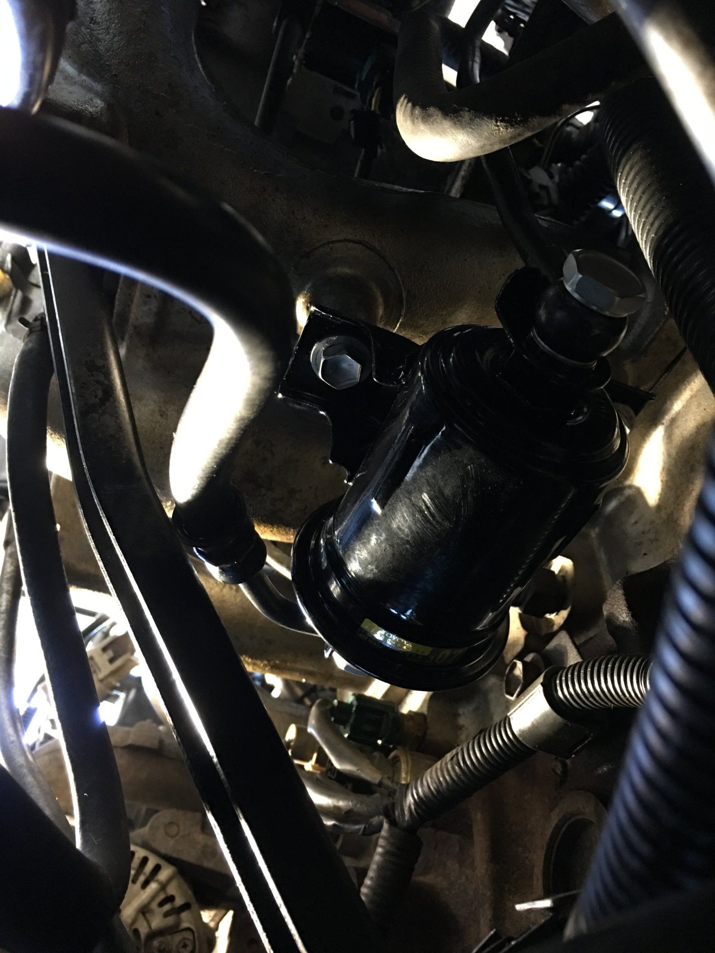

Success! Properly mounted and torqued OEM Fuel Filter...
