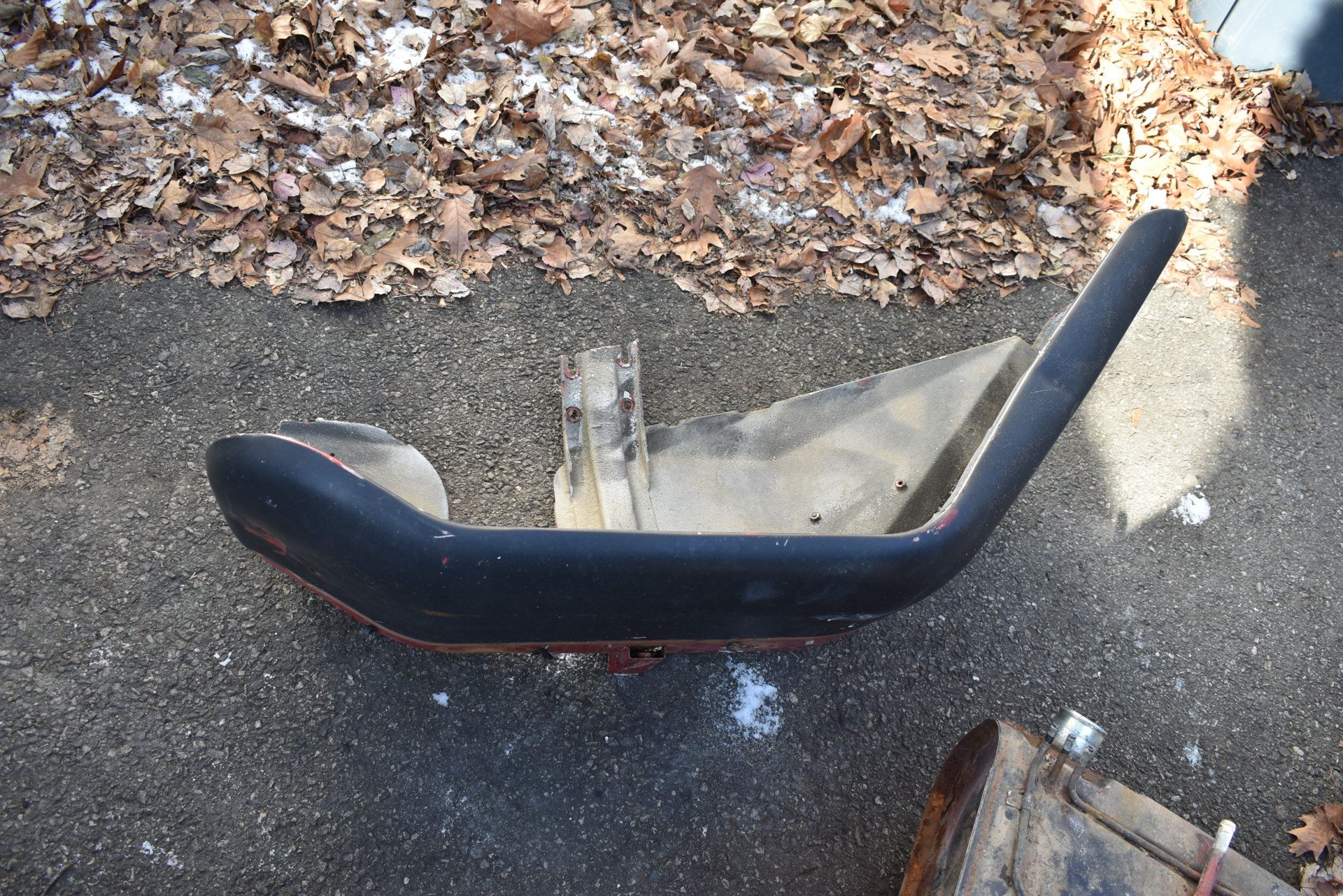

Hi Folks -
I've got the typical rust on both front fenders... other than the normal rust and a few dents that could be persuaded with the right size hammer, they appear to be in good shape (no appreciable filler). Trying to figure out whether or not I should attempt to repair them or replace them? Of note, they are rhino lined underneath if that impacts your view??
I would have already replaced them with aftermarket steel but the shipping charges seem outrageous! Thoughts on level of effort to repair are appreciated (FYI I have a welder and have done a backyard paint job in the past though I'd prefer to never do one again!).
Here are a few shots of both sides:

What year is the FJ40 ? If it is later than the mid 1970's , they were very prone to rust and repair may just be chasing forever. You can try , but as you dig , you may just buy a new fender somewhere.
Still alot of good steel to work with here. !st of all sandblast them to see what may be hiding

1978, exactly when the rust monster has arrived. Could be earlier, but my 1969 fenders are still as they were. You can research this on here and see that as years went on , the steel changed and in the rust belt areas things got worse.
Anyway, you can blast off to see what you have as varty says, and then decide if the cost / value will allow repair.

My original '78 front fenders were worse than yours. In my hast, I ordered CCOT fenders.. painted them... then went to mount... didn't fit right. I eventually repaired both OEM fenders and re -installed them. Should of just repaired them from the start.
Either way you need paint so that will not be a discussion.
A replacement fender will need tweeking on a 40 year old vehicle so you can expect work to make it fit, even more with after market fenders.
When you leave the fender on the 40 when cutting out the bad parts, replace one part at a time, the allignment will not be a problem. You can use a piece of angle iron and clamp it over the cut out during replacement to keep the edge straight.
Just weld slowly and hammer each time you have made a few tacks as they will pull the gap.

Just to add to what Michael said. I repaired our 75s fenders but I'm no expert by no means. I went as far as taking the support bracket off one of them, to make sure it was as clean as possible and to repair the support. Just make sure when you take it apart that its marked well, the fender will flex in that area also when its support is removed. Might tack a piece in before taking it apart then finish the back side while its off. If you go that route.

The tricky part is getting that fender support out of there, and take measures to ensure to seal that area and reinstall. I assume that that's where the rust originated is on top of your fender support.
OP - Those fenders are totally fixable and IMO should be fixed, if not by you then someone else - whatever you do don't toss them. Suggestions above are spot on - drill out spot welds, cut out rust, patch with appropriate thickness new metal, grind smooth, rust proof and paint. I have a set from a '78 FJ45 with the same rust issues that I will be fixing for my brother's '71 FJ40
But, new OEM fenders are out there. I just bought a set from Steve at EBI Cruisers last summer. They run about $350ea (Canadaian Funds). I paid the same price ten years ago for a new set as well.
I would totally fix those fenders. Use a cup brush on a polisher to remove the rhino lining. Remove the fender support by drilling out the spot welds and remove the underside signal bracket by removing spot welds.
This! Once you hit those spots with a wire wheel you'll know just what you're dealing with. Much easier to repair that vs purchasing an aftermarket fender and massaging it to fit as it should.
