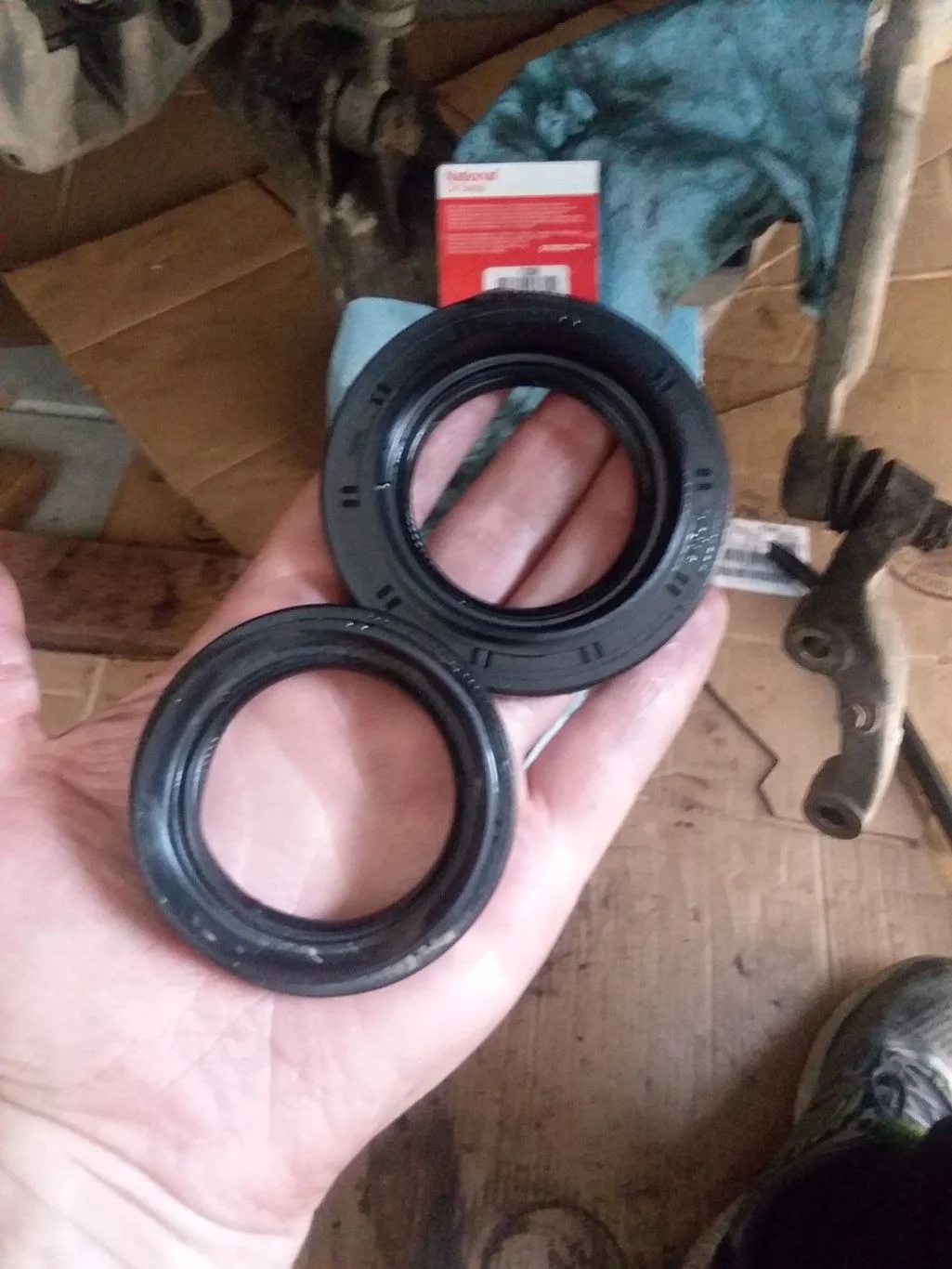

yes the passenger side is much smaller for some reason.

yes the passenger side is much smaller for some reason. View attachment 2274382
