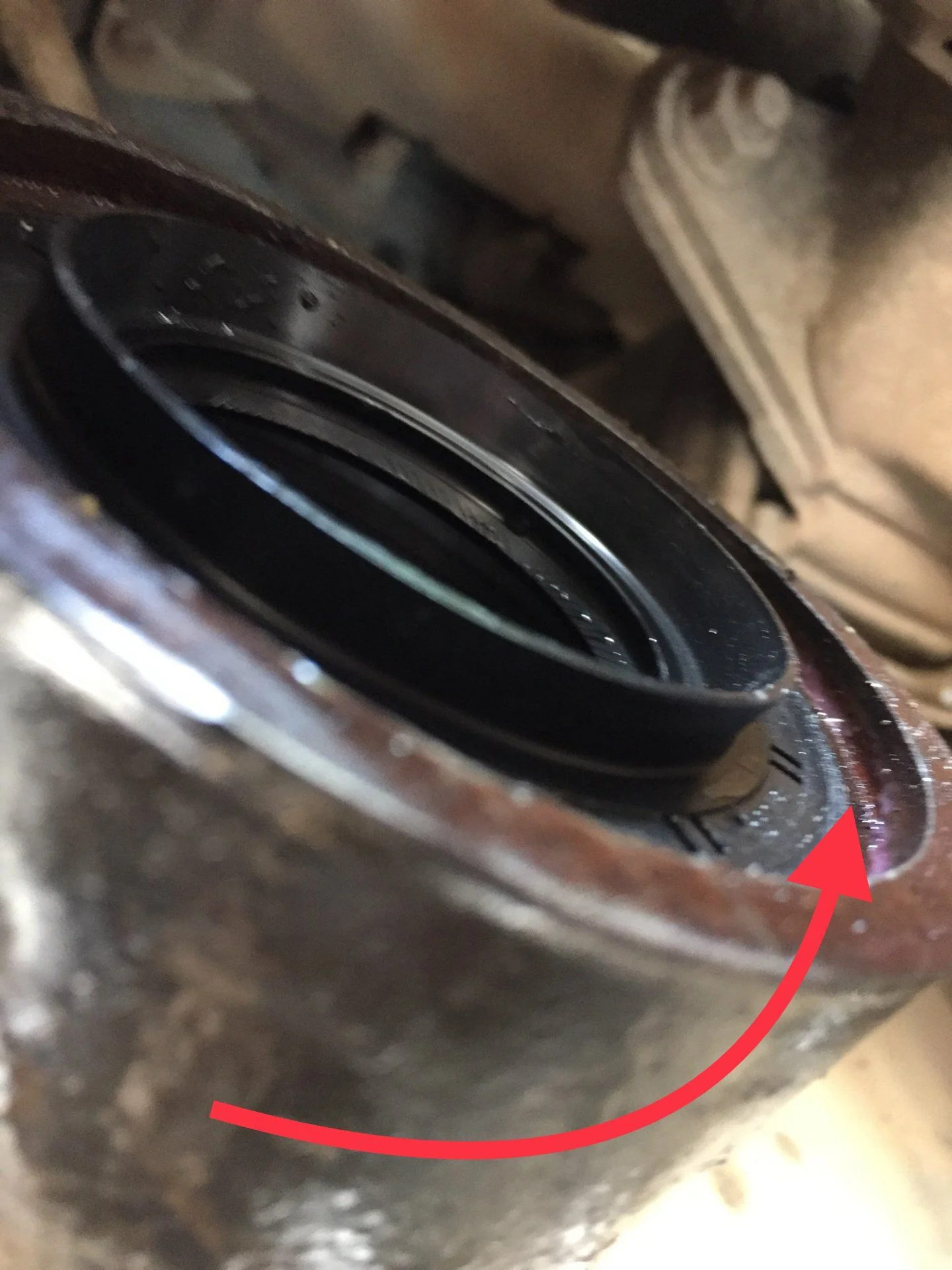

Your picture looks to me like the seal is in backwards?
Did you leave it pushed in that far?

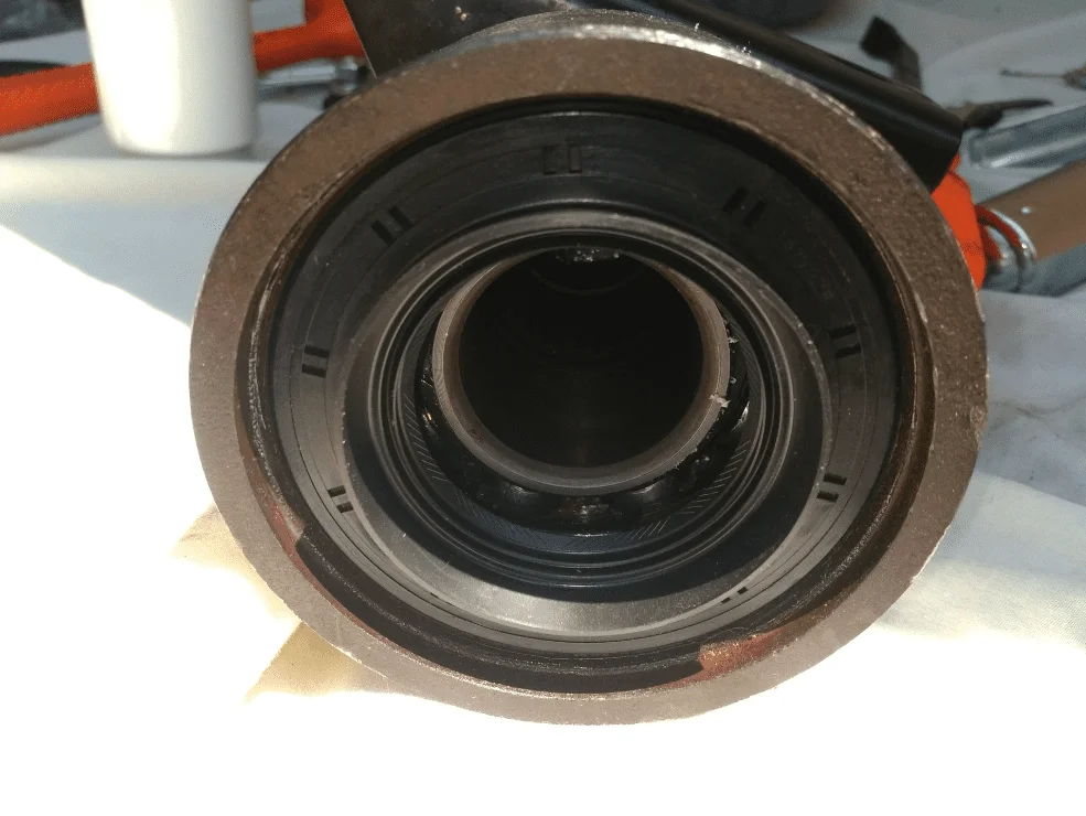

This one doesn't leak.
Hmmmm...
That’s what mine looks like, I thought it was perfect. Except mine weeps just enough to always have a drip formed on the bottom of the diff housing. Never makes it as far as the garage floor though and it’s always still full when I check it. Drives me bonkers though.

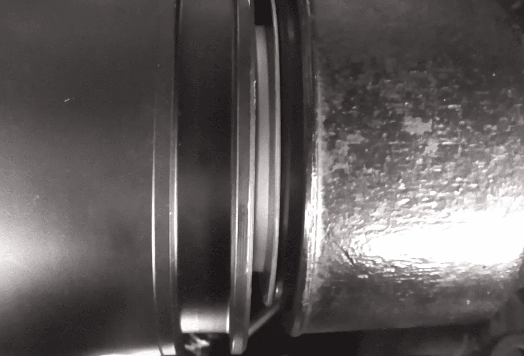

I managed to snap a picture of the CV axle outer flange mating up with the dust cover rim.

Thanks for the pic. I’ll check on mine tomorrow. It’s the passenger side for me.

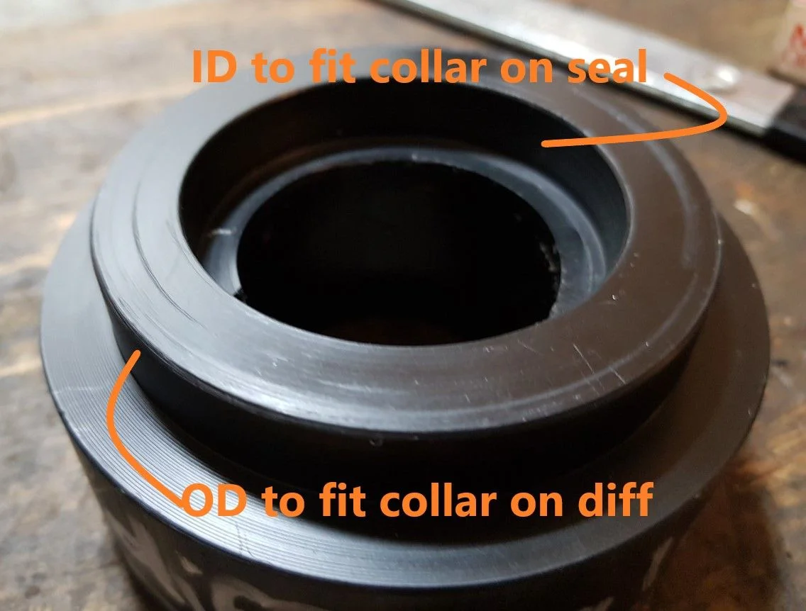

Made a simple bushing to help with the install of the seals. The bushing fits over the lip of the seal and you simply tap it till it bottoms out on the shoulder of the differential. That way the seal will be square and never over-driven. It was machined from a piece of plastic but it could also be printed. This was for a GX, but same concept for a 100.
