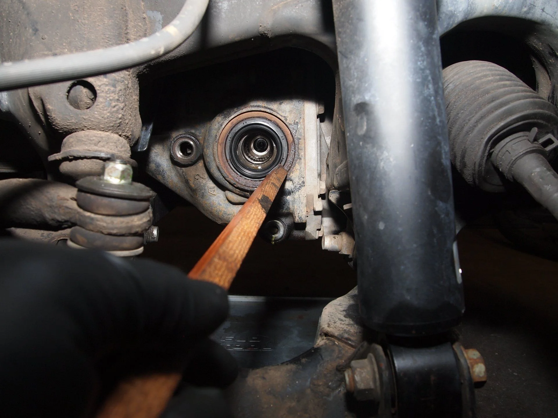

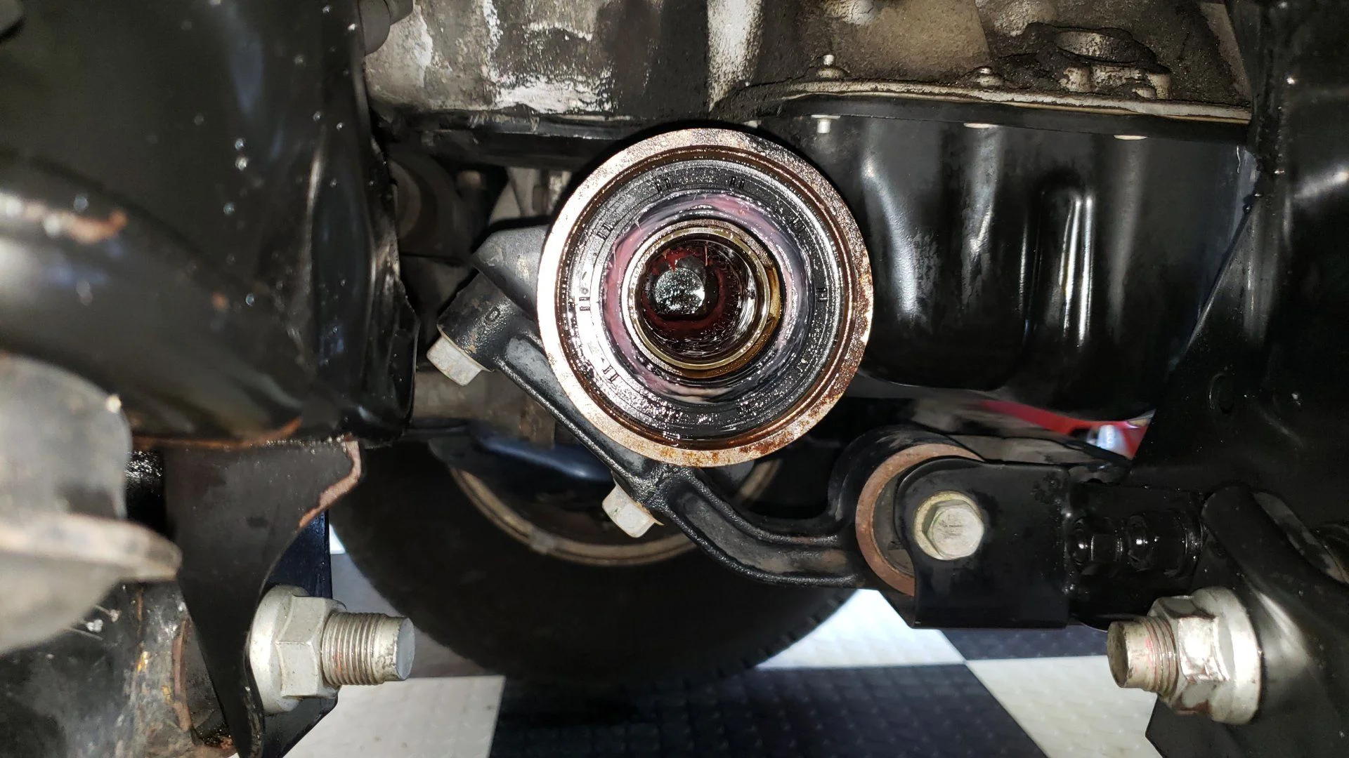

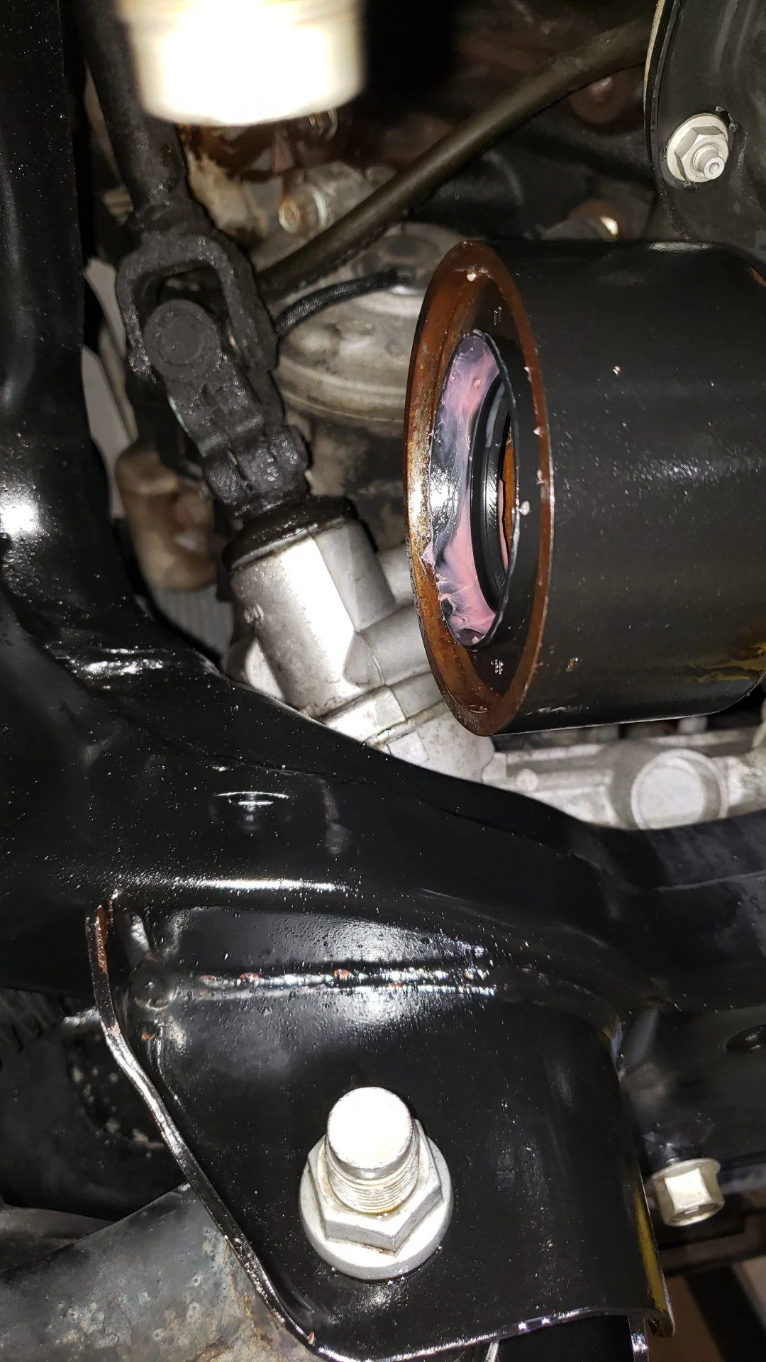

Picture #3 shows it’s not installed correctly. Seated in too far on top. The flat face of the seal should be even or (just slightly raised past it-)with the recessed edge of the race- and evenly pressed in all the way around.
Also, tube looks a little crusty. Did you clean it up under where the seal sits?
But yeah - crooked seal is #1 culprit I see.
Yeah, need to clean that up a bit I think. I just knocked it in. It's kinda a PITA to install right.
If you read through the thread. You'll see, that seal can be levered out, to square it up.

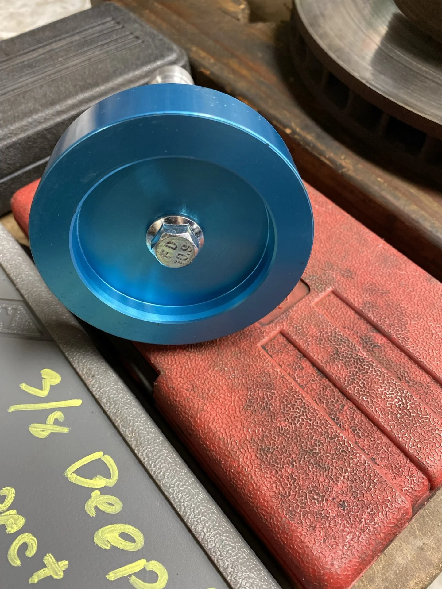

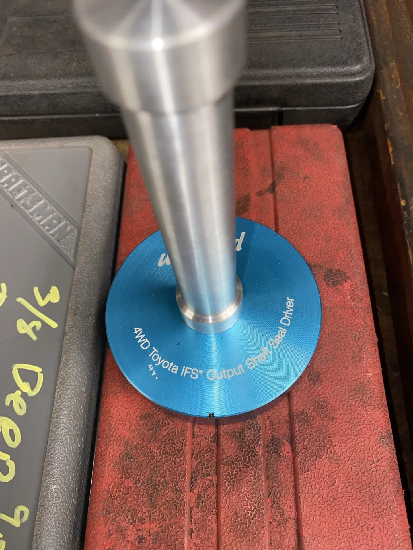

These days, I use a seal seating tool Joey (@NLXTACY) at Wits'end designed & sells. Works very well!. Saves me about 20 minutes per set of seas. Fits both side of diff., both seals and seat perfectly every time and is faster. Provided one preps surface of diff. first, by scraping any crud, rust mud out that may keep tool from seating flush to target surface.

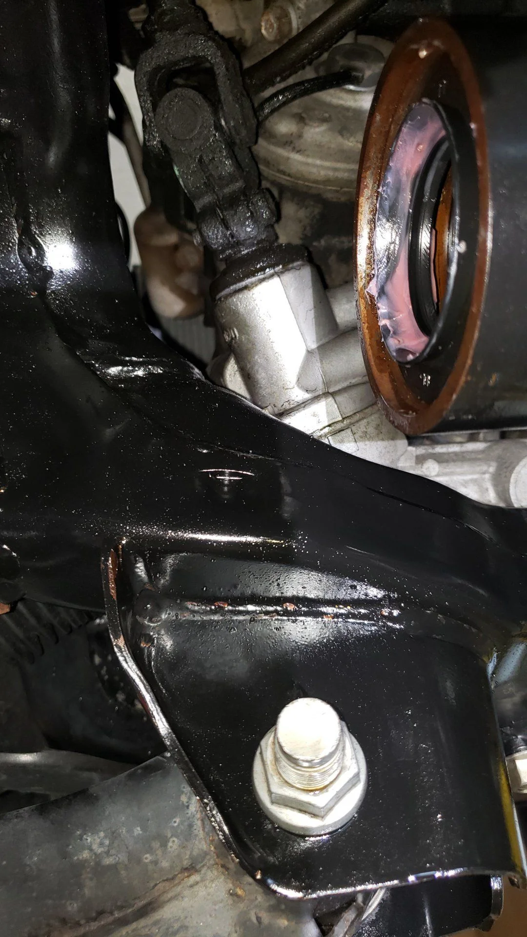

Do you leave the entire lip/skirt of that seal "proud" of the diff face?
