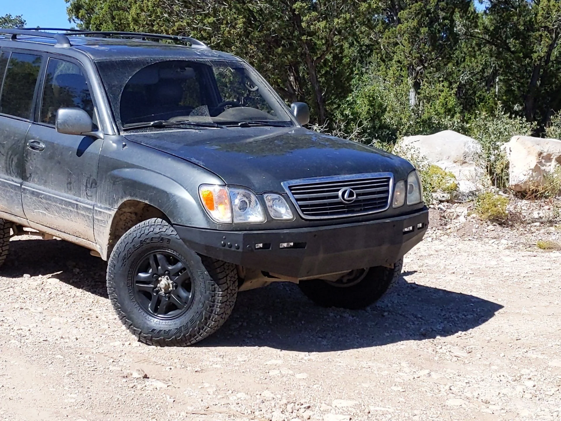

I built this bumper last year. Made from 1/8"x6" strap all cut with an angle grinder.
Nice job. That bumper looks great!
