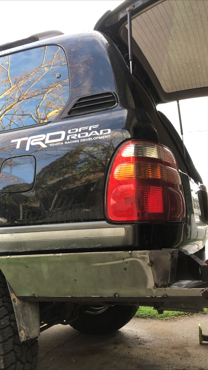

I’m currently doing this but with a rear bumper. If you’re like me and don’t want to drop dough on a compressor and plasma cutter, a used 6” Milwaukee deep portable bandsaw (~$100) will do most of the cuts you need and a million times easier than an angle grinder. I have my local metal shop cut the big pieces/strips I need to width, it’s something like $1 per cut (can’t exceed ~8” wide for my bandsaw) and the rest of the cuts I DIY.
Very rewarding but if you factor your time in it’s cheaper to just buy one 😂

Cool! I watched like million other videos on youtube on how to make them. I just upgraded to very nice air compressor last year so it's not a problem. And, seems like $160 plasma will work. So, it's not much different from portable band saw.

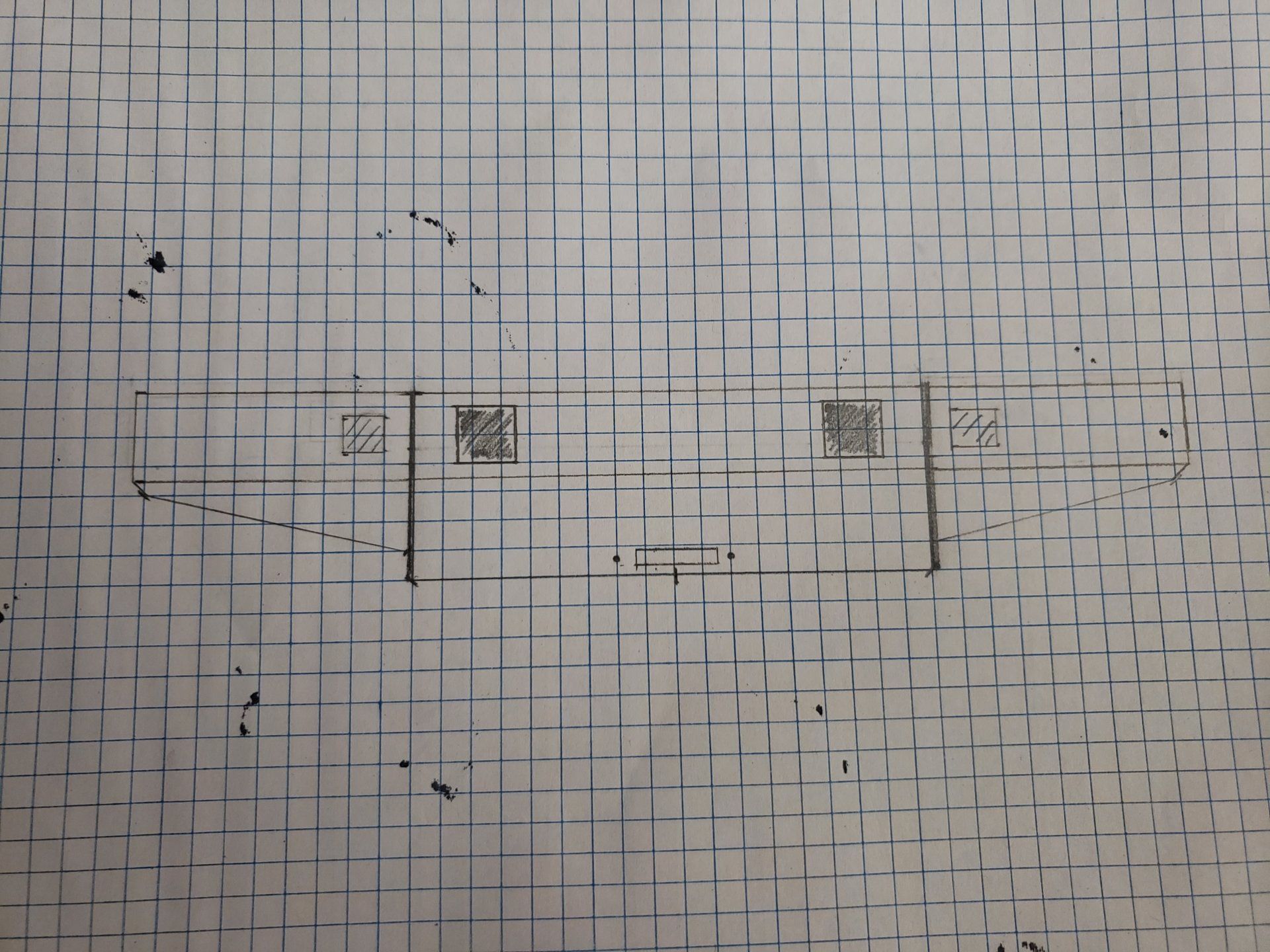

My drawing. I'm gathering metal...
Why so deep in the center section? What’s your scale? 1 square = ?

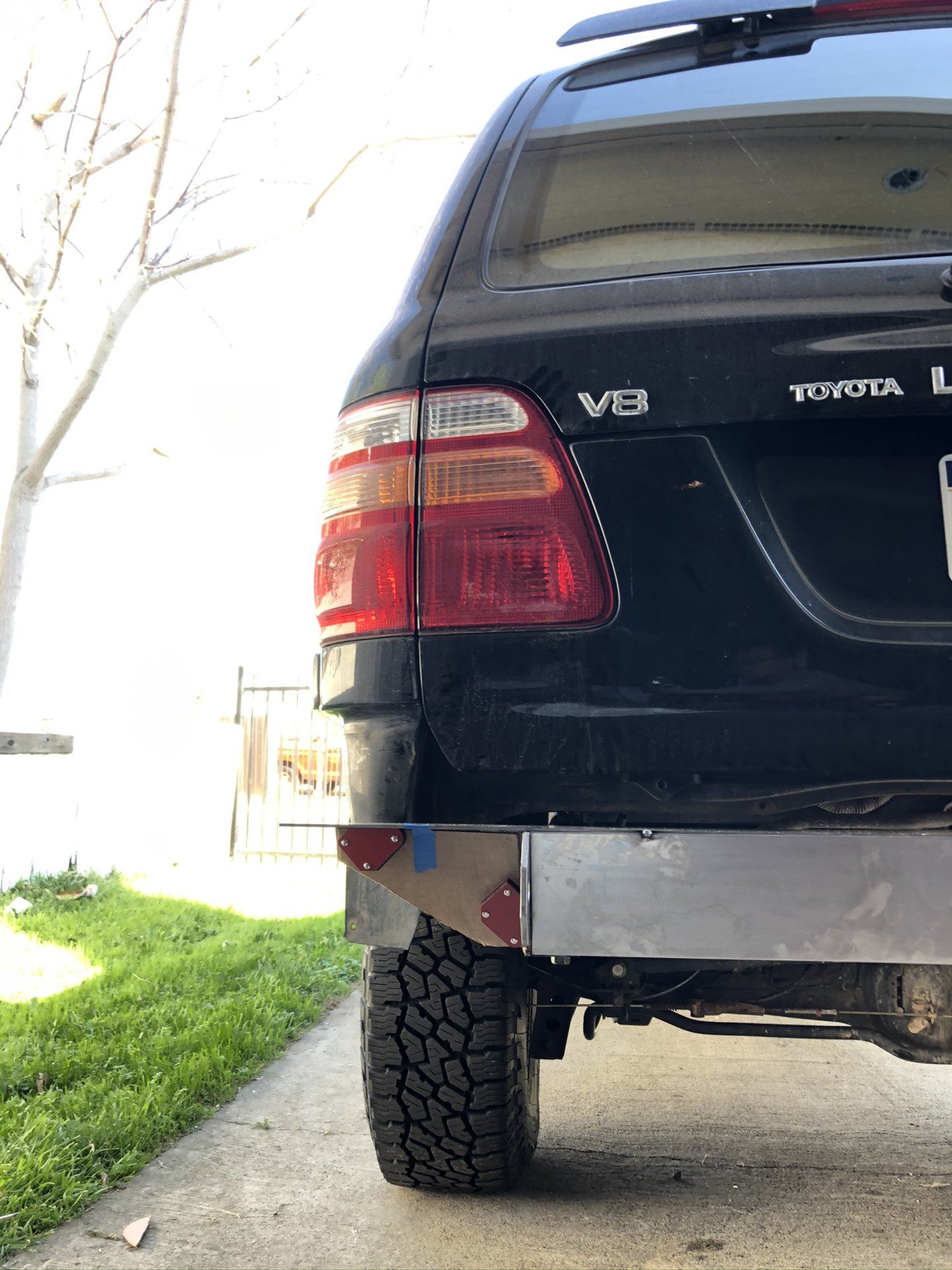

1 square= 2". The center section is at the bottom of the frame horns, although, I chopped them and moved it up about 1.5". He's my beginning mock up from last night:
Holy $&!# Mauser 6" strap! That's really impressive!
