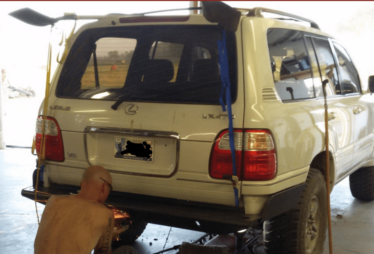

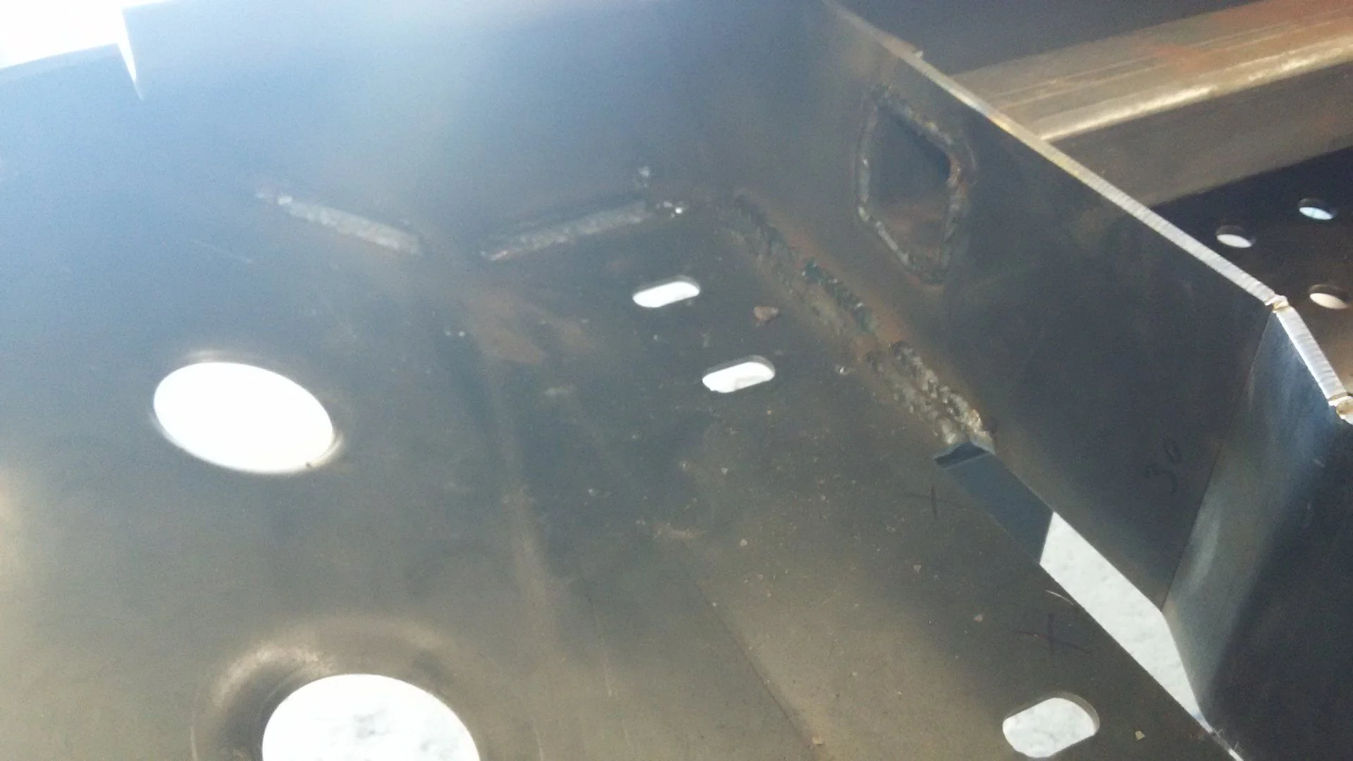

A few of my rear build
I beefed up the receiver a bit. One shackle arm hole had to be moved a 1/4". Overall the kit is awesome and went together well. By far the hardest part was fitting the wings on the main rear shell. Definitely have another hand on site. Grinding stones, cutting discs, and a torch handy will aid in assembly.

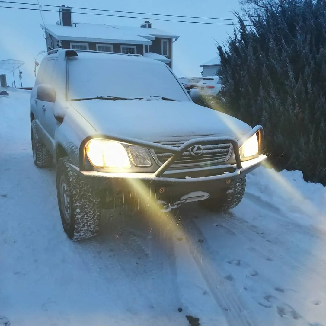

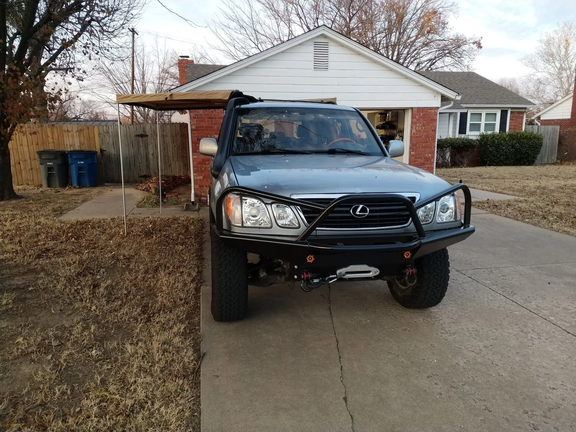

Sorry guys, when it warms up I'll snag some detail pics. So 4x4Labs lower, local shop MEO helped figure out and built the hoops. We took the provided 'stinger' and turned it OUT pointing straight fwd and added light mounting tabs, then angled a larger middle hoop out to the same length and made side hoops that line up with the headlights. I love it.
