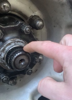

Hey guys, a friend of mine who is a bit handier and more mechanically experienced than me helped me out with a passenger’s side rebuild which went really well. We used this kit from Repco here in Oz https://www.repco.com.au/en/parts-s...s/maxi-trac-swivel-housing-kit-sh6/p/A7862938
The one remaining issue I have, which I think was present before and might be unrelated, is that I have some sideways axle movement, & I haven’t been able to find much online about that. I believe I can’t post videos here but I’ve tried to show it here in these 2 pics. Despite siliconing the dust cap on, the axle movement of about 2cm or so has been forcing the cap off occasionally.
The axle can then be nudged back in pretty easily. We’re still in covid lockdown in Victoria here with a 5km limit so I’m not driving much, I’ll take it to a mechanic eventually to check it out once we’re out of lockdown. Any thoughts on what could be causing this in the meantime?

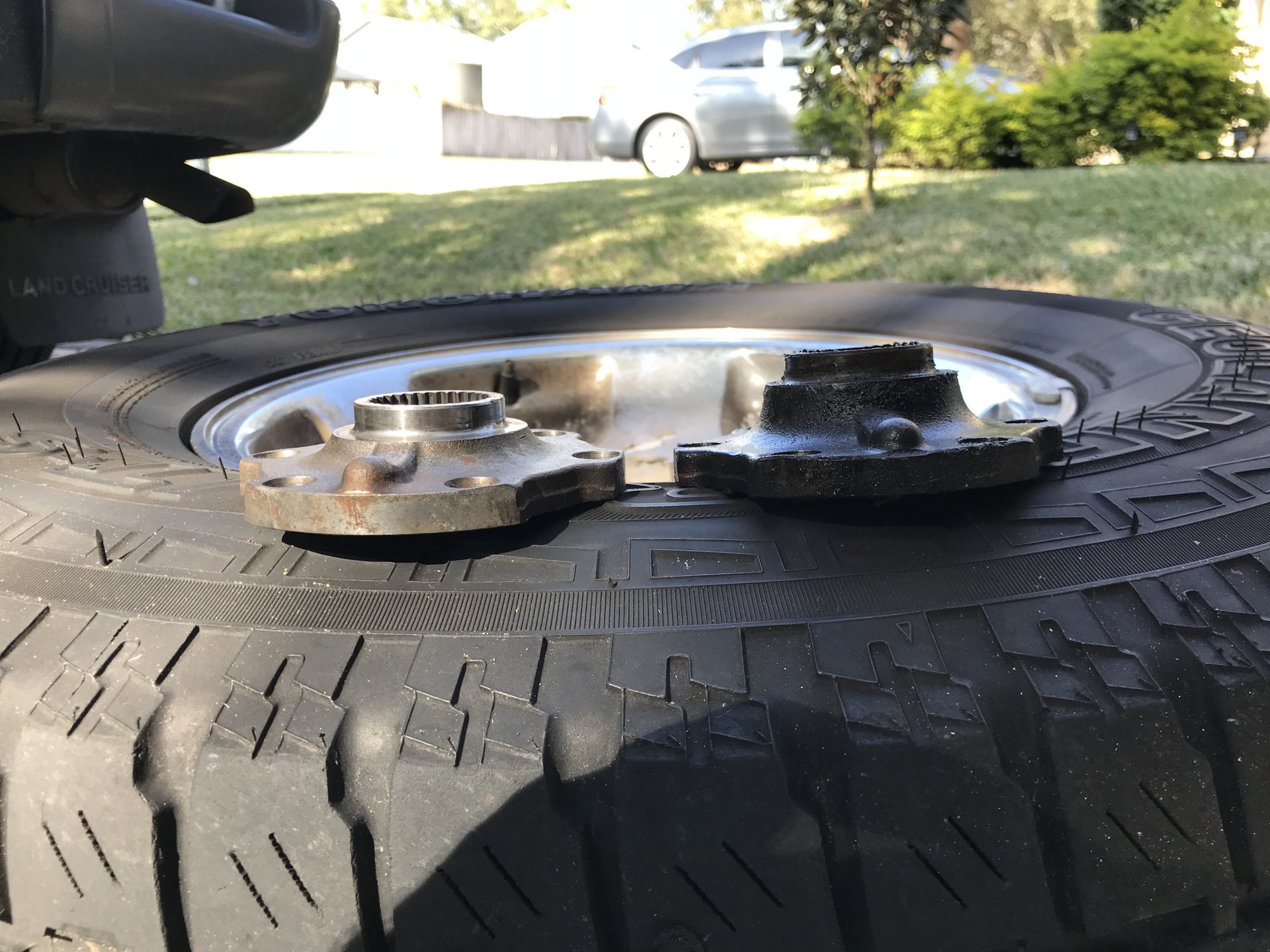

Your using an older and weaker style flange found on 93 and earlier cruisers. You need a new flange or get the cock ring from wits end to fix the gap @LooseCruiser
43421-60020 is to the left, found on pre 4/1993 fzj80s (achilles heal) and then they replaced it with 43421-60022. If you want to keep the older flange because of money issues, you will need to get the ring but its best to just get the flange since you clearly have a new birfield.
80 Series Birf to Flange Spacer-8mm - https://absolute-wits-end.com/80-series-birf-to-flange-spacer-8mm/
