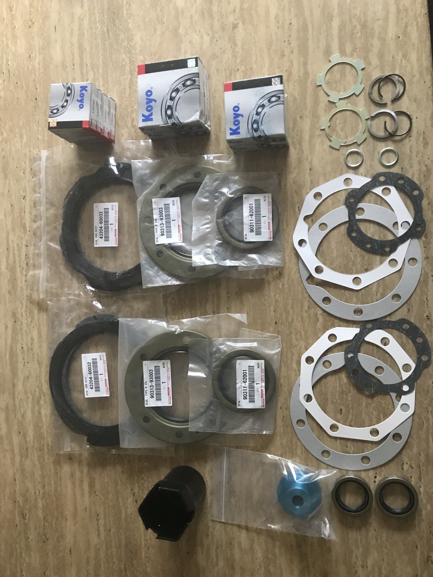

Hi everyone- hoping some of the SMEs who’ve done this job can review my kit below and let me know if I have everything in terms of gasket or need something. I won’t have much time when I start this to complete it and don’t want to waste time running back to the dealership and waiting for a part to be ordered which is 90% of the case when dealing with 80s. Thanks in advance View attachment 2515031
I know this is a petty suggestion, but the final icing on my bird job was installing the brand new dust caps available at the dealer for a few bucks. Good luck
I agree with new dust caps, add drive plates mine were in pretty bad shape.
and the obvious 12 cans of brake cleaner, at least a box of gloves, two boxes of shop towels and cardboard to put under it so you don't stain the driveway... (not that I know from experience or anything)

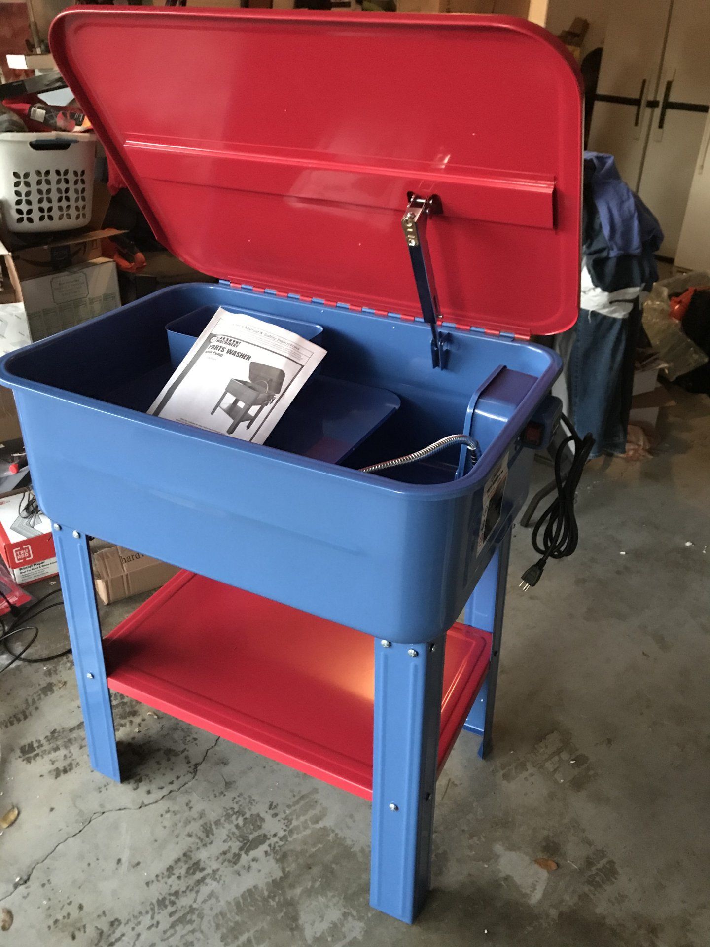

I was able to assemble and fire up my parts washer. As you can imagine, it’s pretty nasty and has caked on grease. How long can I leave the knuckle parts in the parts washer? Is overnight okay? I have almost all of the knuckle soaking

You can leave them in there for a year or two.
Depending on what parts washer fluid you use, the pump on your new HF parts washer is good for about 2 weeks with the good fluid. I use the Crown PSC fluid in 5 Gal from Tractor Supply. I ended up buying a new $100 pump and installed it after about two weeks. It's hard to find a good pump that will last. My new pump has now lasted 6 years.
Also buy a parts washer brush and the heavy duty long rubber gloves made for chemical use.
Be careful if using Berryman's Chem-Dip Carb and Parts Cleaner; it contains
Oxalic acid which will remove the yellow chromate/zinc coating on any part
if left in too long. FWIW.

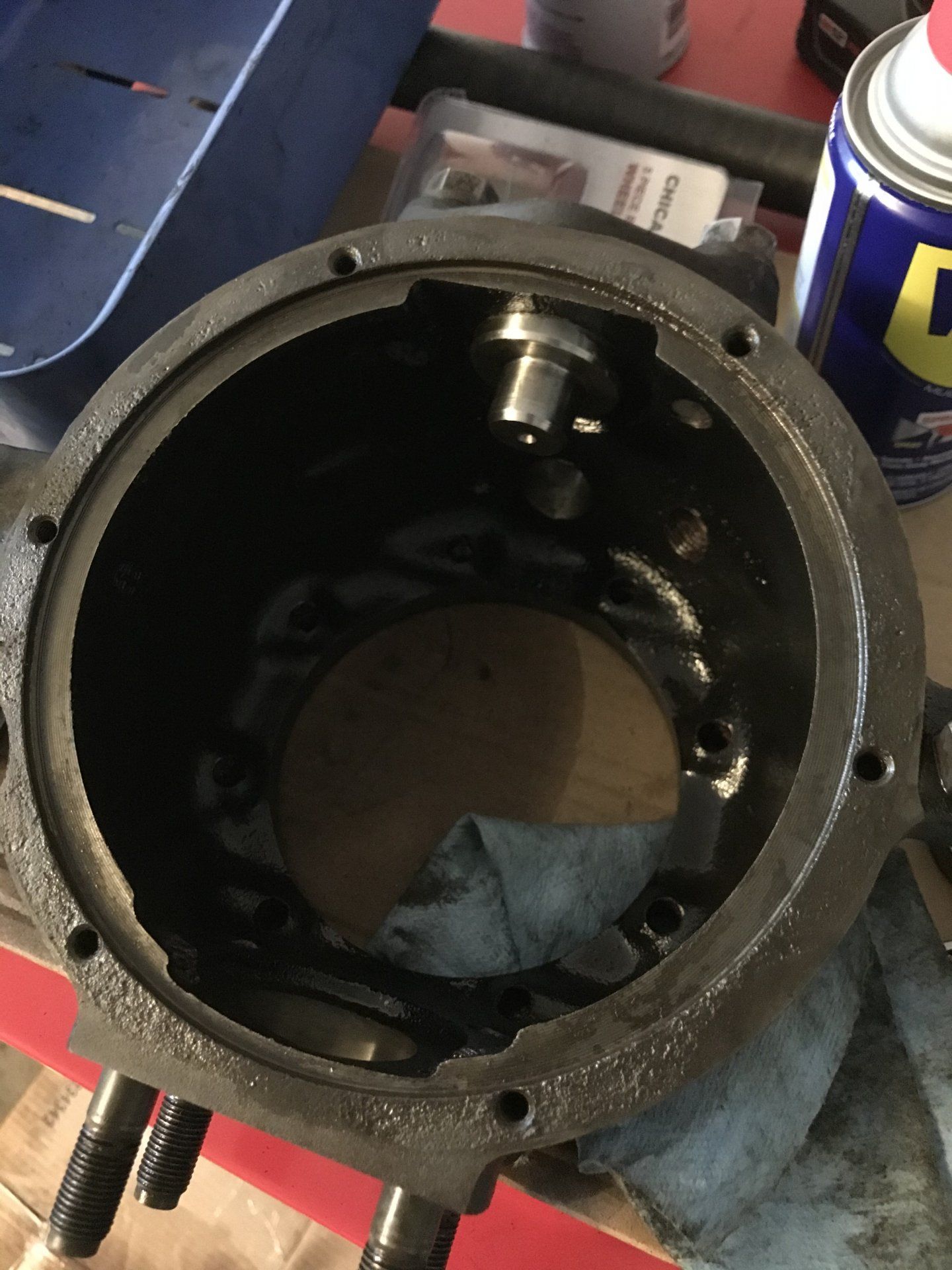

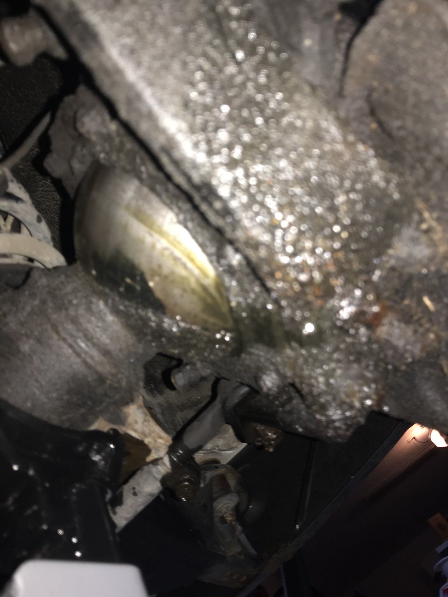

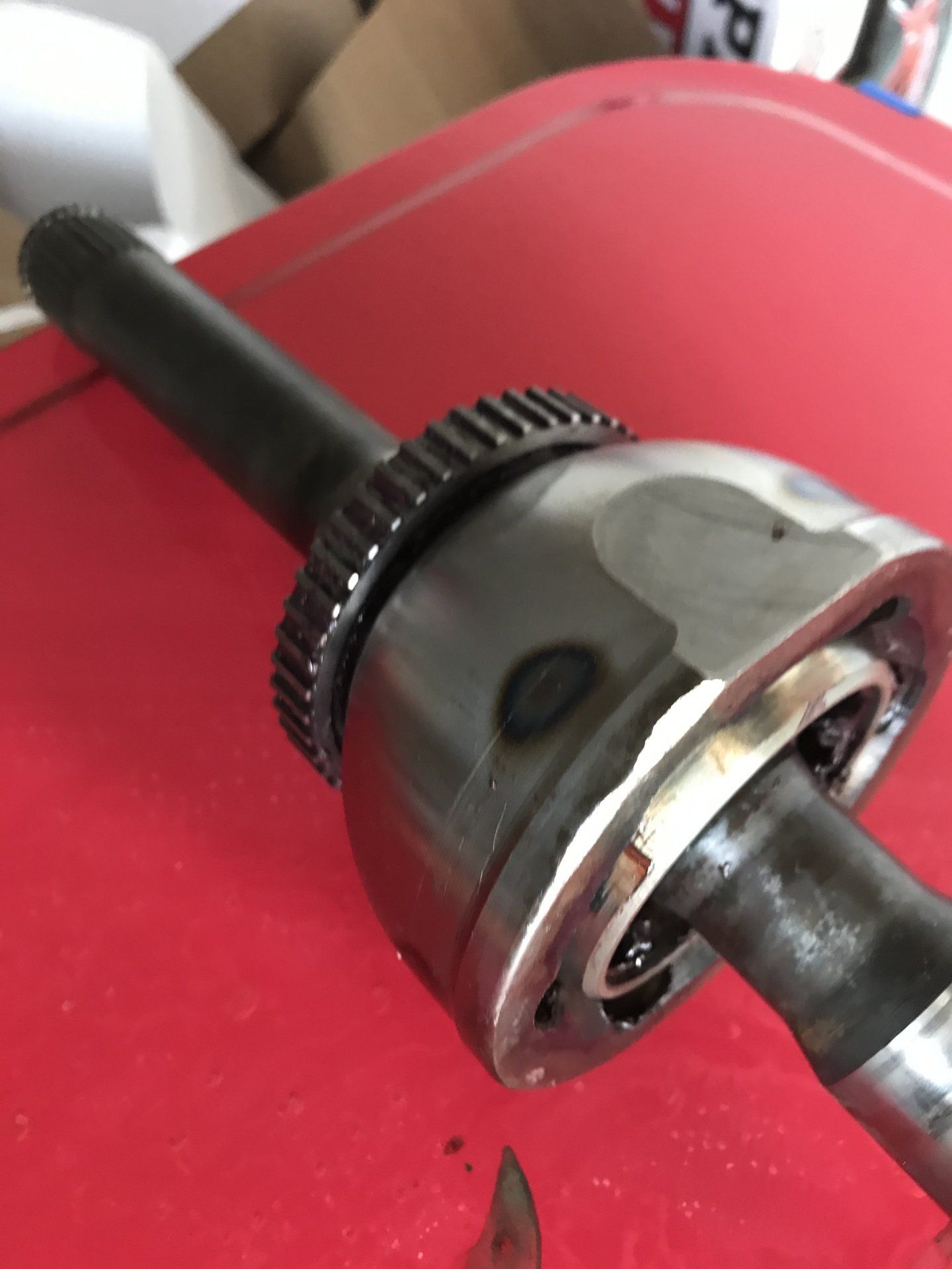

Hey y’all so quick question, I am on the other side of rebuilding my axle and I noticed the birfield having some gouges the previous owner left behind for me.
Seeing this, should I consider replacing? There is a swirl mark on the flat spot as well. It took 4 days of soaking and scrubbing to get all of the caked on grease and dirt off the knuckle. Going from pic 2 to finally pic 3
The outside of the Birfield doesn't matter. Where the seals ride on the inner and outer shaft are the most important, so you don't have leaks. Inside the Birfield where the bearings are is also important.
If it were me, I'd try to clean up the face of the knuckle, too. It really should be flat.

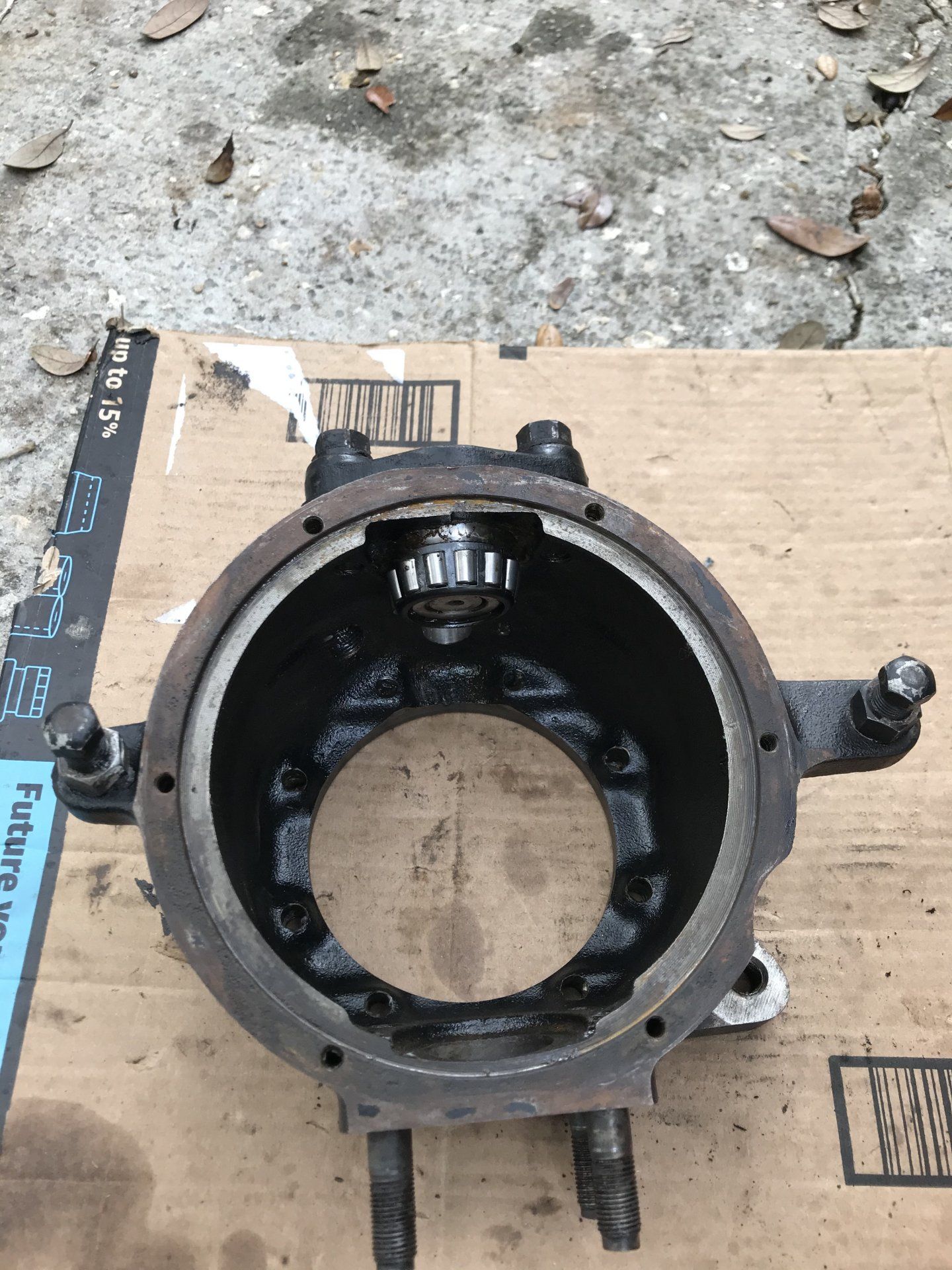

agree @Malleus , used a brass wire wheel and brake cleaner to remove the 2 decades of neglect. It took 4 days of soaking, which included draining and replacing the solution bath each day in the parts washer with a liberal scrub with the brass brush after soaking and rinsing.
This was day 5 where I was able to touch the bare metal without getting grease on my hands.
Nice work. My knuckles were in bad shape as well. Fortunately the outer axle seal was good so no diff fluid leaks, but the previous owner had someone service them years back and looks like they did a half-ass job. Knuckle was full of a mix of red grease, moly, and probably some whole milk. It took a couple days of cleaning (no parts washer). I got down to bare metal and sprayed the knuckles with some industrial enamel. The knuckle balls themselves were pitted so I wire wheeled them, JB welded them, sanded that smooth and then put a layer of enamel on them. A lot of work but worth it.

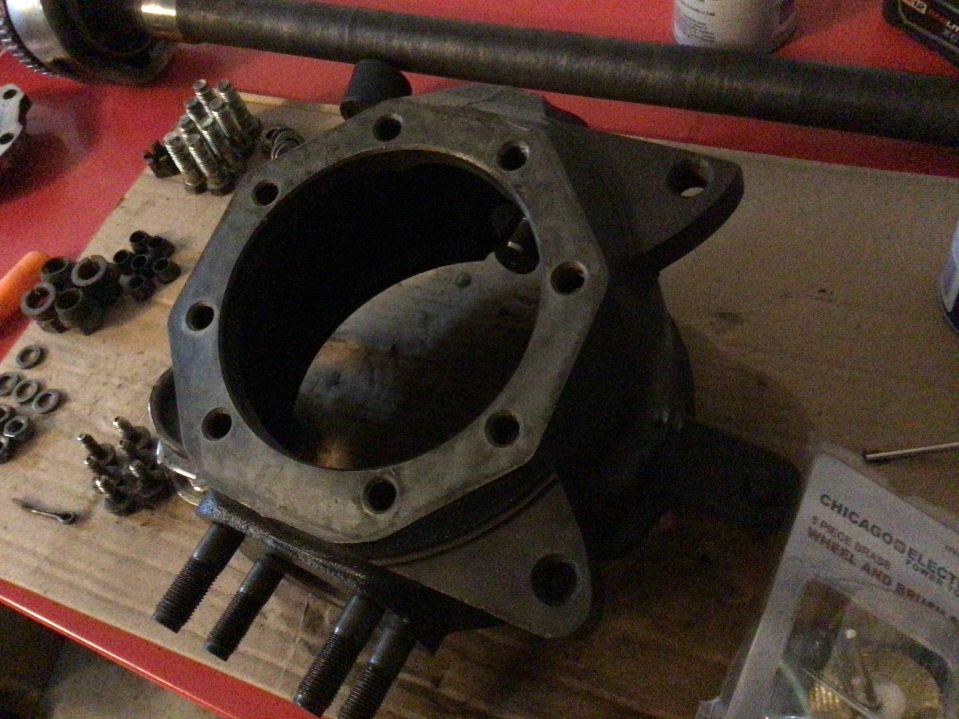

Does anyone know why there is an orange film inside the axle when your doing a rebuild ? Was this some protection coating ? It was a bright orange but I sprayed it with brake cleaner and most of it came off. @cruiserdan ?
Looks like rust to me.
Kinda looks like orange FIPG. Maybe they put some around the axle seal when they installed it last?
Agree I have to do the other side. I’ll certainly take photos as it was a VERY even coating, def not rust. It’s almost like a protective coating. my truck only has 151k miles, no service ever done other than oil changes. Original brakes etc
