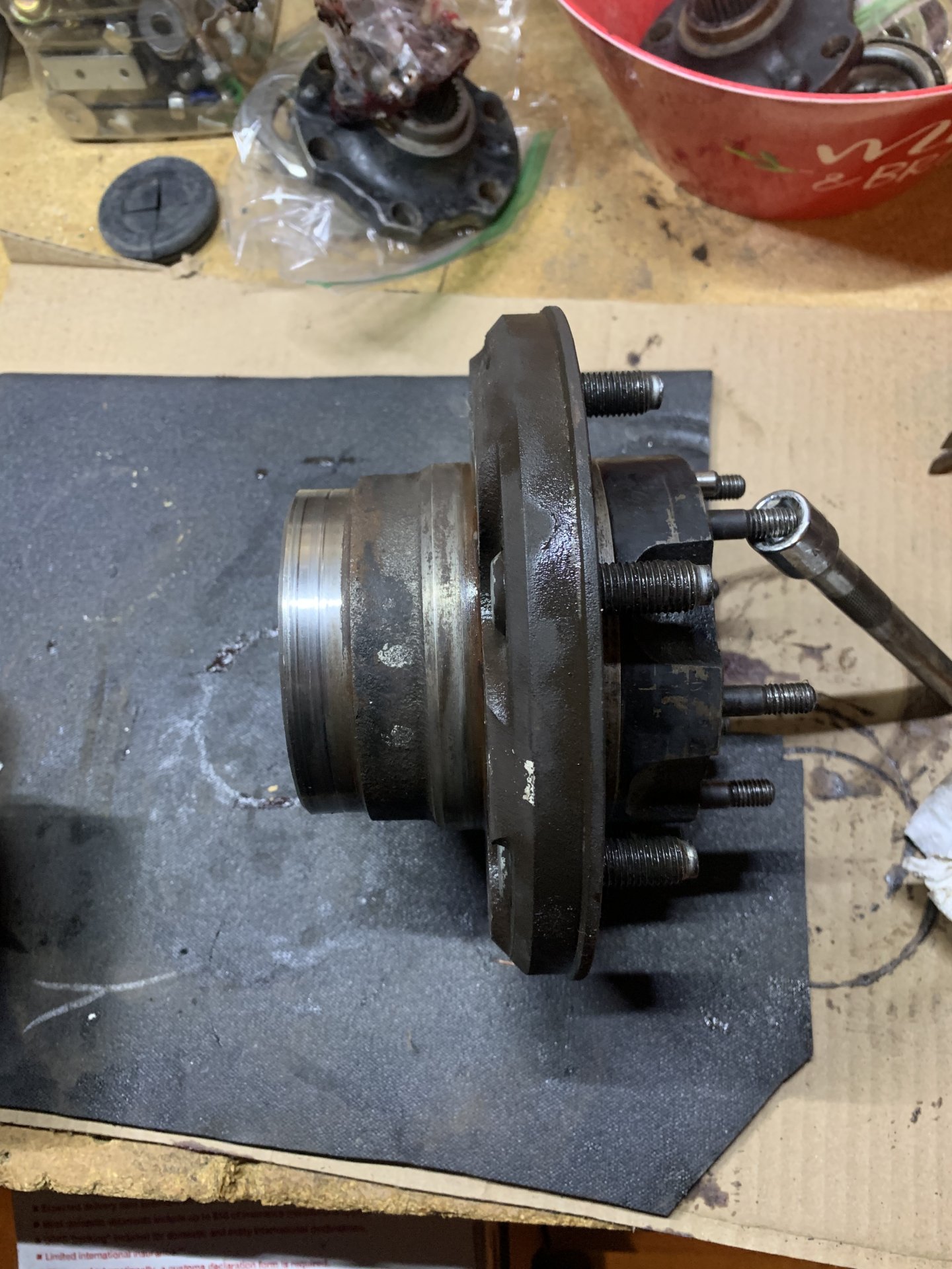

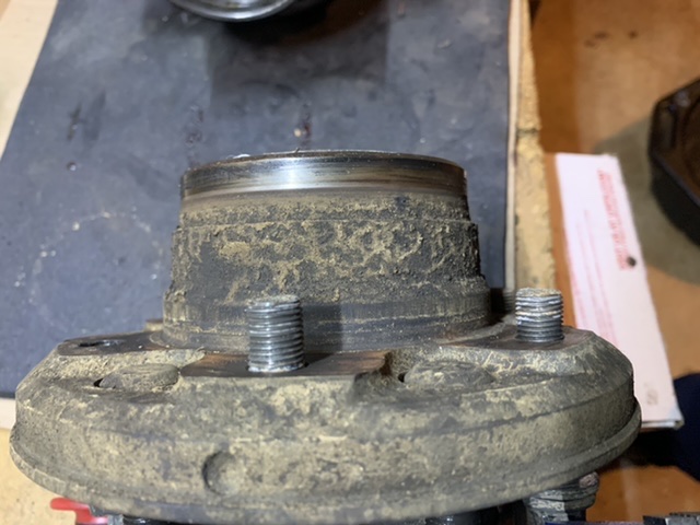

Question and Confessions
Confession:
When I bought my 1997 80 series in 2014 I did the axle rebuild myself. It was the first thing I had ever done on the truck, and knowing it would be a project vehicle wanted to do the work myself. It was a very rushed job and I’m sure I cut some corners, although I don’t remember.
Fast forward to today a simple brake job has now led to new seals, bearings and gaskets and that’s just for the hub. The brake job parts list is much longer…
Questions: What could I have messed up the first time to cause this hub to wear on just the edges?View attachment 2836002
I have started cleaned up the other side but they were both worn in the same fashion. View attachment 2836003
I have learned a lot over the years of messing with this land cruiser and don’t want to make the same mistakes I made last time trying to be cheap and fast. Thanks in advance.
Actually there are a couple of points to consider, if you want the job done correctly, including lightly greasing the seal lips before installing them; the FSM section is attached.
I'm not sure what the "edges" are in your post, but the second hub in the post appears to be really worn. If you can catch your fingernail on the groove, there's a good chance the seal will leak. Unfortunately, unlike most other seals, the inner hub seal has to be located in the rear of the disc within a tolerance that's just about equal to the lip width, so there's really no good way to move it in or out so it rides on a good journal surface. It may be time to replace the hub.
As to common mistakes, see page 10, section through the hub. This is how much grease should be in the hub; no more, no less. It's a packing to make sure the grease in the bearings doesn't sling out and run the bearings dry. Oh, and pack the bearings until the grease runs out of them. I usually go around at least twice. Make sure your hands are clean and don't bother with gloves; they're more trouble than they're worth.

Thanks for clipping that out of the FSM for me. I have a race press now and didn't use one before, I defifinetly did not pack the hub with grease between the two bearings. I also I think my preload was wrong too, I was getting some 12 and 6 O'clock movements once I got the tires off the ground so that wasnt helping. I never checked it last time after i had driven some few miles to see if it had settled any, I will this time tho. So this is still an ongoing learing experience. As far as the wear on the hub, the picture looks worse than it really is.
No matter how many times you do something, there's always something else to learn. I qualified my comments on the hub journal, because I know from experience how deceptive those photo images can be. You really need to be a pro with top shelf equipment to take an equipment photo and have it clearly represent what your eye sees.
So I answered my own question today and thought I would post my findings for anyone else that may be curious.
I discovered today that the last time I did this job, several years ago. I put the wheel seal in backwards and is what caused that strange wear and premature failure of the seal. Definitely a learning lesson.

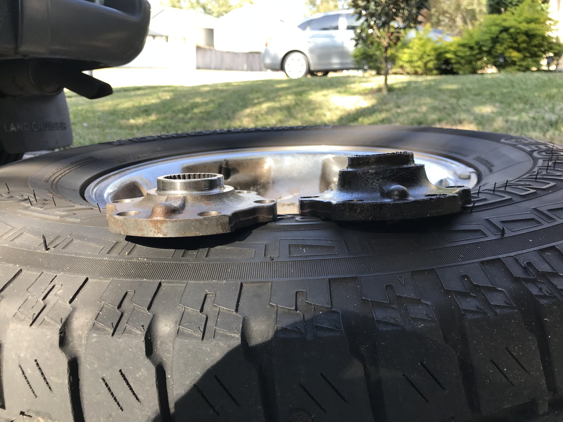

Your using an older and weaker style flange found on 93 and earlier cruisers. You need a new flange or get the cock ring from wits end to fix the gap @LooseCruiser
43421-60020 is to the left, found on pre 4/1993 fzj80s (achilles heal) and then they replaced it with 43421-60022. If you want to keep the older flange because of money issues, you will need to get the ring but its best to just get the flange since you clearly have a new birfield.
80 Series Birf to Flange Spacer-8mm - https://absolute-wits-end.com/80-series-birf-to-flange-spacer-8mm/
It's been a while but just wanted to thank you again, you were spot on. I finally got around to ordering the flange from here in Aus, delivered to Melbourne. Front Drive Flange suitable for Landcruiser 80 Series 94-98 FZJ80 HZJ80 HDJ80 - https://www.allfourx4.com.au/epages/shop.sf/en_AU/?ObjectPath=/Shops/allfourx4/Products/43421-60040
Now fits beautifully, no movement like before.

@lp2k - thoughts on flange replacement before tear down? I know you've helped out a few posters with incorrect spacing, replacement, etc.
The flange was upgraded to a meatier version in '94. You have a '92 right?
To fit the April '94 and on uprated flange you will need a longer CV / Birf to accommodate the increased thickness on the outer end. Aftermarket Birfs are available. Toyota ones are very expensive, at least they are where I come from
