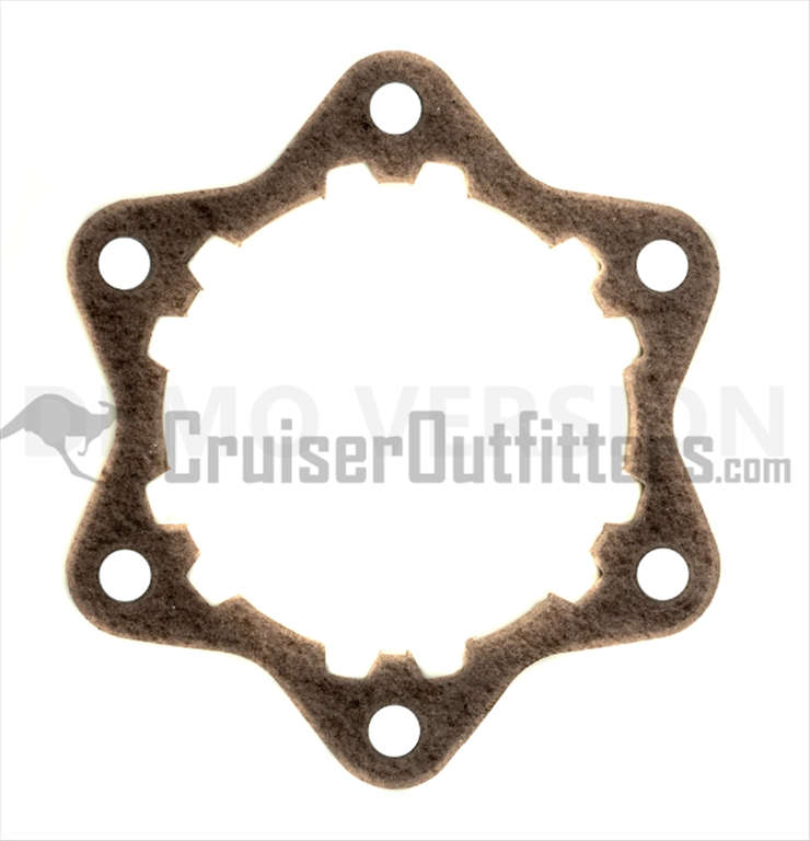

FYI the kit you purchased contains a couple of extra gaskets that are not used unless you have locking hubs.
Wow, thanks,
I had those left over when I did mine 3 or 4 years ago and never spent the time to figure out why they were left over.

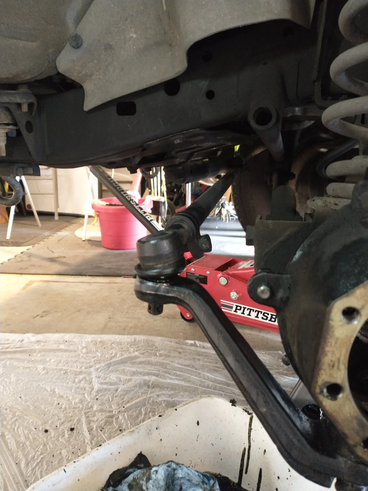

Any tips on disconnecting the steering arms? I have been trying for a while with a three-prong puller, no luck.
Yep, @lp2k that's what I was using. Finally got them to pop. Just had to configure the puller arms to have less of an angle and use the larger surface area ends. Time for a beer break and then the home stretch.
Tech tip, when popping the tierod out if they are being tough put a bunch pressure on the tierod with the tool then smack the arm with a brass hammer, they will pop right out

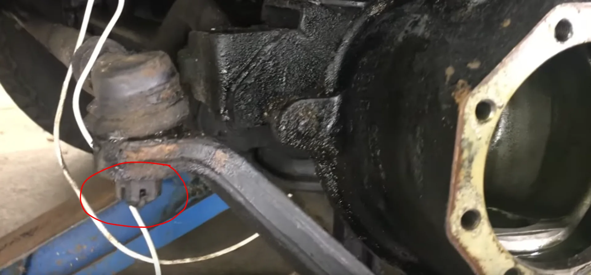

Quick question, what is the oem cotter pin size used on the lower knuckle studs?
Great info here, thanks to all that shared the knowledge.
OEM 80 Series knuckle studs are not drilled for cotter pins.
Hey @cruiserdan,
My mistake, I meant to say the cotter pin size for the steering arms studs.
Thanks for the info.
I suspect you mean tie rod ends. If so the part number is 90252-03005. Diameter is 3mm.
Well, I guess so. Need to keep researching more to ask the right questions. Here is an image of the cotter pin that i'm talking about:
Also, thanks for sending the part number and diameter size. Much appreciated
Yes, tie rod ends.
Alright. Will order those. Thanks again!

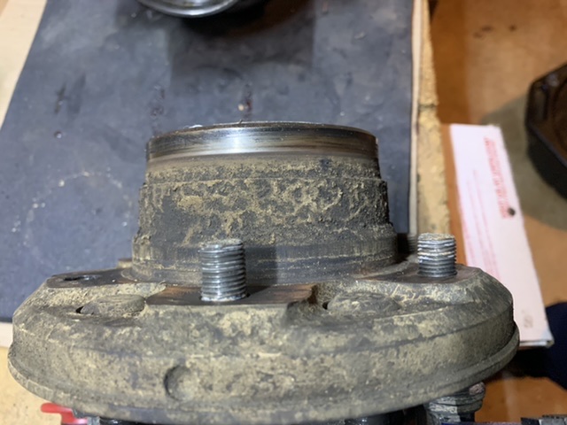

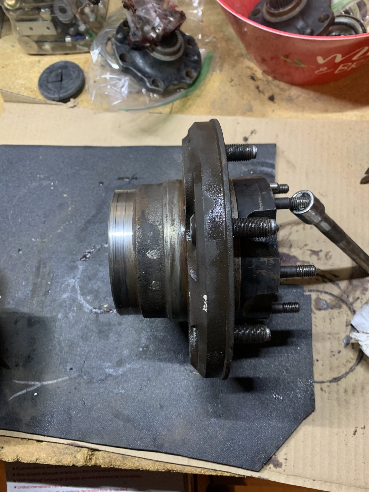

When I bought my 1997 80 series in 2014 I did the axle rebuild myself. It was the first thing I had ever done on the truck, and knowing it would be a project vehicle wanted to do the work myself. It was a very rushed job and I’m sure I cut some corners, although I don’t remember.
Fast forward to today a simple brake job has now led to new seals, bearings and gaskets and that’s just for the hub. The brake job parts list is much longer…
Questions: What could I have messed up the first time to cause this hub to wear on just the edges?
I have started cleaned up the other side but they were both worn in the same fashion.
I have learned a lot over the years of messing with this land cruiser and don’t want to make the same mistakes I made last time trying to be cheap and fast. Thanks in advance.
There are rubber seals that "wipe" the shinny areas. They don't look significantly worn. Proper repair would be to coat the rubber seals and hub with a small amount of grease.
