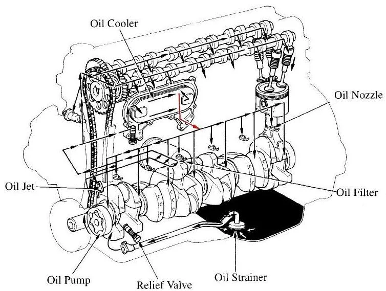

Could a defective oil filter explain this? IIRC the oil flows first from the pump directly to the filter then out to the rest of the engine??
ps: don't tear the oil filter apart if you think it's defective, maybe also take photos as you remove the filter to show if there's any oil inside??
sorry to hear, hoping the best for the crankshaft, wild that it had oil pressure but no/ little volume. must be plugged after the oil pressure sensor?

Very deflating to have that happen. I think it would be wise to check the relief valve as well.

Yah I’m not sure what would cause it to not flow everything is getting torn down to check rings and all bearings. Maybe the relief was stuck open. I never inspected it because it was a brand new timing cover with new oil pump included.
Will need to rethink my start up procedure to make sure the pump pulls. I primed the pump per FSM through the timing cover. And everything was pre lubed with oil on the piston Skirts and bearings. Will Inspecter pick up tube and relief valve and all oil passages that I can get it without pulling oil galley cup plugs. I have some if it comes to that.
You said the cams spun freely with a wrench when you took the chain off right? There was some visible oil in the head when the valve cover was off. So some oil got to the head because the cams didn’t seize. I think the oil orifice controls the flow of oil to the head. If it was not installed it could have flooded the head with oil and bypassed the oil cooler which seems to transfer it back to the crank? Then when you shut it down it all drained back down to the pan.

Check pressure relief valve moves freeky in the timing case.
