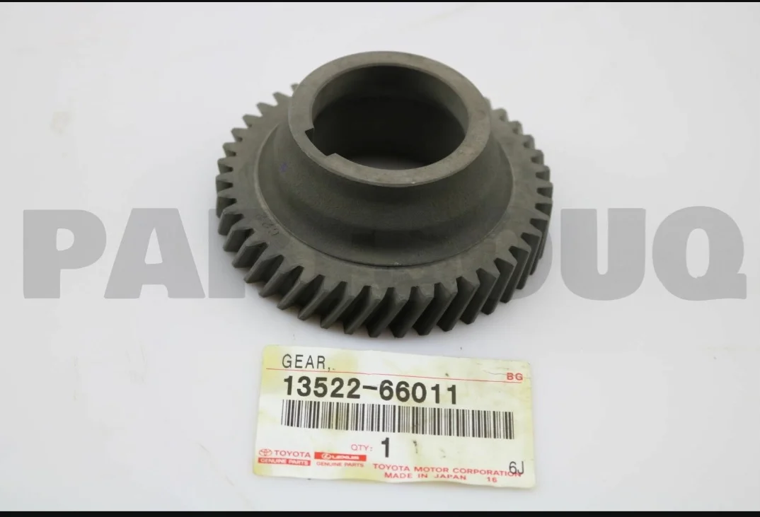

Did you double check the torque on the harmonic balancer to confirm that the oil pump was operating properly? 306 LB-FT
Yes I torqued 306. What do you mean by oil pump working properly? Brand new timing cover and engine staring building oil pressure.
Oil pump gear is friction driven, no key, and requires the HB bolt to be torqued to 305ft# for proper drive.

Well, because the oil pump is driven by the compression on the crank. If loose, it may build pressure initially, but not enough volume, thus starving the bearings.
thanks I bought a 4foot 3/4 drive just for that sucker and welded up a crank holder.

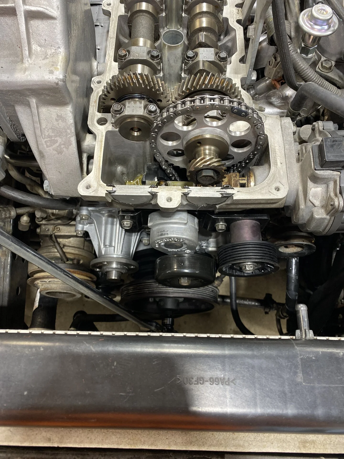

Those cams look really dry.

Super charger spins freely, fresh oil in the nose cone. I agree the cams had not got oil yet not sure how long it takes to start splashing around up there.
I would want to borescope the bottom of the timing chain, easy for something to have fallen down there or the chain otherwise bound up. If all OK there remove or loosen cams see if the engine will turn. IF the re-manufactured heads required very much machining to correct 'warpage' then when pulled down to the block it can bind the cam bores. Once run....these could have scored. Very puzzling to be sure.

Obviously not a good thing to run it with no oil pump. Not the best design by Toyota for it to be run by a torqued bolt vs a gear that is keyed on the crank.
That’s the plan tomorrow borescope, pull cams. Head was decked .003 thousandths so not much.

There should be a key between crank and harmonic balancer, and between oil pump drive gear and crank. If the keys are in place, crank bolt torque shouldn't be immediately catastrophic

This was replaced along with all the other gears.including new oil cooler cover and timing chain cover/oil pump.
