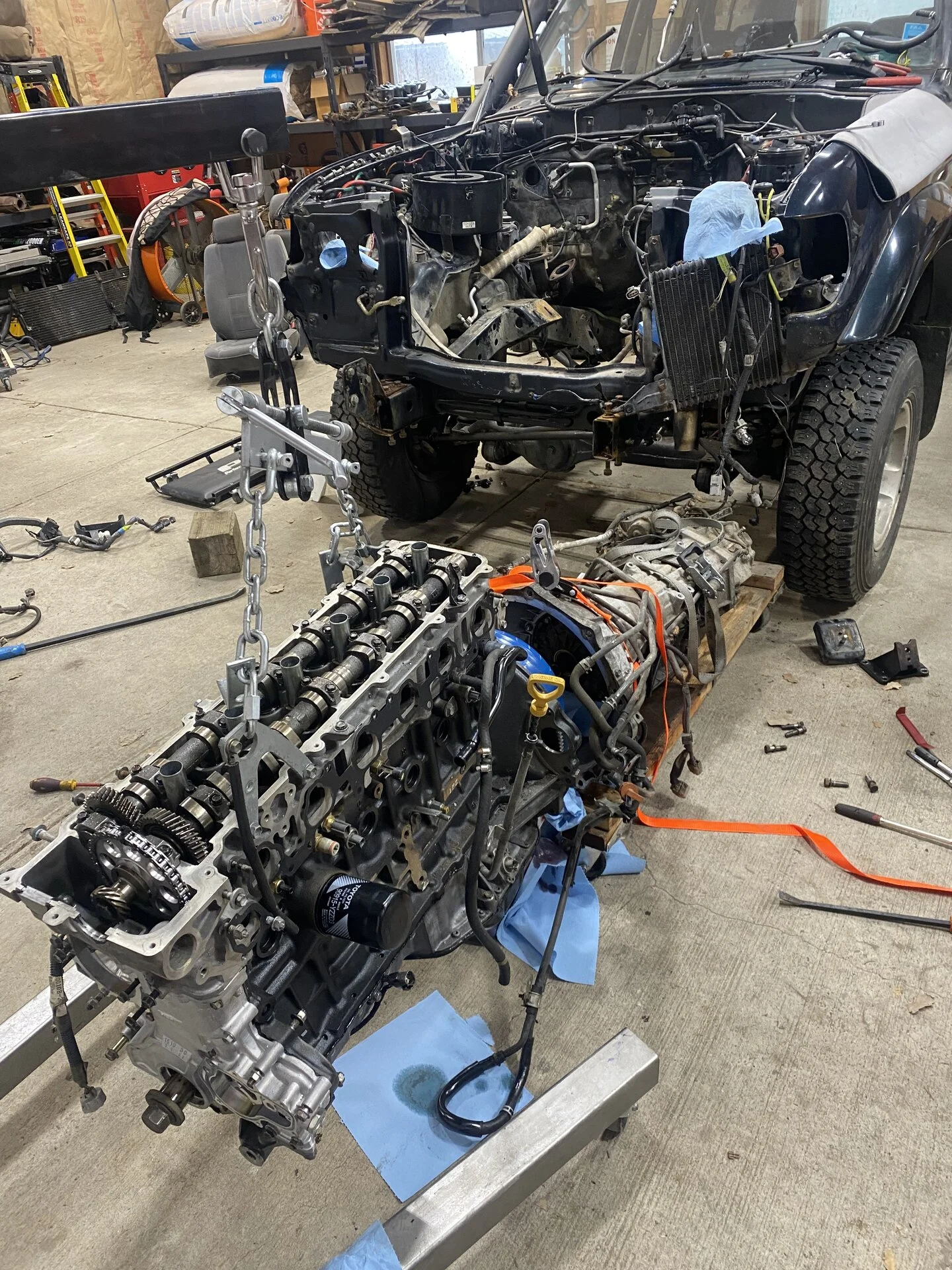

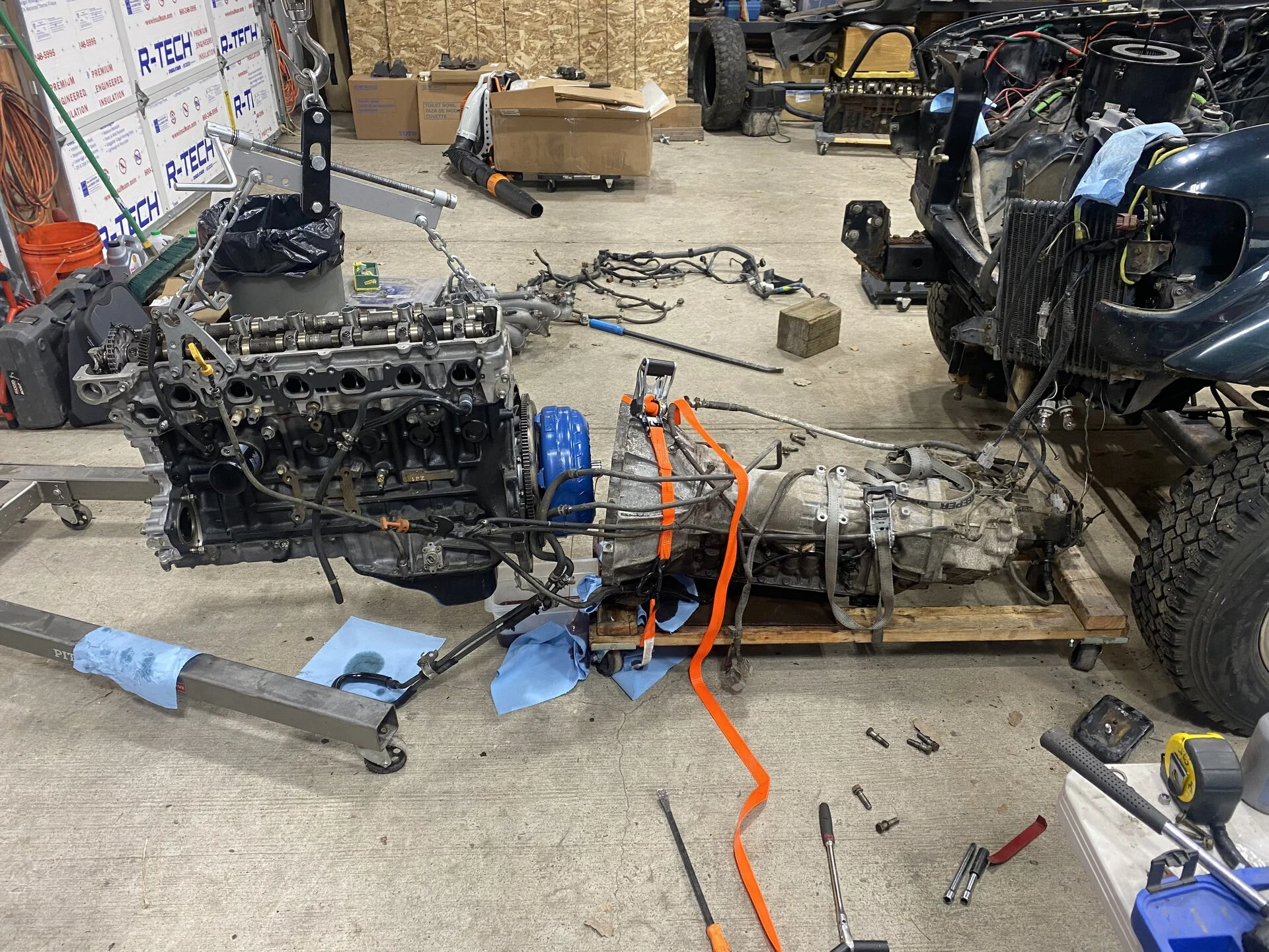

Oil pump was full of oil and drained out the normal amount. No metal anywhere. Crank pulleys off and everything looks legit timing marks all lined up still. Tried rotating with no harmonic balancer and oil pump out no dice. Currently draining down radiator and block going to pull this beast. I have pulled the head and pans in the truck but find it easier to just yank the whole thing. Especially if it ends up being transmission related I will be happy I yanked the whole thing.

Agree I don’t know how either. the truck sat for 3 years, towed to my shop on a flat bed rolled in and it’s been about 3/4 months I have been chipping away at it. I checked all the fluids and everything is tip top.

The only thing that turns inside the transmission with the engine rotating is the front pump. The torque converter could have been only partially engaged and jammed the pump rotor when the bellhousing bolts were torqued. You'll be able to separate the engine and trans with the torque converter still attached to the flexplate, though this is not the preferred method (be prepared for transmission fluid to spill out). Once loosened, if the engine will turn, carefully inspect the trans pump and torque converter--both may need to be replaced.
I actually suspect there may be a problem with the main bearings, but hope there's not.
