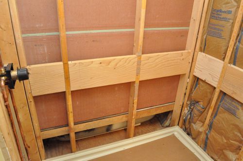

Yep, I specify blocking in kitchens, bathrooms, closets, and a few other places to take care of such things. Here's the blocking for future grab bars in a shower. Makes things a heck of a lot nicer and easier when the time comes to redo cabinets, towel bars, shelves, and such.
