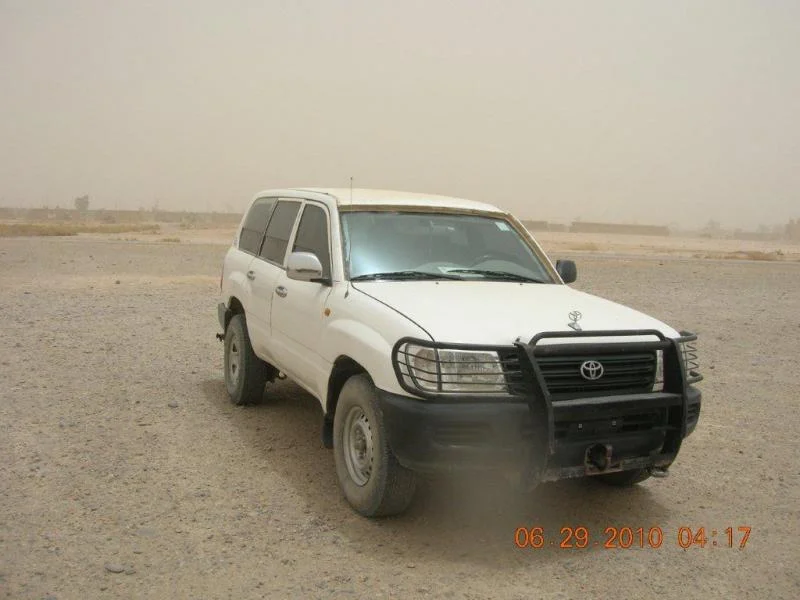

The LC's are all over in the middle east are they not? I only wish I could have taken at least one back home with me. I did think I might get a Russian jeep shipped back, it was given to me anyway...
