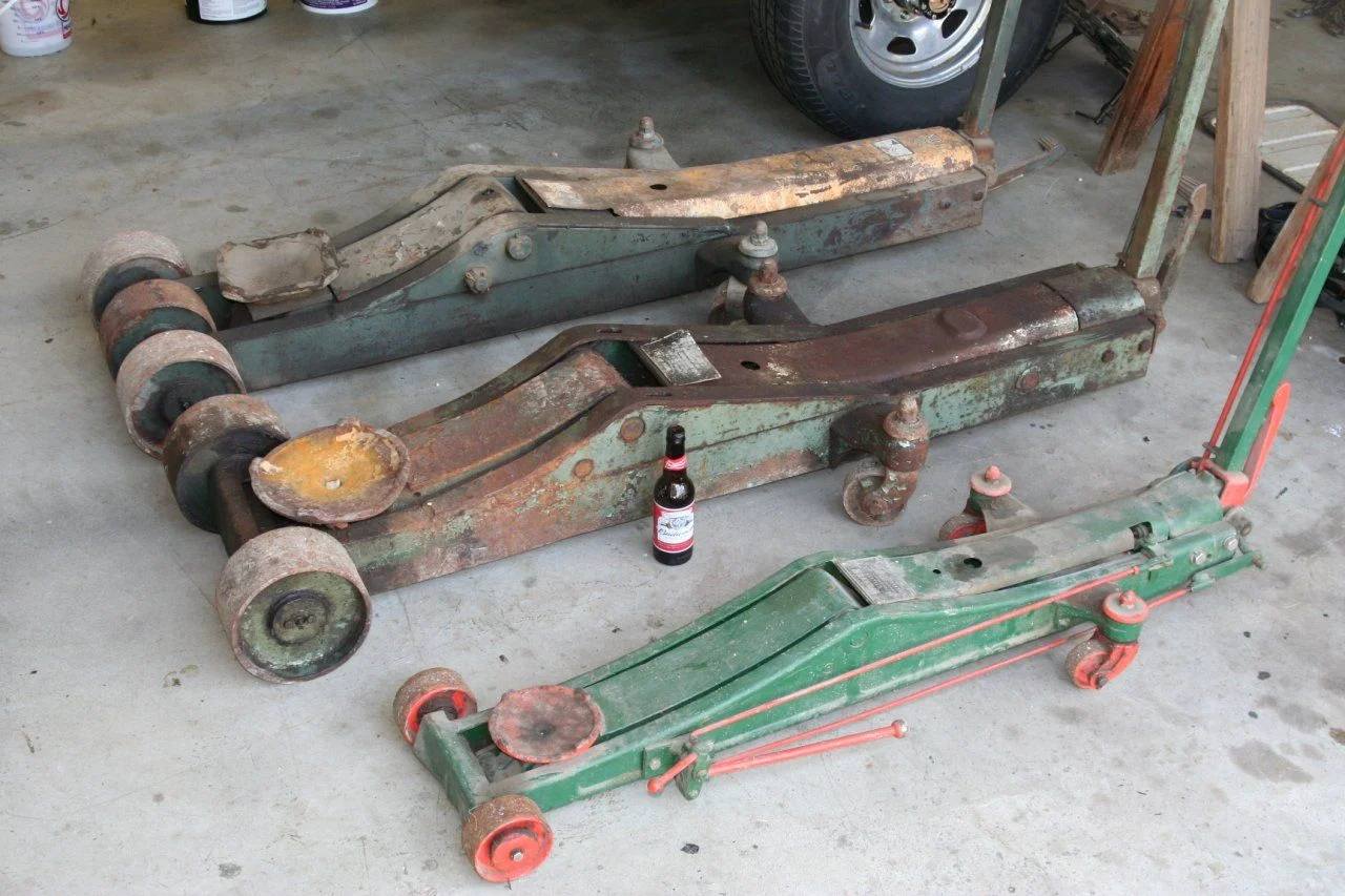

I use both a 2 ton Walker made in the 70's, and a 1 1/2 ton Hein Werner made in the 60's. The nice thing about both these jack's is they were both made in the US, and both are fully rebuild able, unlike the jacks from China. Last time i rebuilt my walker it cost me 60 bucks for the rebuild kit. Both my jacks have low saddles heights, that go as low as 2 1/2" and rise to 20" Since i own my own machine shop i made a new saddle with an extended 7" high saddle to use when i am working on trucks that have a lift. If you want PM me, and i can send you a print that you can take to any machine shop so they can make you a 7" high saddle to use with your lifted trucks.

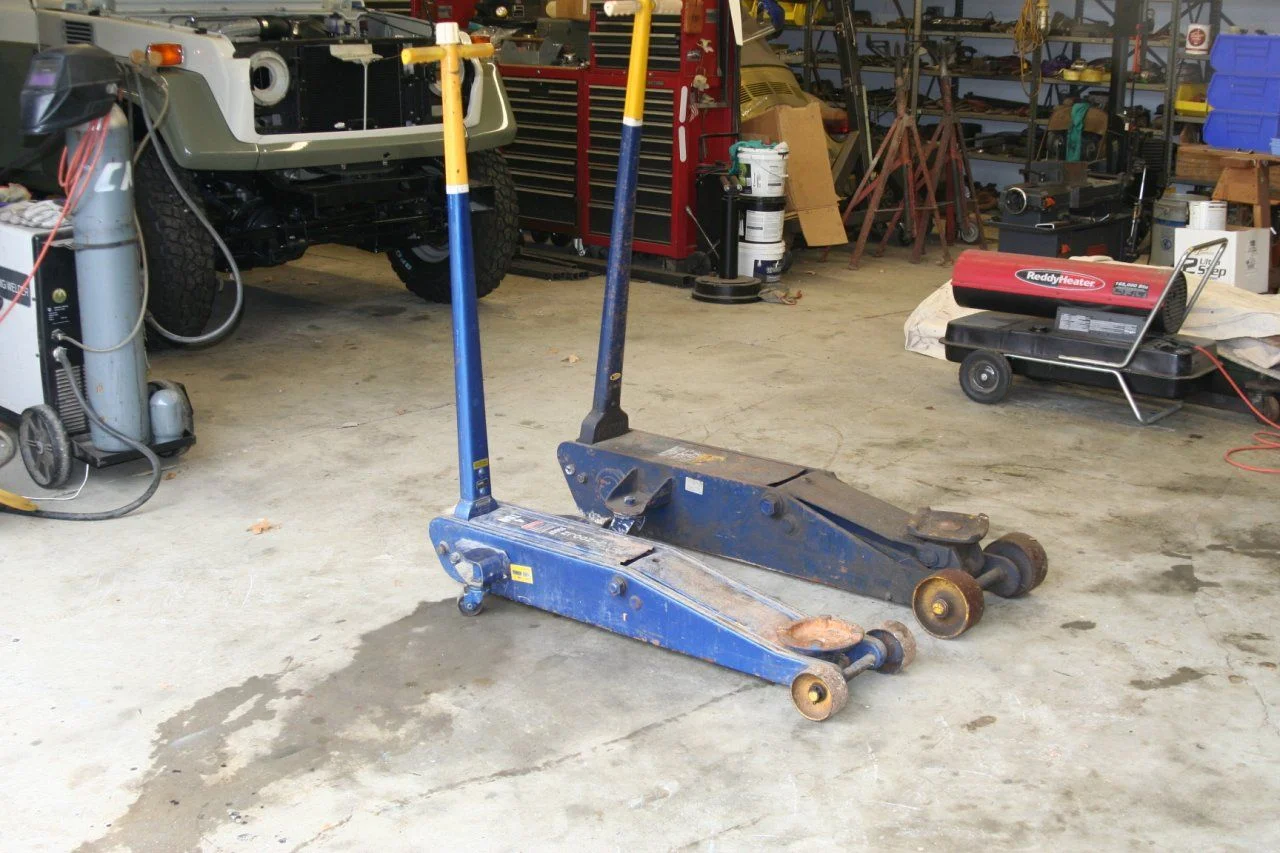

Years ago I got a 3.5 ton low profile Arcan twin pump quick lift jack from Northern Tool to get under my lowered VW but it lifts to just over 21" and though it doesn't get a lot of use it seems well made and gets to full height in about 4-5 pumps.
Here's a pic showing the Wallyworld special next to the Arcan.
