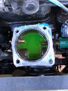

Attached picture shows placement of sensor for backup gauge on left of thermostat housing. I was very careful when placing this, but now I'm having second thoughts regarding whether it could be constricting travel of thermostat. Guess I could remove it and put a threaded plug in for testing.

Not sure if that sensor is hindering the t-stat. That would be a problem if it is.
