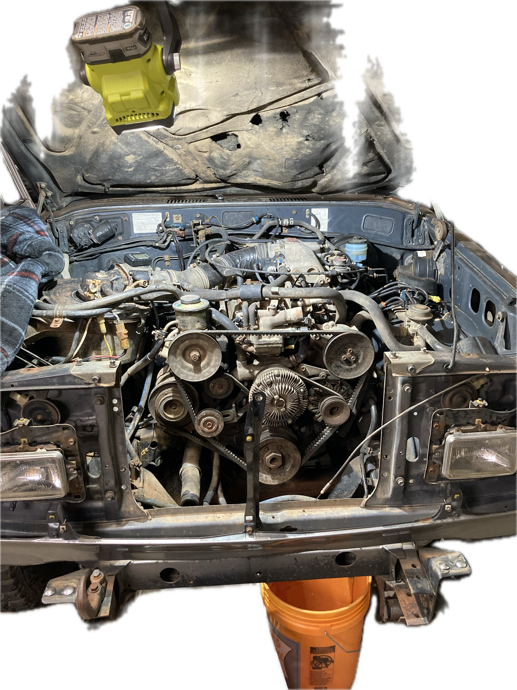

Guys, a fishing friend is trying to reassemble his FJ62 pulleys. The friend is 84 years old and took the radiator and pulleys off 4 years back. Can someone take some pics of the Fj62 engine (front) that I can send him? TIA

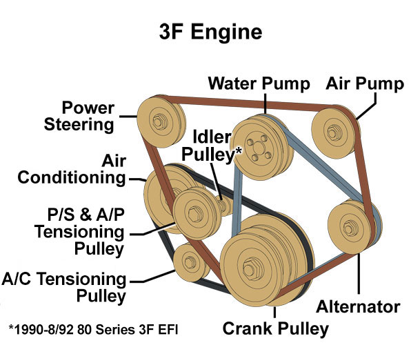

Perfect, thanks!!View attachment 3887553
Like that?
