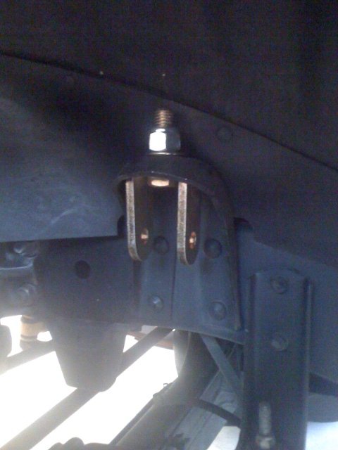

Ok, I got everything installed. All parts worked great. The stem to eye connector worked perfect and bolted right in. These connectors seem to be built really well. The top of the front shocks still need to use the 5/8 bushings to mount to the connector. All other bushings need to be 3/4". The ride is much better, mostly notice that its a lot less bouncy.
That's a pretty interesting setup. I hadn't even realized this was a thing when I did my OME/Bilstein install a couple months ago (which I cant say enough good things about. I absolutely LOVE the improvement in ride, control and clearance. If I have weight in the back it rides almost as good as a brand new vehicle). Knowing this though I think I still would've stuck with my stem style front shocks. It looks pretty, but seems like it would just create more complications than it's worth. You've already ordering different shocks front vs. back, so why not just go with the stem type shocks in the front to avoid having to modify or add anything?

After doing several hours of research this morning, I've decided to go with Bilstein 5125s for my upcoming suspension overhaul. However, one of the previous owners installed front shock hoops so until the adaptors most people needed, I can use regular Eye to eye shocks. My question is, can I just remove the old blown shocks to get their measurements or should I install all of my new suspension components and physically measure for new shocks?
