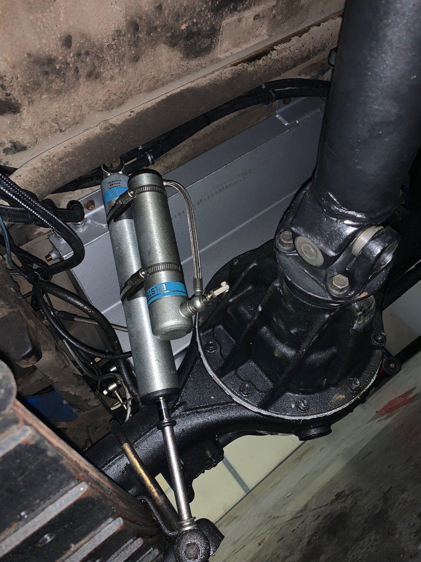

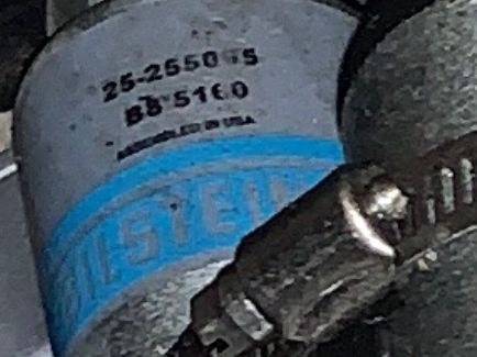

I run bilstein 7100s with my OMEs. Way better ride than OME shocks, but I've custom tuned the valvestacks. For a relatively stock truck 255/70 valving would be the best starting point. I add a little bit more compression valving in the high speed section of my 255/70s up front. I think that the rebound up front could also use a little more in the medium speed section. In the back I'm running 275/60, which needs a little less rebound.
I used 8" remote resevoir versions with rubber adapter bushing. Others have used 10" short body, which might be available with a stud mount that works with our upper front frame mounts. In my case I cut the stock stud mount off and welded on a modified (shortened) Ford F250 mount.
The remote reservoirs are pretty damn nice to have and definitely improve ride quality.
3“ OME lift, # 5160 shock
Hey @HemiAlex could you share the Bilstein part numbers?
My suspension is OME CS005F front and CS005RA/B. It doesn't lean.I'm using the 33-230368 360/80 valving up front. I've got a bullbar and winch up front and I'm adding a 2nd battery. If I was stock up front, I'd use the 33-230351 in 255/70 valving.
In the rear, I've got 33-185606 255/70 valving in the rear.. This was suggested for a small bumper or stock weight capacity in the rear.
I've no issues flexing the truck and the road manners are great. I've got Bilstein's on 3 cars. Plus, for the 60 they're cheaper than most of the aftermarket options. I purchased them from 4wheelparts.
