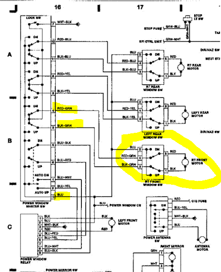

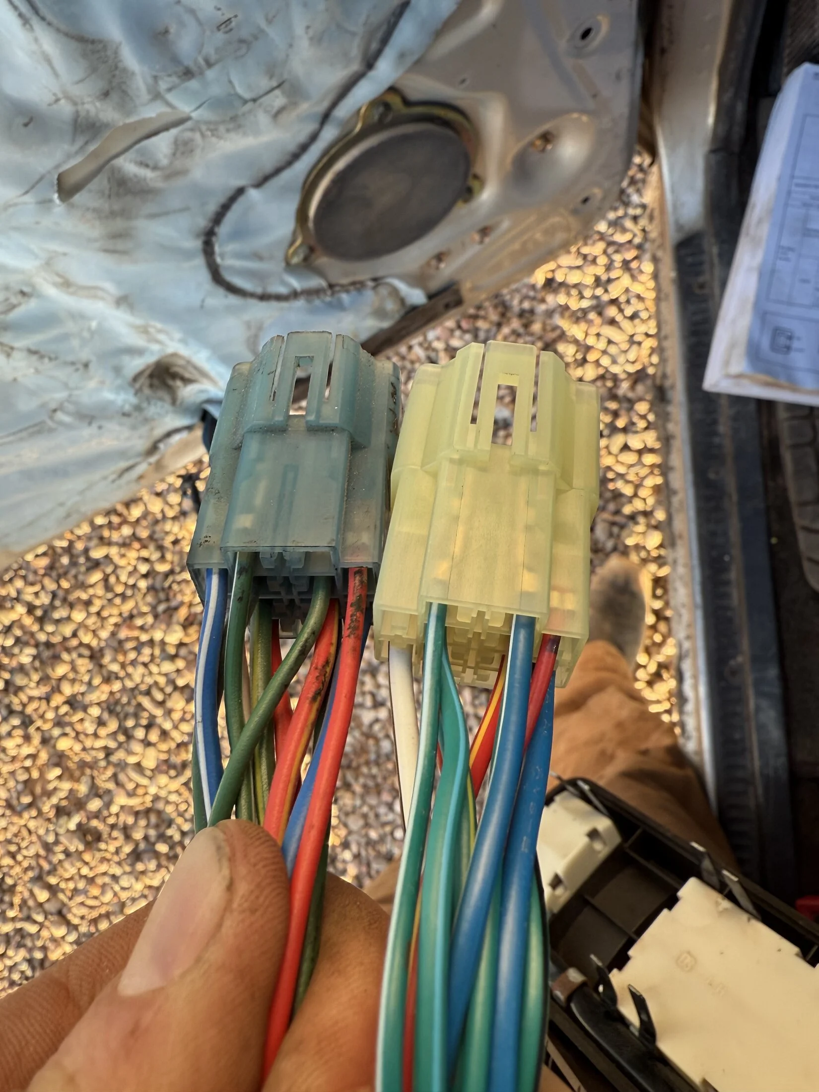

Last November, I was in Hanksville and busted my master control switch. Replaced it today with a new part, but my passenger front door still not working (all others now work again). Any advice on how to diagnose the issue? Maybe just replace the regulator and motor?

Before going to the expense and hassle of replacing those parts, check for voltage at various points on the circuit that feeds the front passenger window motor. All of the wires for the windows and power locks, etc. have been subjected to 40 years of the door opening and closing, so it's possible that there's a broken wire in the harness somewhere. It could also be a grounding issue.
[Edit: if you have a multimeter, you could also check for continuity between the wires in the passenger door and the master switch. That might help to diagnose a broken wire]
Do you have a copy of the factory service manual? In the back of the Chassis and Body manual is a full set of wiring diagrams. The wiring for the power windows is pretty complicated, but the diagrams will at least tell you which color wires to investigate.

I do have the FSM. Note: neither master control or passenger switch were working. I took down the door trim and tested the passenger door switch with the multimeter, which wasn't a problem. Checking the wiring switch to the motor required taking the whole darn thing apart, and I wasn't getting continuity on the wiring switch to the motor with the car on. So my guess is that the wiring to the motor is the issue. I'm going to test the motor this afternoon separately.

Motor is completely dead. I did the battery hookup trick with the alligator clips. Spun slowly for three seconds and died. Just ordered one for $100 plus shipping. Keeping the regulator, think it just needs more grease.

So, I replaced the passenger window motor with a Corolla one, greased up the regulator. Did a bunch of multimeter testing that was a little confusing. The motor would go up but not down when testing. Got the regulator and motor back in and window aligned (felt like five hours). Once everything back in place, passenger window still not working. Realized a few days later that the master control passenger up button would make the drivers window go up. Got busy with work, revisited last week. The ew master control switch I bought wasn’t wired the same as the old one. Rewire the harness (move the blue wire) and everything works!!!
