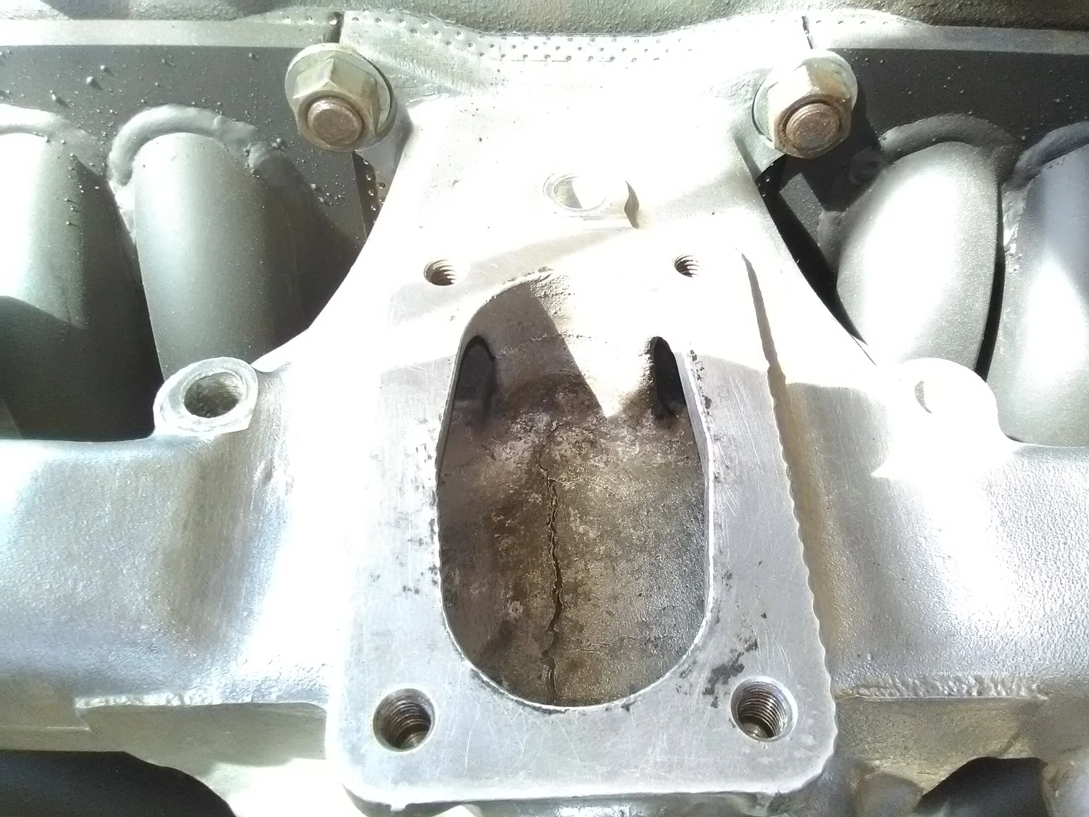

I was unaware of a intake crack issue, where exactly does this typically happen? That makes alot of sense actually.
The damage is from hot exhaust directly under the intake manifold. The 'heat-riser' used the exhaust gas to directly warm-up the intake manifold. It was intended to 'atomize' the fuel charge, during cold-starts, which means that the exhaust manifold had a mechanical flap, controlled by a bimetal spring to control the heat. Too much complexity for its day.
Now, you can buy a thin solid plate to go in place of the gasket between the stock exhaust manifold and the intake manifold, to accomplish some the thermal exchange without the direct exposure of exhaust gasses on the aluminum intake manifold. I suppose by skipping the exhaust manifold with headers, I'll probably have more fuel contamination of the crankcase oil, and a bit worse gas mileage.
Oh wow what a nightmare. 😆
I don't actually know that it is a vacuum leak there. However, it is easy to get to, after you figure out the vacuum piping. Mine's a '75; I'm fairly certain that our manifolds are different. I have a '71 intake manifold that shows no problems. I'm still guessing that it is the EGR valve, I think that it is cast iron, and, we see the steam, indicating that there is water-vapor in the exhaust - just a guess.

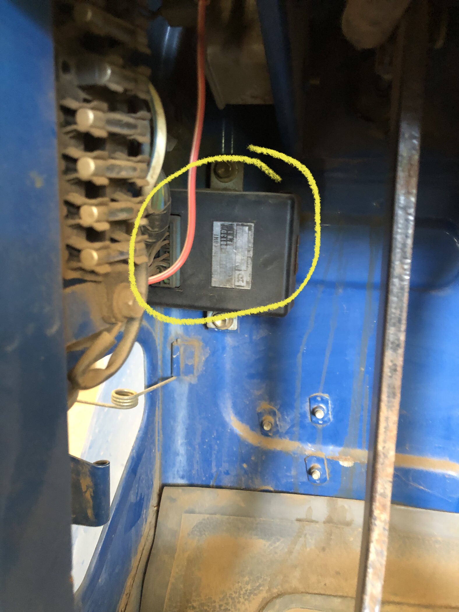

my '82 FJ40 had the same issue. I found the connector on the harness to be rusty that connects to this control module. its located on the firewall behind the clutch pedal. I used a file from a gas welding tip cleaner that fit into the terminals and cleaned them up. The problem went away for me.
That is the emissions "computer" that controls when the fuel cut solenoid on the carb opens and closes. The connections from the wiring harness to the circuit board inside were cold soldered, and are well known for cracking with age and making an intermittent open circuit. It's possible to heat and re-flow the solder to fix it, but an easier way is to just ground the wire to the FCS where it enters the box. Then the FCS will be always on with ignition.
