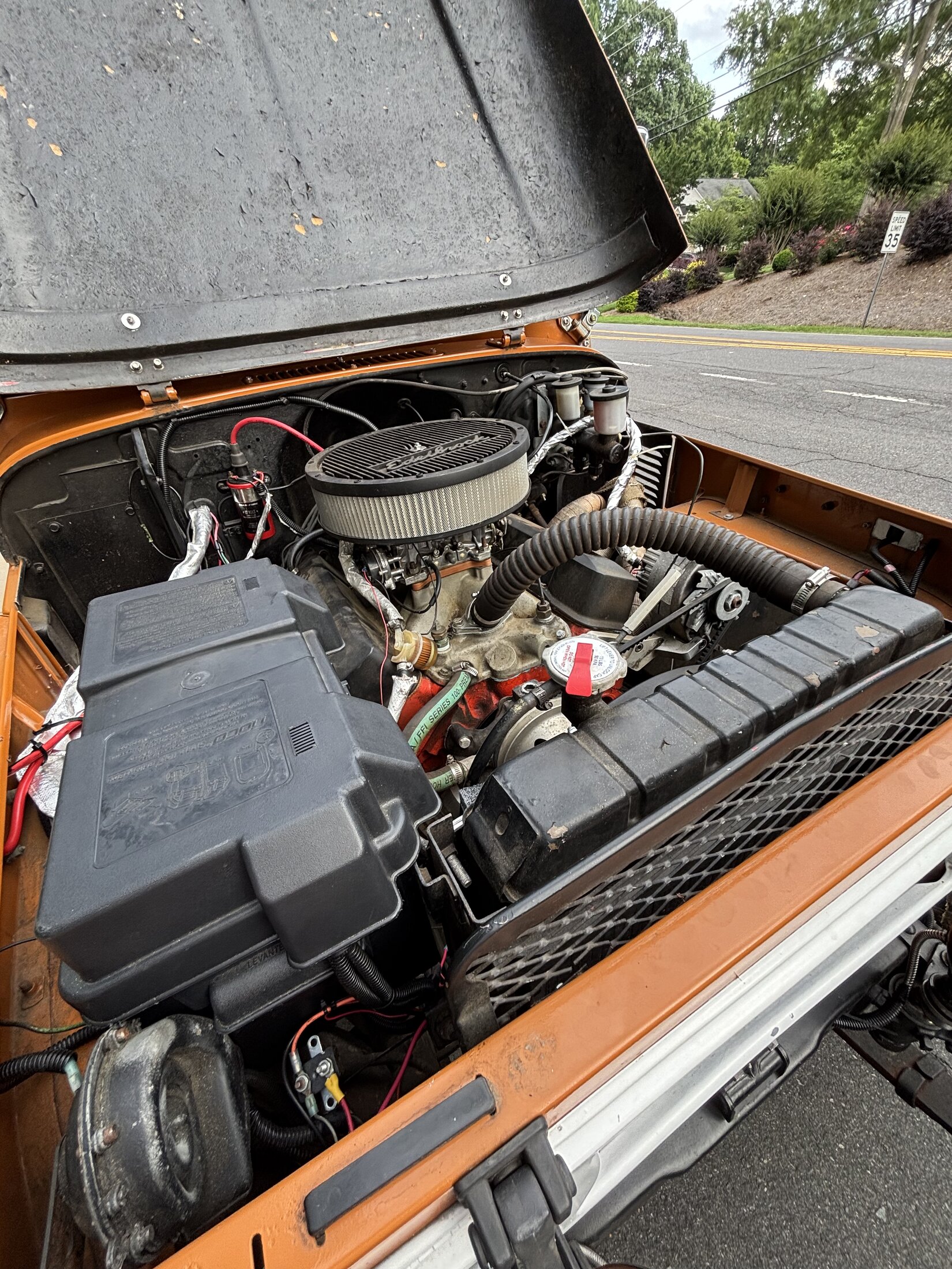

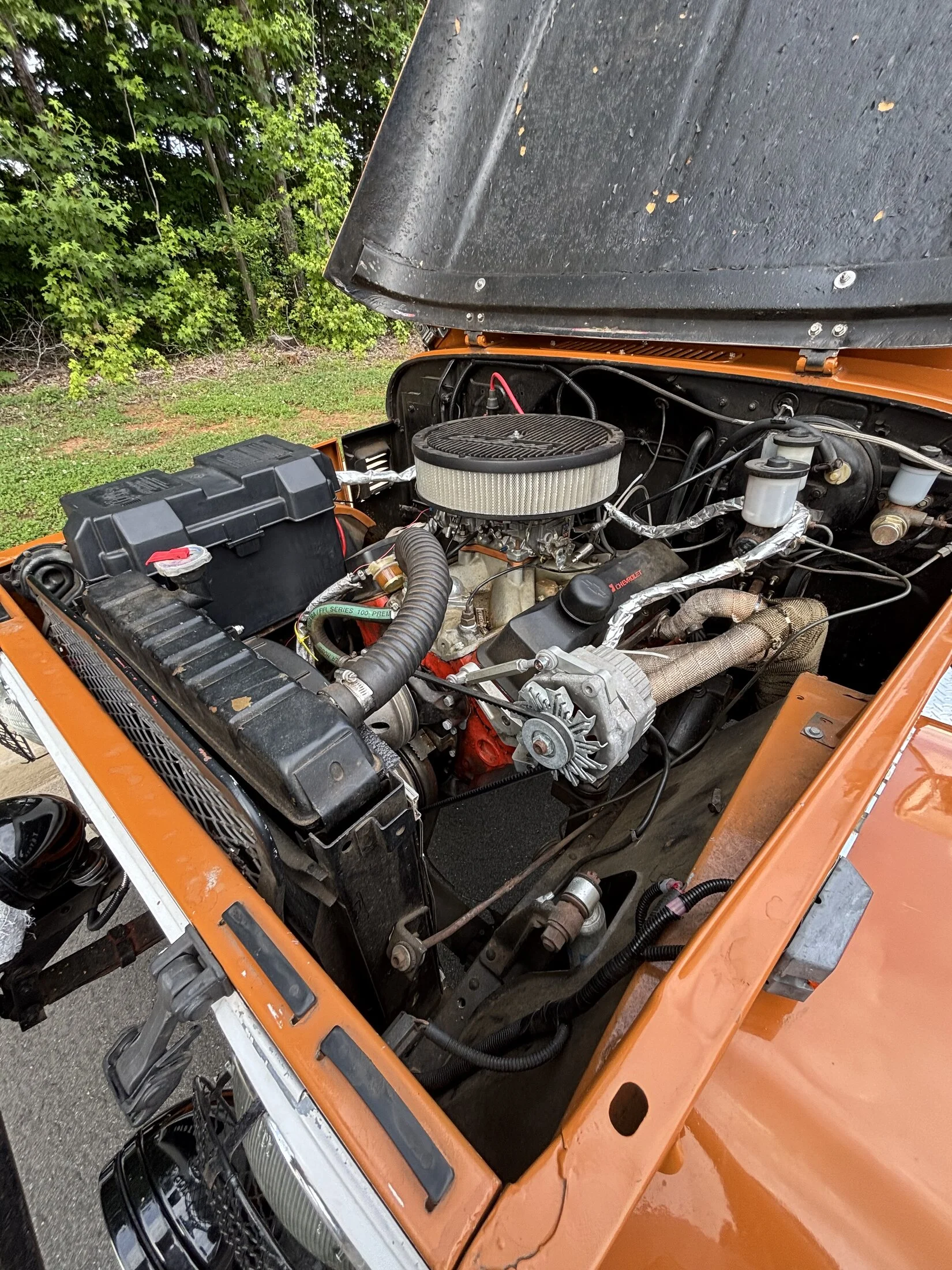

I postyed some engine pics...just because.......Thanks as always

If it cranks it's turning over. Have you done any diagnosing when this happens? If not next time see if you have spark at the plugs. Take the air cleaner off and see if the carb squirts gas when you turn the throttle by hand.
Very first thing I’d do is get that plastic fuel filter off the intake manifold.

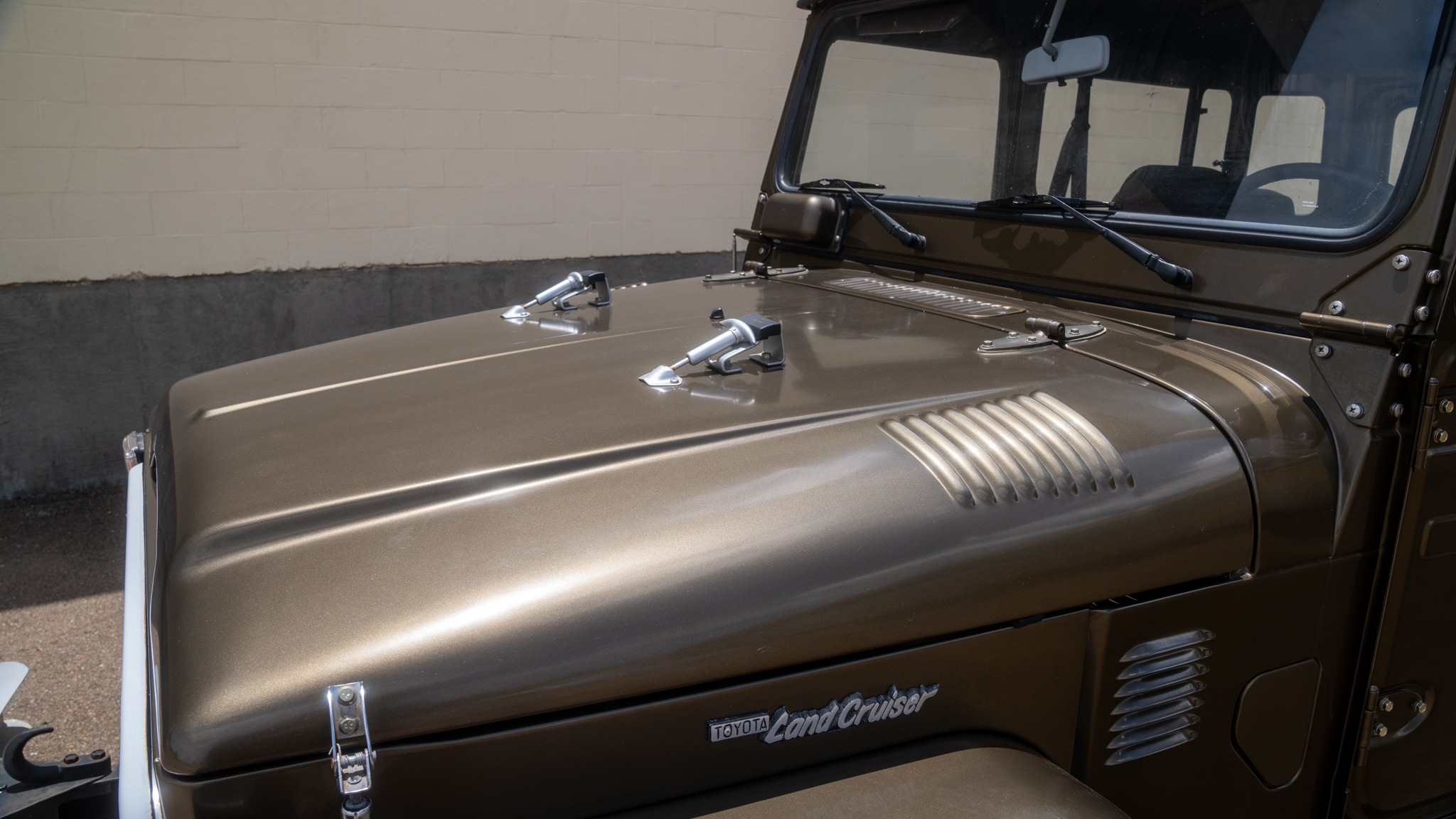

I dont think I've seen an FJ with louvers...is that standard? Mine's a Frankenstein.
The fjs don't have them, it's a 40series thing....they all came with them.
Vapor lock is my vote. T in the fuel line at the carb. Cable or electric solenoid valve on a return to tank hose. I would also put in a electric fuel pump in the supply hose to push the fuel for like 10 seconds before you turn the key to start it up. E fuel pump could be on a momentary switch for prime.

It appears to be a stock style filter for an FJ60 (later 40?) that would mount down near the frame. It is currently resting right on the intake and could melt (less likely), but most likely to get very brittle from heat, then spew gas all over and you’ll have a different heat related problem.
I’d plumb in a metal inline filter and get it mounted with at least an inch all around it from intake/head. The exhaust may not allow the filter in the standard location on the frame. I’m not a big fan of clear plastic or especially glass filters on top of an engine.
For the initial question. Like said, do some diagnostics. If no fuel when you move the linkage: vapor lock issue.
If no or weak spark: coil may be getting too hot.
