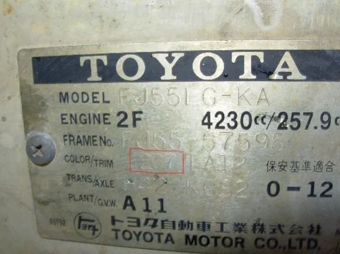

Color
Found this...
vin does not decode to show paint codes or really anything of any importance, just model and number in line. later models will have another plate that will have the trim code.
But haven't found this...
(if it has it on the drivers fenderwell)

So question is, if there's no identifier on the DS inner fender well denoting color, would it be sacrilege or jeopardize my chances of a fair entry to paint another model year specific color/color combo?
If so, what color code might she have been?
That's where I have. It's this color:
^^.Only pic I have, but several places^^.
And I think this would be the closest OE color, based on what I've found in various places beneath the bondo.
Which is a gold color.
Going to try to find the fender tag tomorrow. If it doesn't exist, may paint a color other than gold. Hate to, but if there's no way to ever tell, then may opt for another OE combo, specific to production date.
If there's a tag, then will paint whatever tag says, for accuracy and love it, just the same.
I can't find any info on the gold anywhere.
pighead says you're not going to find a color code on a '72. And I don't trust that color guide much.

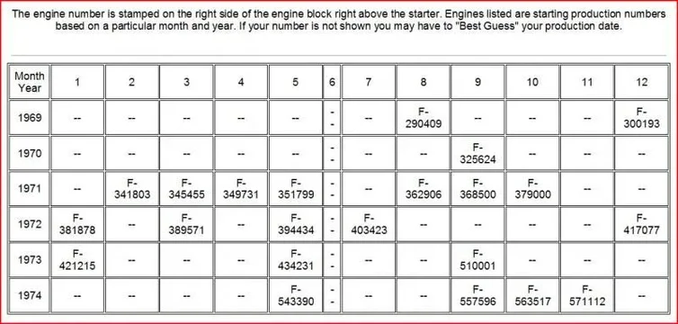

SOR's links aren't working, but found this elsewhere on the web:

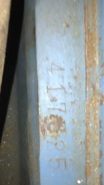

Oddly, mine doesn't fit into the chart, anywhere.
Few questions:
Does this indicate a swapped F?
If that's the case, is it foolish to rebuild this F?
Foolish to find a correct F and rebuild?
Foolish to not consider a 2F?

That chart is sweet (if correct). Not sure what to make of your number...
AFAIK, Mustard was never a color combo on Pigs.
Now can't find the link to page, but pretty sure that chart was listed in an image link to coolfj40.com.
This is SOR's, I believe, but the links on Mud and website are dead.
Not sure what to think on color, since I have seen a few that are the "mustard", but if there no indication on any tag, then I'll opt for a different OE color, unless this is a million dollar find. Haha.
This blows my theory that the blue block was an indicator of rebuild by a long ago defunct equipment company to pieces.

After being taught how to read a chart here
, in all likelihood this is the original F, so hoping to maintain.

Engine number looks the between 12/'72 & 1/'73?
Assuming it's been married for life, based on the chart, so guess she's a keeper. Been there this long.
