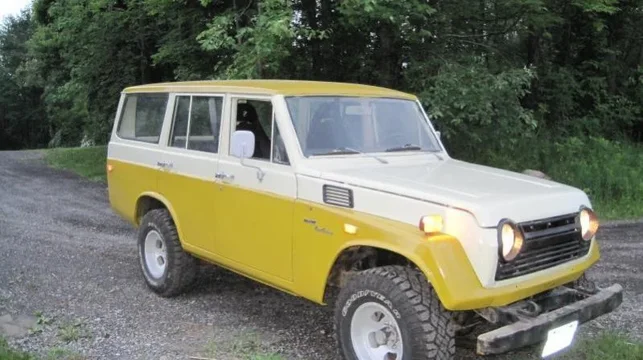

I'm fairly certain this what's under the bondo and crap paint job that's on it.
Saw a thread where Ige started peeling off paint and underneath the OE paint was still plainly visible, which I think this will be too.
They didn't primer. They slathered on some bondo and painted.

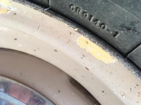

This morning, noticed this on wheels after scraping paint, a bit
Further investigation into produced
In the tub bottom. Not sure what that means, as far as original paint, or what, but the purpose if post.

Was on one of the Cruiser sites and saw that OEs replacements are gray, and thought it looked decent enough to run.
Going to blast these and hit with Duplicolor or another other wheel worthy, but removable finish in similar gray, and run what I've got.

Two tone she'll be, but complete disregard to Mustard, unless this is one of kind and documentable.
