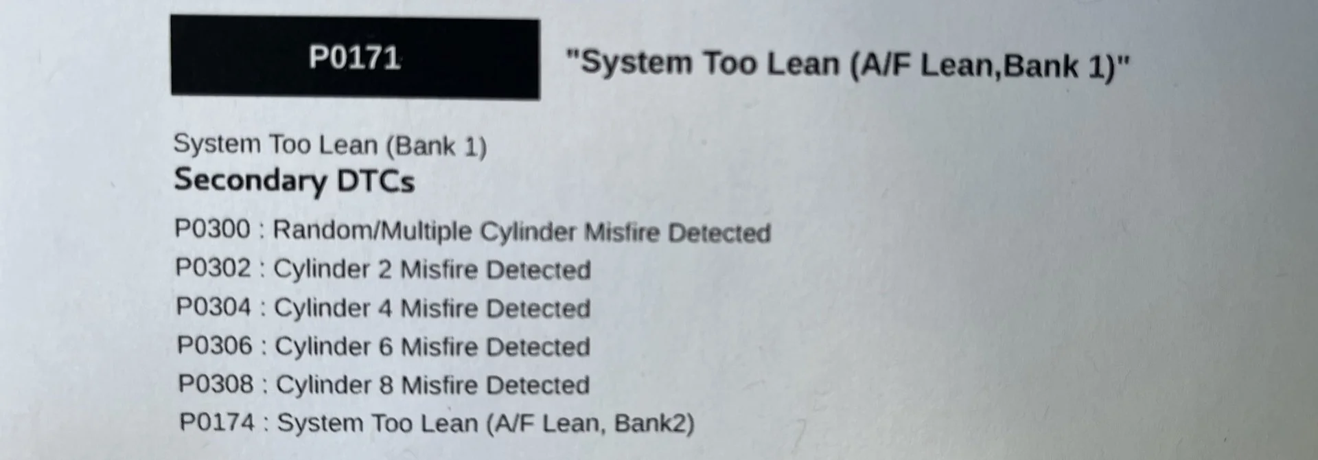

In Cody, WY I had the codes read and cleared:

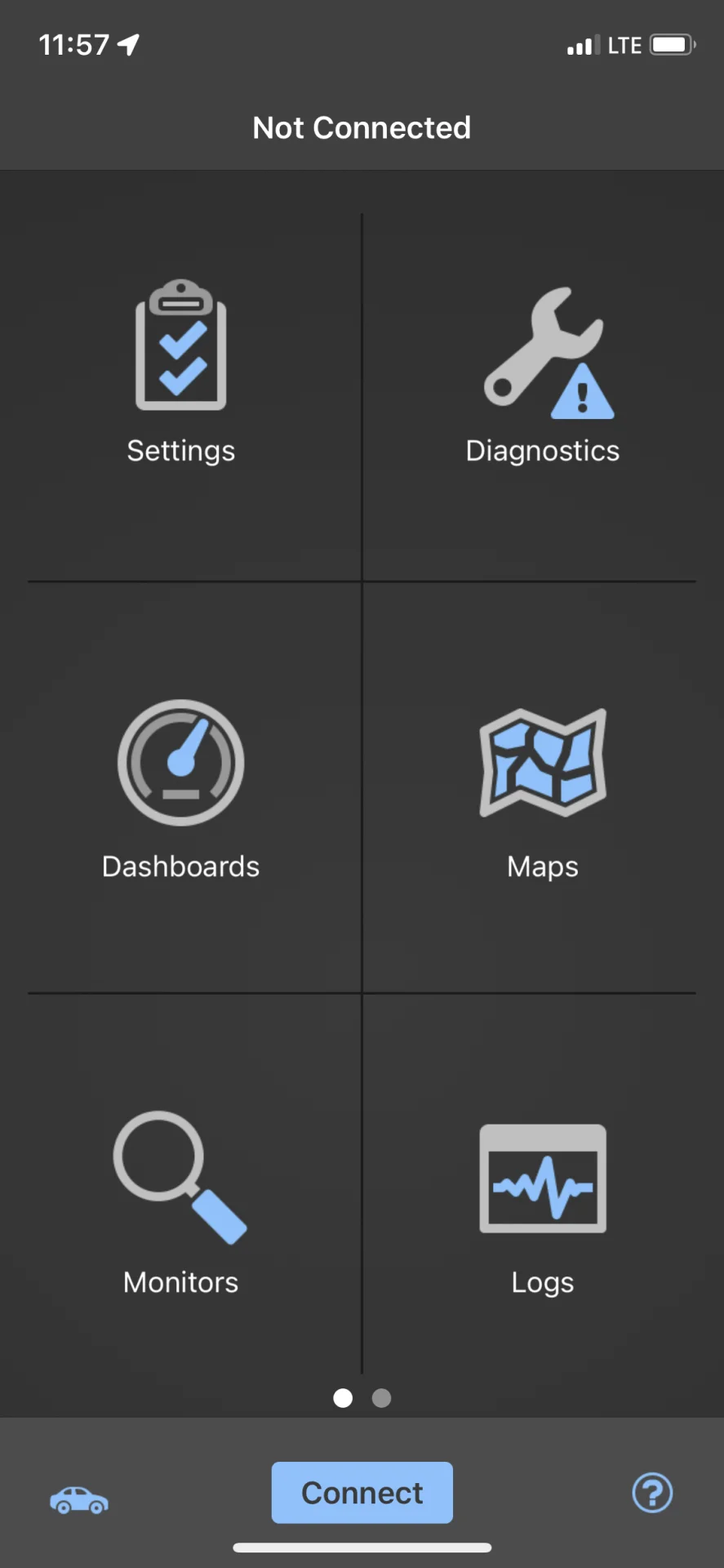

Can anyone recommend a Bluetooth OBD2 reader?

I have the CEL still on with the P0420 P0430 CAT codes. The exhaust shop here says the fuel additives are clogging up the CATs

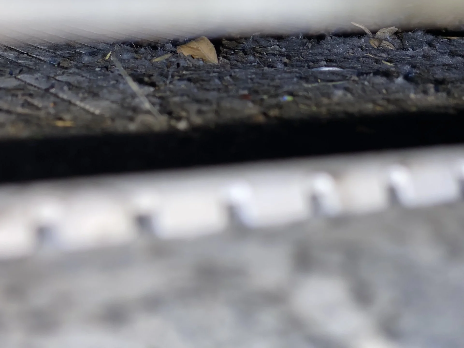

Looking up form under and between radiators. Muck is covering it's fins. It will take many washing just to get 70% clean.

I've used a BlueDriver for years. It has a close operating system, so locked to their software. Works well and I trust in code reading, although will not pick up everything as a miniVCI hooked into tech-stream will.

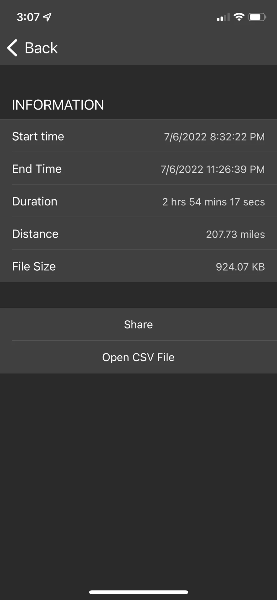

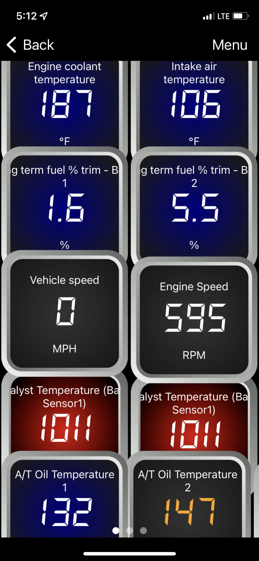

Just bought an OBDIIMX+. Now I can use many app to drive it. I can now see A/T temps and AHC Mpa and more. I'm liking it!
Both allow logging of data. Which I really like. Than I go back back and look at data over all time I choose to have scanner running.
Random screen shots of OMDIIMX+ running on iphone

Misfire codes on all cylinders on 1 bank actually points to clogged, partially clogged or failing cat - or some other restriction/issue between the header and the cat outlet causing the engine to over-fuel on that bank.
With TS or your obd tool reference and compare the O2 sensor data from left and right banks. Record data and report back. A back pressure test can also reveal clogged cat.

Is actual ECT & Fuel trims while driving? CAT, A/T and IAT temps would be a great to have driving logs of also.

Codes were read then cleared two days ago and the lights came right back. Yesterday the dash lights cleared themselves and I haven’t seen them since. I’d say it’s running at about 85-90% of normal at the moment.
I still stick with don't make assumptions. Go through each step as required. Simplest solutions first that follow basic ecu diagnostics Coil, injectors, plugs then go deeper.
Assuming an entire bank wouldn't go bad all at once; But what if they did? We must make order out of chaos. We must make order through systematic, organized thinking starting with the simplest most basic fundamentals. I'll be watching and hoping you find the solution.
Very unlikely coils or plugs all failing on one bank.

I did remove the intake tube to inspect and clean. While the MAF sensor obviously was dirty (tip in immediately improved after cleaning) the rest of the tube and throttle body wasn’t bad at all. The OEM filter was doing its job and keeping the clean side clean.
