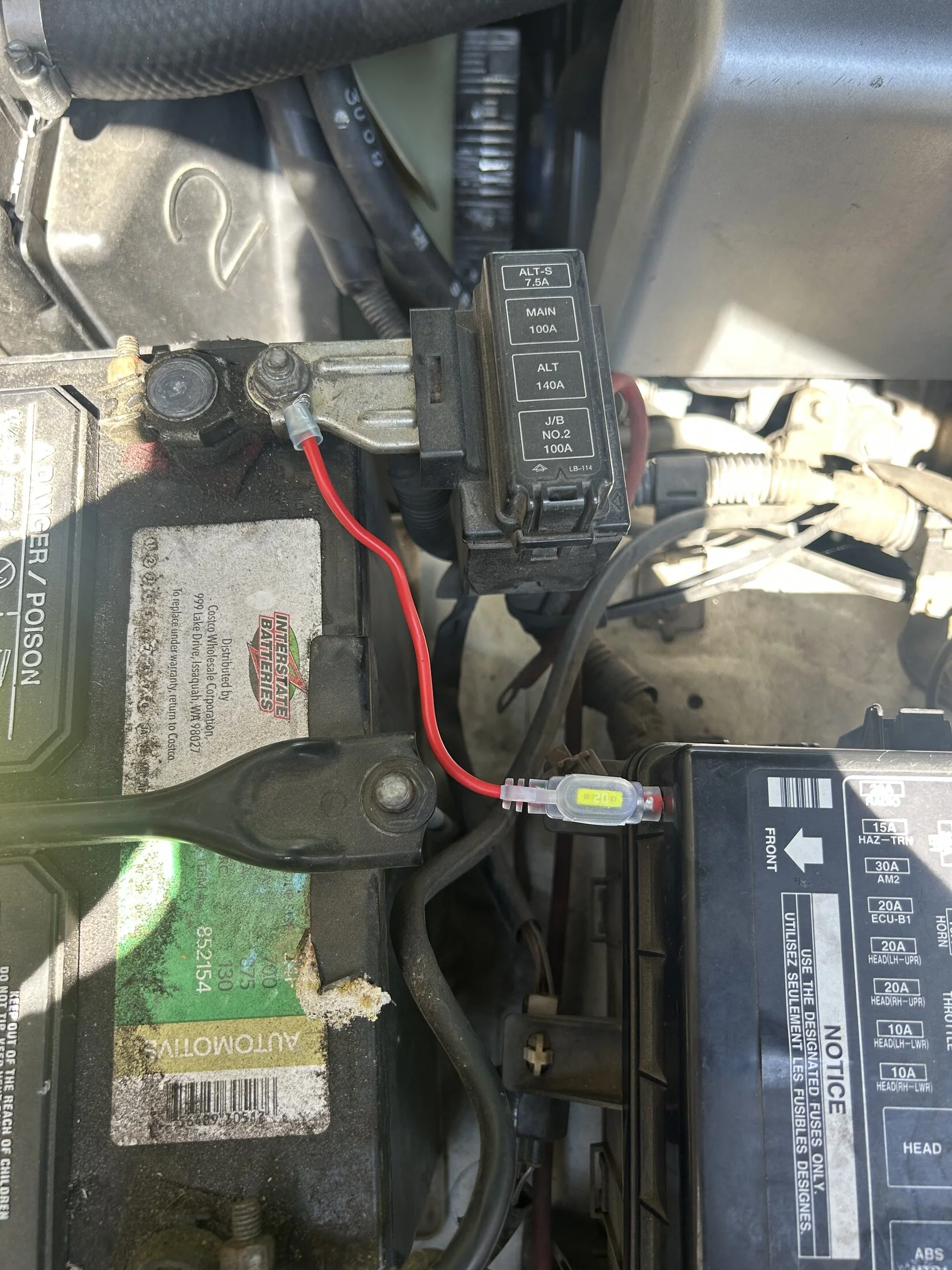

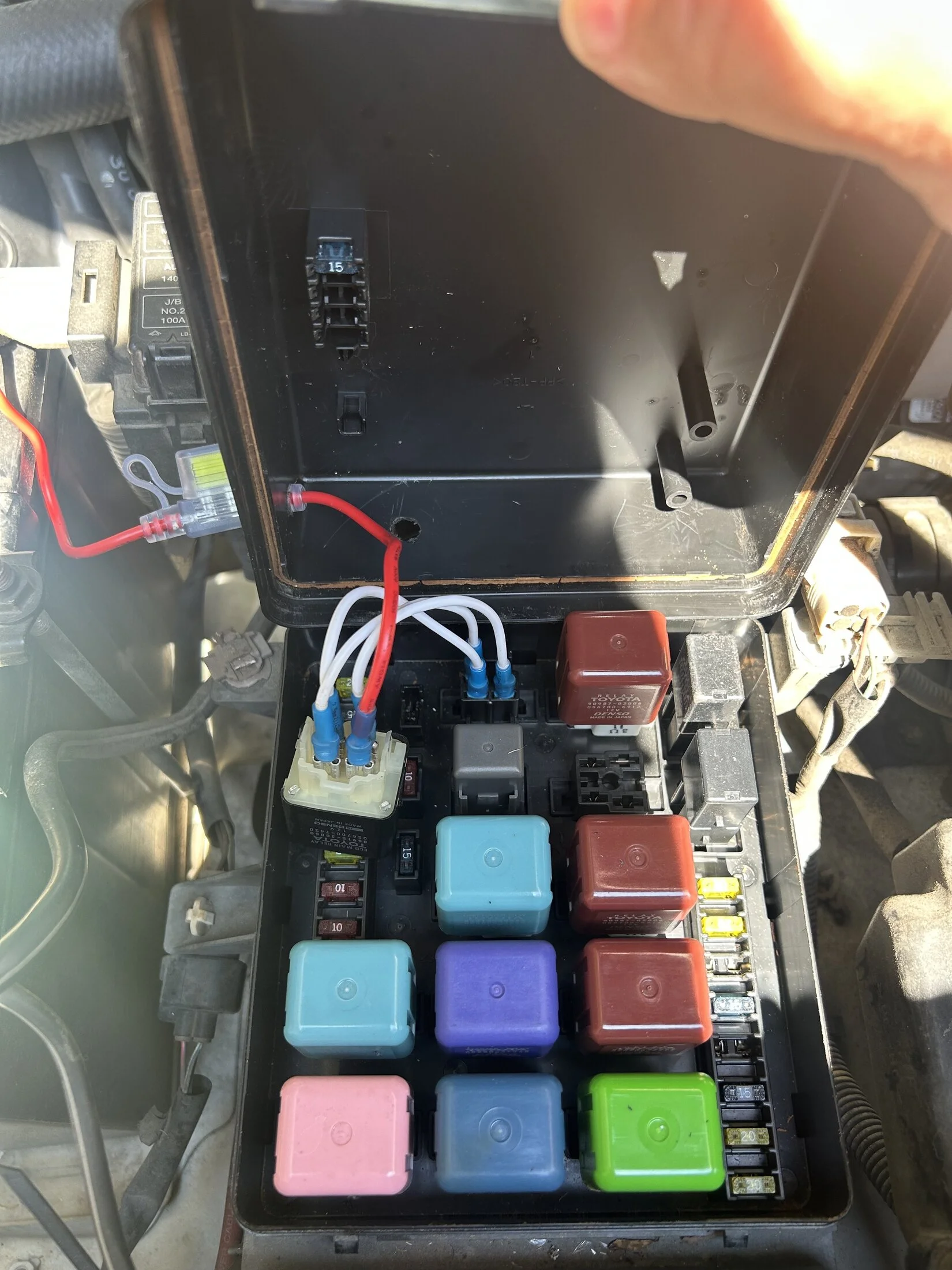

Well, the new pump and a new fuse and some dielectric grease got the Cruiser through a road trip to WV and back and then the fuse terminals gave up the ghost. Huge thanks to @medtro for his fix! I'm posting pictures so you can see the difference for coming off the battery instead of the fuse.
